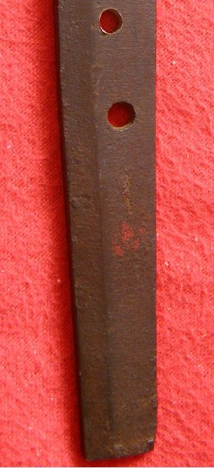

Here's the tang of a katana of mine and it shows traces of what must have been a shumei. I would guess that it's older than late edo or meiji....?
Best regards
Peter
