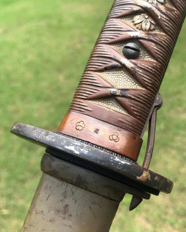

knd643 Posted November 24, 2022 Report Posted November 24, 2022 Hi guys. Pretty new to Japanese Sword collecting and I'm looking to possibly pick up my first one. I was wondering what your guys opinions are on this sword. From what I've read on this forum and on other sites the markings seem to be correct(I think), orientation of the serial number on the blade looks to be correct for the manufacturer, the bohi doesn't have a huge gap from where the brass is on the blade(don't know the correct name of the brass). But there are tons of other variables that I don't know about yet and was hoping you guys could possibly help. From the information I have received it is a Tokyo production mid-war example. The seller informed me that the serial number on the scabbard matches the blade and that he's going to get a pic of it. Another question I have is is the Flower marking with the line in the middle on the Fuchi known yet? From what I've read it is still unknown. Thank you for any help you guys can give. Quote
vajo Posted November 24, 2022 Report Posted November 24, 2022 Its a legit one. Nice sword. The only thing is that someone rubbed the niage patination from the fuchi to see the stamps. 1 1 Quote
Bruce Pennington Posted November 24, 2022 Report Posted November 24, 2022 You are right about the “Ichi” stamp. It is not known which shop used that logo. Guys have proposed that it was the Kobe Shoten Co. which is associated with the “K” in sakura. The serial numbers of the two logo stamps lineup, and suggest there was a logo change at some time. I personally think they are right about it. 1 1 Quote

knd643 Posted November 26, 2022 Author Report Posted November 26, 2022 Thanks guys for all the quick replies. Hoping to pick this one up. Quote
