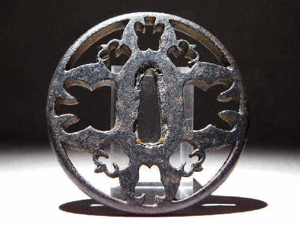

Difficult to see under all that dirt. I don't think it belongs with the rest of the military koshirae, [some of the sword people will correct me if I am wrong] do you have any provenance on it?  Tentative idea is that it is 'Akasaka' or  Heianjo-sukashi?  Kaku-gata sukashi. [square shape pierced]  [If I am way off I am sure I will be told and am very use to it! :laughing:]
Is it possible to get a larger image?
Some text from the Ashmolean Museum collection.
"The earlier Akasaka guards closely resemble the pierced work of the Heianjō and Owari workers. Later productions display a number of striking features, such as clean-cut fret-piercing in positive silhouette of designs leaving little of the iron in reserve, the addition of a slight engraving finish, a rounded or rather tapered edge to the guard, and, in some of the more recent specimens, the semi-circular enlargement of each end of the tang-hole, as if to take a plug (not supplied) of abnormal size. Enrichments of other metals are entirely absent."

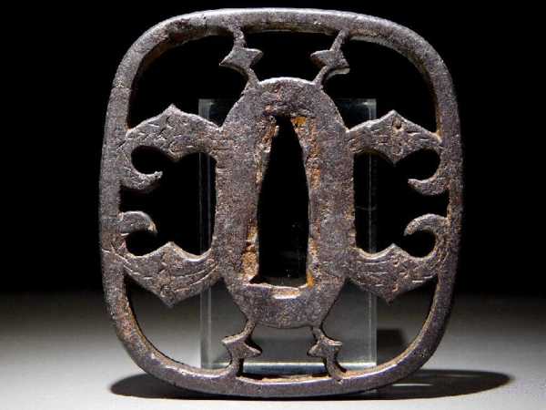

This one is not as detailed as yours but shows similar traits. https://www.ebay.com.au/itm/403442365331  small birds and myoga [ginger plant]. The one you have looks like it has some remnants of gold nunome on the flower heads. I am surprised that other people with more experience have not commented? I am not a student of sukashi guards.
A Maru Akasaka with same elements - https://www.ebay.com.au/itm/294587055864 It doesn't give the thickness of the guard but it looks relatively chunky? 6-7 mm?

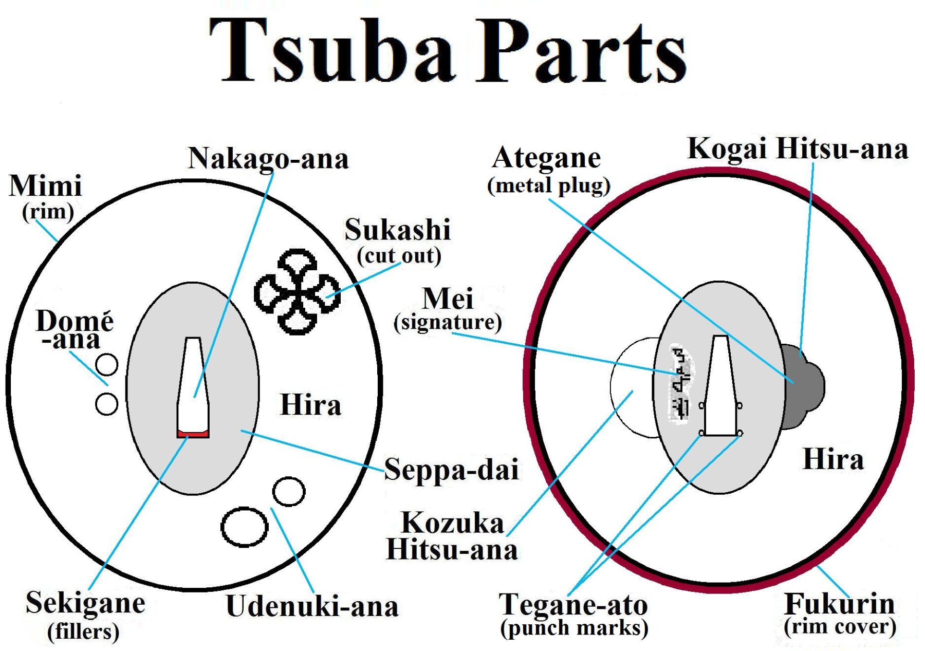

The "chipping" is the result of a chisel or punch used to tighten the sides of the tsuba to grip the tang of the sword tight so it won't wobble when mounted. The 'chips' are called tagane-ato  [sometimes other names]- they can sometimes be a very important element pointing to particular schools and smiths almost like a signature in some cases. Often found with copper inserts at the top and/or bottom of the tang hole [nakago-ana] they are called sekigane.  The orientation of the tsuba would usually be with the punch marks toward the handle side and this is the most decorated side of tsuba in most cases, pointing out to the observer, Sukashi don't really have a more decorated side as a rule.

Here is a good website for tsuba terminology.
https://tosogucollection.wordpress.com/2013/05/16/787/
