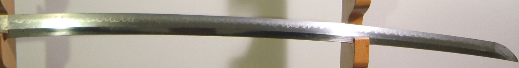

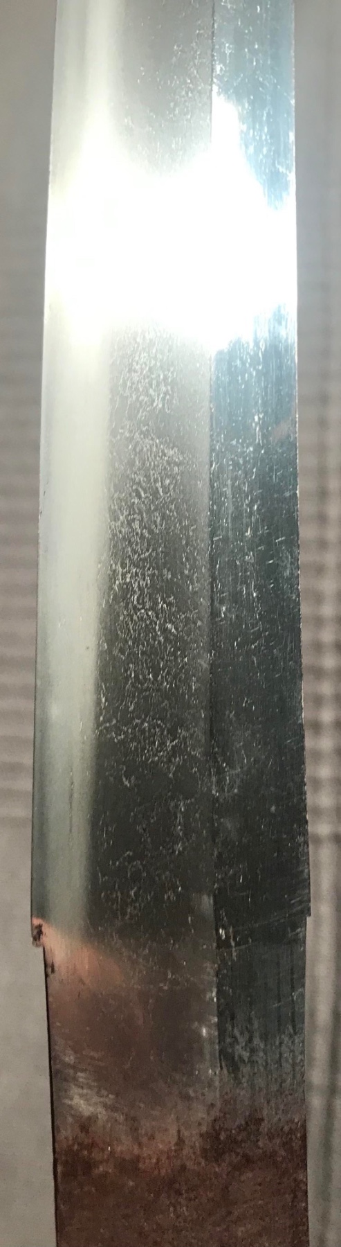

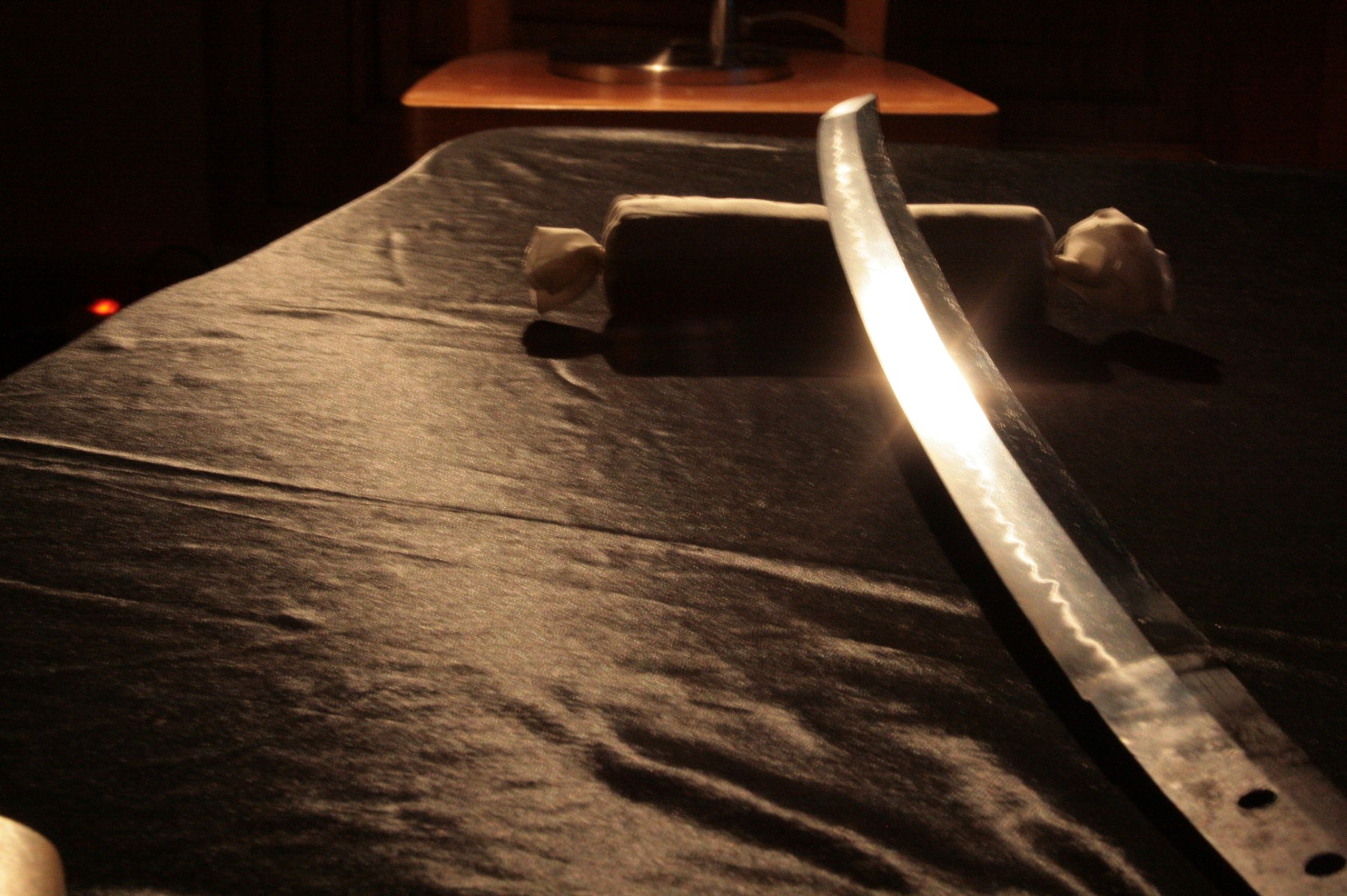

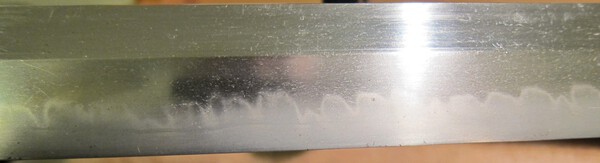

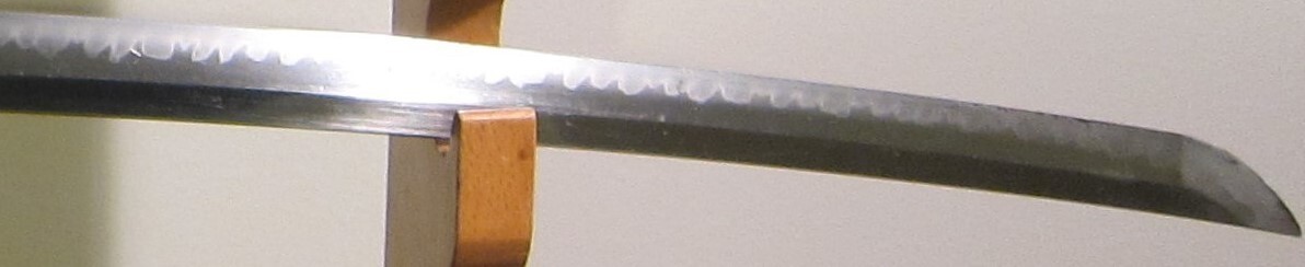

Utopianarian Posted November 22, 2022 Report Posted November 22, 2022 Practicing lighting trying to get better at pics. Focusing on hamon. Maybe phone just isn’t cutting it. Might look into actual higher end camera which is better suited. My pics haven’t improved much. I wished I loaded the pics Darcy took of some of those world class blades before the site was removed off web. Darcy was a master of focusing on the features a school was known for and squeezing out every bit of that rendering amazing images. Anyways here are a few laughable novice pics to look at in case you are bored. 2 Quote
David Flynn Posted November 22, 2022 Report Posted November 22, 2022 We really need to see the whole Hamon for context. However, a quick guess, Juka Choji. Quote
Jacques Posted November 22, 2022 Report Posted November 22, 2022 I only see hadori, not the real nioiguchi . 4 Quote
Utopianarian Posted November 22, 2022 Author Report Posted November 22, 2022 It’s a mystery sword Jacques. It’s a work of abstract art in progress literally. Lol…You can’t see the nie. You can’t see the utsuri. You can’t see the nioiguchi. Damn, if it didn’t have hadori on it you wouldn’t know it was there..😳 1 Quote

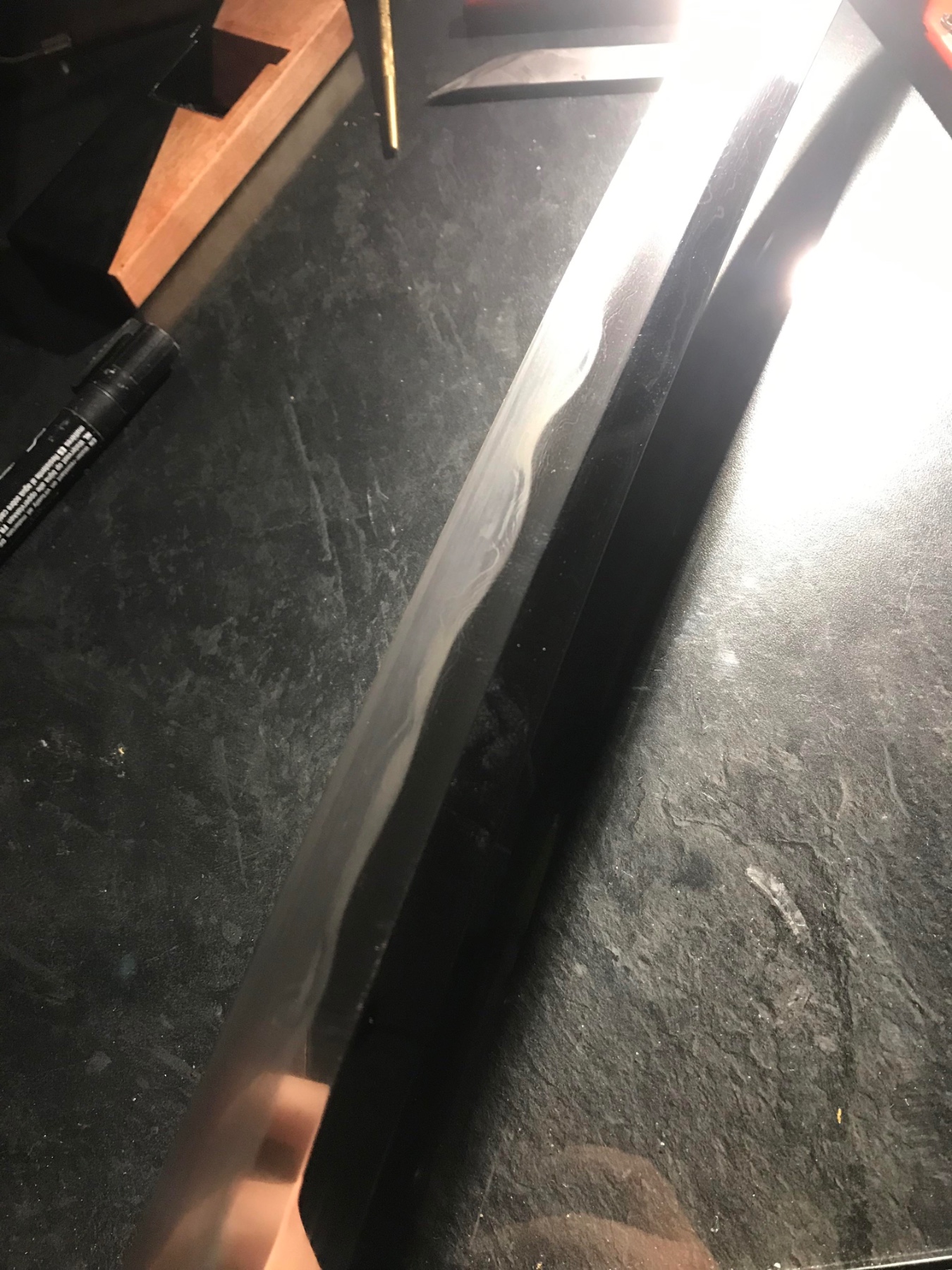

DoTanuki yokai Posted November 23, 2022 Report Posted November 23, 2022 I would recommend making pictures of blades in the same angles you would watch its features in Hand. Can’t see anything on this but in the right angle even with my old IPhone 8 I can see the Hamon. But with better equipment there are more possibilities with a strong light source and a camera but it is much experience needed. An example where only the Hadori is visible. And then with a strong light source and my 10 years old Sony Alpha camera. Closed shutter and long lightning time. (I hope I use the right words because my camera skills are only in German ) I have made more then 10000 of blade pictures and I think there is still much to improve. This examples are just what I have on my phone right now and not the best but I hope this helps. Edit: here are some more of my early pictures at the end of the thread and here are some more recent with the same equipment but more experience I’m struggling with the boshi :/ Quote
PNSSHOGUN Posted November 23, 2022 Report Posted November 23, 2022 Light source, angle, shutter speed and ISO settings are the key. If you can juggle these you can get 'OK' results even with a phone camera - DSLR is best. 5 Quote
Utopianarian Posted November 23, 2022 Author Report Posted November 23, 2022 Thank you Christian and John. I will try your recommendations Quote

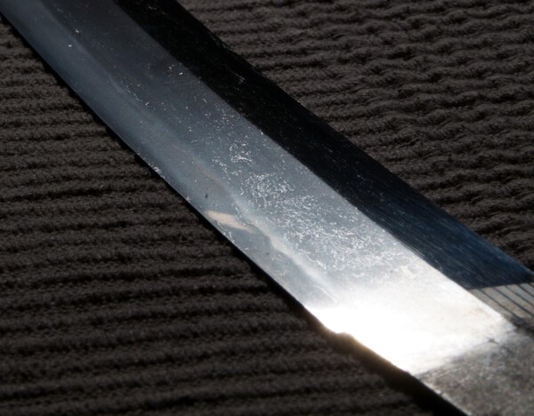

francois2605 Posted November 23, 2022 Report Posted November 23, 2022 For me, the key to take good pictures of a sword is to avoid any direct source of light and rely on the ambiant light (to prevent reflections). You'll be able to see things you can't see with your own eyes. Those are pictures I shot with a tripod and a macro (100 mm) lens. Ikkansai Shigemasa Minamoto Moritaka Fujiwara Kanefusa 25th Tsukamoto Okimasa 3 1 1 1 Quote

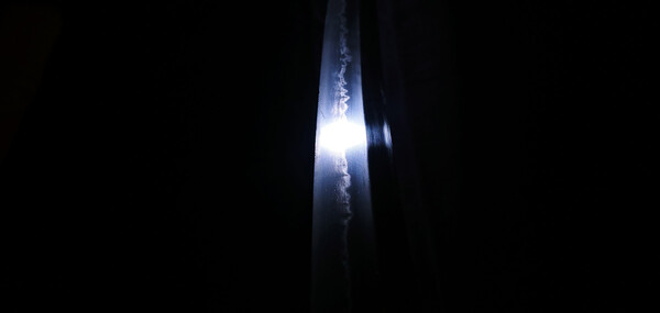

C0D Posted November 25, 2022 Report Posted November 25, 2022 You need to take pics in different angles and different source of light in order to capture most of the features of a sword, some example of pics i took on a modern made tachi 6 Quote

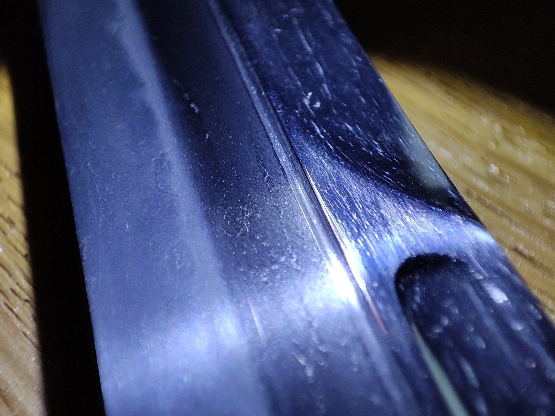

Utopianarian Posted November 28, 2022 Author Report Posted November 28, 2022 Somewhat better pic of nioiguchi. A lot of beautiful pics posted by you guys. Some nice blades especially the Masakuni Gendaito which I can say I’ve never seen a Gendaito like that before either looking like an old masterwork. 5 Quote

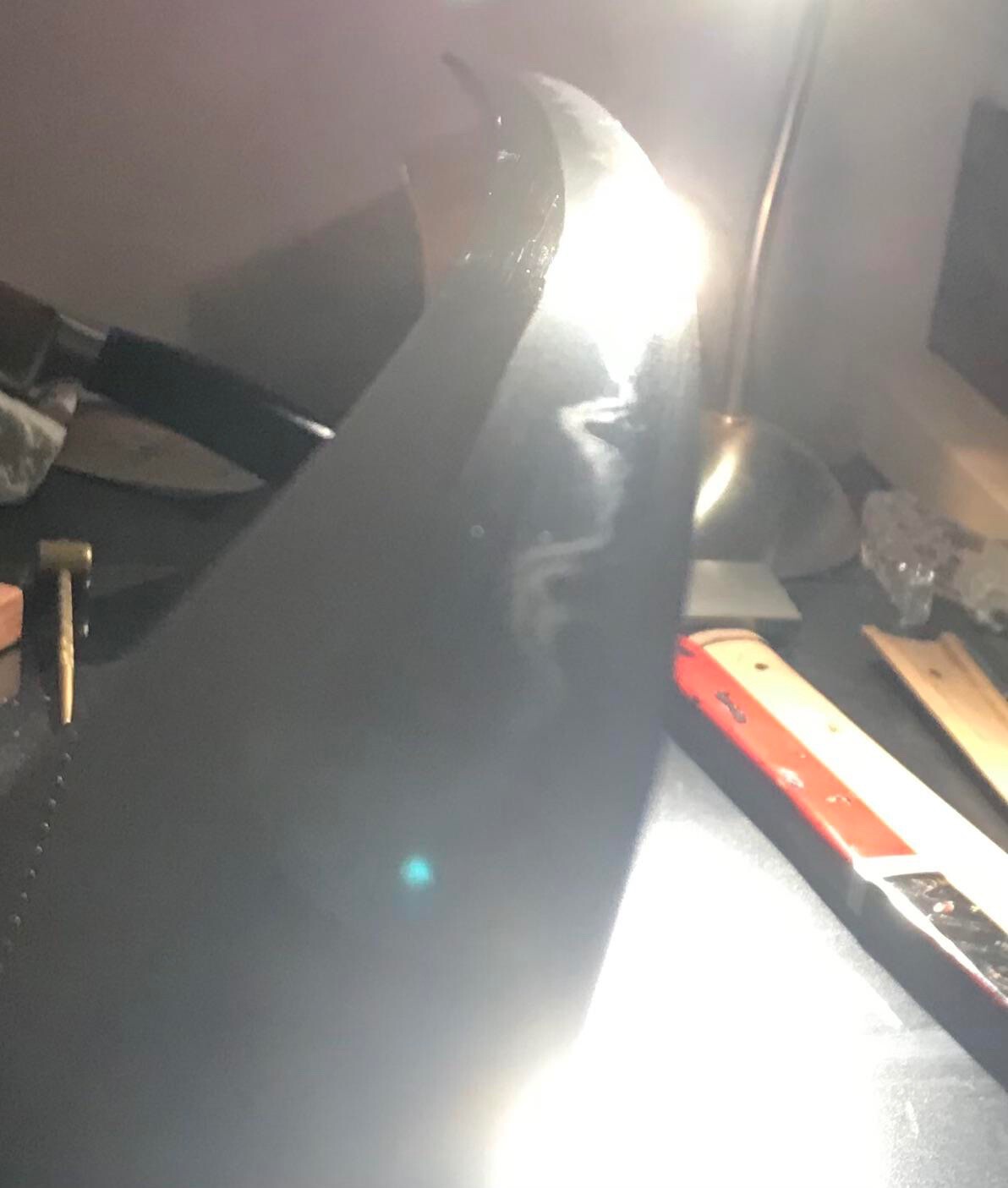

Nicolas Maestre Posted December 4, 2022 Report Posted December 4, 2022 Great pics here 😍. Here is my modest contribution to this thread! First time I'm trying to focus on the hamon. I was using the macro lens of my phone. Don't know if there is a lot to see though, as it's not a quality blade... Here I think I managed to get the nioiguchi quite distinctly: Last one, I like it a lot but I'm not knowledgeable enough yet to understand what I see (provided that there is something to see at all 😁): 1 Quote
