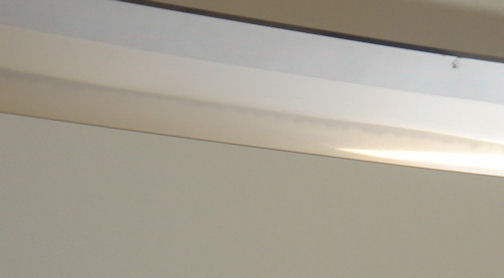

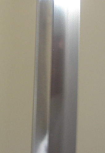

I would like to get to the bottom of this, and just so "Jack" can see this thread I hope that others can look at the photos at the following link and confirm that the sword is indeed a genuine Emura, and not a Shinto era blade. I mean, you can see through the rust on the nakago fresh yasurimei and near the top of the nakago you can see perfect fresh silver yasurimei without any rust at all!

The nakago looks to have been cleaned at one time, and the choji with ashi is much larger than what most Emura den did..(see file)....and sometimes so tight it looks suguba....id have to have it in hand to make the call on shinto, no really good pix of the boshi, which would help, and if the hada is a lazy swirl that looks wet it might be his work....pix dont let me think so.
