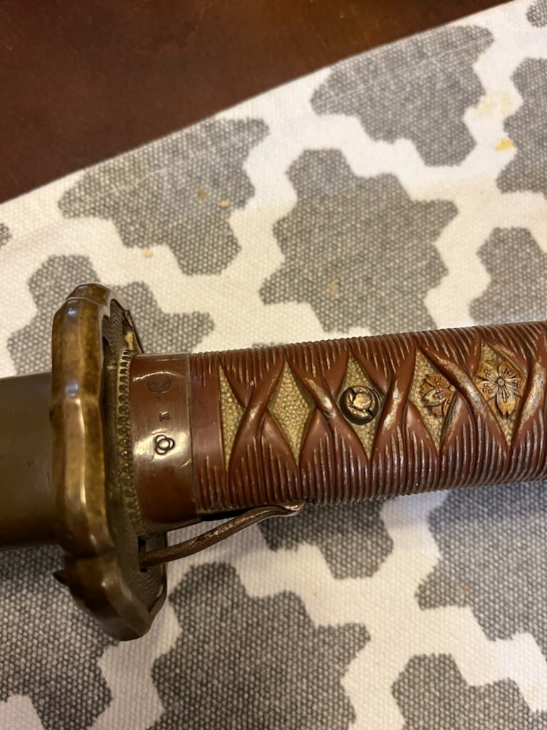

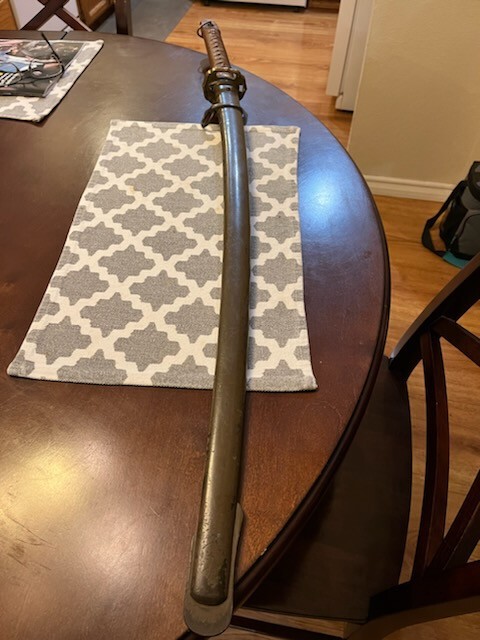

flightlessgreeb Posted November 21, 2022 Author Report Posted November 21, 2022 As promised! Picked up the sword yesterday, took some pics this afternoon in the setting sun. Some of them didn't come out with great detail - let me know if there are any additional shots I should try to take or retake. It appears to be Kokura Arsenal if I know my Arisaka stamps anyway - not sure about the other markings. At least with rifles I know it's very difficult to nail down a year of manufacture - would anyone care to hazard a guess in this case? gallery: https://imgur.com/a/zdMwRz2 1 1 Quote
Michaelr Posted November 21, 2022 Report Posted November 21, 2022 Kay, the pictures look great. Congratulations. I am glad that you, with the excellent advice of the forum members, decided to go through with the purchase. You have a very nice sword there. You made a good choice and have one to be proud of. MikeR 1 Quote
Bruce Pennington Posted November 21, 2022 Report Posted November 21, 2022 Kay, Stegel described the details above, but didn't specifically point out each stamp. You have the arrangement depicted a item 3 on this chart from Ohmura's excellent webpage HERE. Iijima contractor - Tokyo 1st Arsenal inspector - Kokura Arsenal 2 Quote
