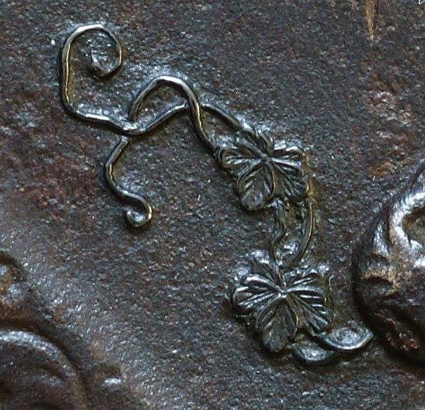

Fair warning - this tsuba may not be considered by some to be representative of its school as its quite an early example.
Tetsu ground, Tetsu Inlay with high relief carving. Fine shakudo inlay.
The lighter areas on the tree trunk are loss of patination (wear and tear from a hand gripping the tsuka in a formal pose?)
Katana Size
Length : 88 mm, Width : 80.2 mm, Thickness at seppadai : 4.4 mm
There is an 18 kanji mei ; artists name and honorifics, season and year, as well as geographical place.
Hozon papered, purchased from a well respected Japanese dealer.
The mei has been brushed out, all will be revealed in due course.
Any thoughts?

I have to suggest the Umetada group. This was my first, gut response....and judging from the feedback from Steve I'm a little more confident.
Second or third master, certainly not shodai.

I was thinking more of Umetada Shigenari. he did a bit in steel...and the Umetada of course are noted for their use of soft metal. The plum blossoms are particularly convincing to me.
To be honest though, I can see the other offerings validity too....hmm :dunno:

I edited the images late yesterday and added a new post at the same time. The photo's took but the subsequent post did not? hmm.
No matter here we go.
I guess that the last nudge was a little too much!
Kudo's to John L & Ford for seeing the Shoami and Umetada influence.
As stated at the start of this thread it's not we we usually see in Akao work.
The NTBHK Hozn papers describe the piece thus ;
松梅図鐔 Matsu ni ume Tsuba Pine tree and Japanese plum Tsuba
銘 Mei
七郎左エ門吉房作 Shichiro Saemon Yoshifusa Saku
万治己亥春於島原 Manji tsuchinoto-i haru oite S(h)imabara - Spring 1659 at S(h)imadara
撫木瓜形 Nade Mokkô Gata Lobed shape on an oval base
鉄槌目地 Tetsu tsuchime-ji Iron hammered surface
鋤出高彫 Sukidashi takabori High Relief Carving
土手耳 Dote-mimi A rounded raised rim
耡下毛彫 Sukisage KeBori Line carving of consistent depth and width
両櫃孔 ryo-hitsuana double hitsuana
赤銅埋 Shakudô ume Shakudo Plugs
