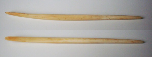

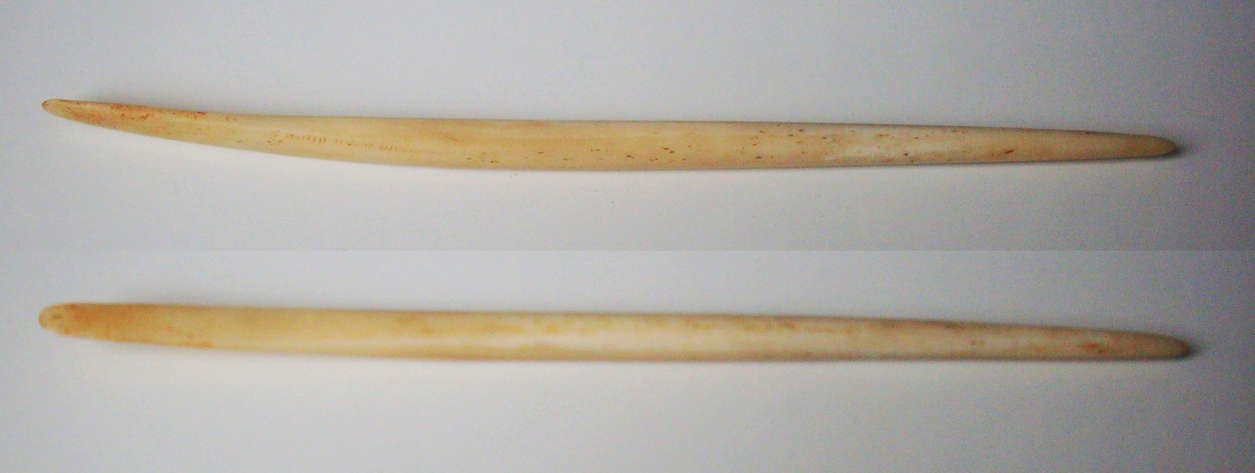

Removing rust is done with a pointed piece of antler, bone, or ivory. You don't use a horn, in this context "horn" is just the material.
If you don't have a source for antler pieces, I can send you some for free.
