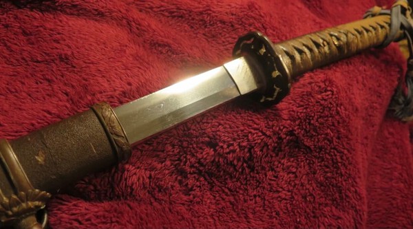

Swords Posted November 2, 2022 Report Share Posted November 2, 2022 Hi Can I get help with the signature I believe it’s correct or hav any issues Thanks Link to comment Share on other sites More sharing options...
Bruce Pennington Posted November 2, 2022 Report Share Posted November 2, 2022 That nakago sure seems long! Is the gunto extra long, too? Link to comment Share on other sites More sharing options...
Swords Posted November 2, 2022 Author Report Share Posted November 2, 2022 I will check Here is a better picture Nagasa/ Blade length: 68 cm Overall length in scabbard: 101.5 cm Link to comment Share on other sites More sharing options...

Swords Posted November 2, 2022 Author Report Share Posted November 2, 2022 Hi hate to hav to post this but need help since Im thinking of buying I’ve been looking for a older sighted sword but don’t want to make a 2000 mistake ! I need help with the age I think it’s a Shinto late Koto 26.772 inch blade Is the signature is ok and condition of blade description Nagasa/ Blade length: 68 cm Overall length in scabbard: 101.5 cm Koshirae/Fittings high quality, with original tassle. Lacquer on wood scabbard. Has silver mon.I believe it’s Blade: Reasonable polish, lots of activity, very very nice (albeit hard to photograph). The blade has bee well cared on has a scent of choji oil. No nicks, some areas of fade to polish. In hand the sword is very nice. The only blemish is that previously, Surely when fitted out with Gunto koshirae, the habaki was moved up a short distance, with the Nagasa being slightly shortened and under the habaki are marks. 1 Link to comment Share on other sites More sharing options...

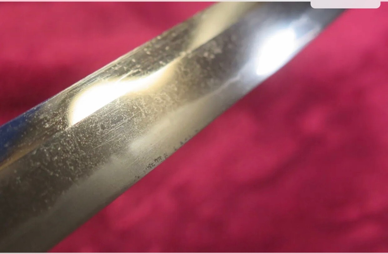

ROKUJURO Posted November 2, 2022 Report Share Posted November 2, 2022 Steve, I am afraid the description tells nothing of value, and the photos are not helpful. No NAKAGO pictures with a signature. It seems to be a relatively straight blade (as found in KANBUN era). Mounting is military WWII so no connection to the SAMURAI era. What is it that you like? Link to comment Share on other sites More sharing options...

Grey Doffin Posted November 2, 2022 Report Share Posted November 2, 2022 Hi Steve, If all the pictures in this post are of the same blade (hard to tell for certain) the signature is Hizen no Kuni no Junin Tadayoshi Saku. This is a very big name and forged signatures are common. If it is a true main-line Hizen-to I'd expect it to be priced much higher than $2K (if sold by a knowledgeable seller). The hada doesn't look to be typical for the school and the sugata may be wrong (looks to be a typical shape for Kanbun era but the Hizen smiths often, if not usually, worked with a stronger sori. Not saying this is gimei; just that you need to be careful (coming here before purchase was smart). Other guys might have a different take on the sword; I'm often wrong. If you are a beginner you need to work with a seller you can trust. Grey 1 1 Link to comment Share on other sites More sharing options...

Jacques D. Posted November 2, 2022 Report Share Posted November 2, 2022 Steve, Sorry but it's totally gimei. Link to comment Share on other sites More sharing options...

b.hennick Posted November 2, 2022 Report Share Posted November 2, 2022 (edited) Yes! It is gimei. You can not find a good Hizento for that price. Edited November 3, 2022 by b.hennick to remove uncertainty Link to comment Share on other sites More sharing options...

PNSSHOGUN Posted November 2, 2022 Report Share Posted November 2, 2022 Hi Steve, one of the nicer swords you have posted despite being gimei. The mounts are of good quality and the blade is in original old polish. 1 Link to comment Share on other sites More sharing options...

ROKUJURO Posted November 3, 2022 Report Share Posted November 3, 2022 The question should be: Did you get a good sword for $ 2.000.--? If you consider that a decent polish will cost you at least $ 2.500.-- plus SHIRA-SAYA plus HABAKI plus shipping plus the agent's handling, you are at about $ 5.000.-- minimum, but there is no chance to get it papered. It's not 'gimme', it is GI-MEI. In a resale you will not get your money back that you have invested. 1 Link to comment Share on other sites More sharing options...
PNSSHOGUN Posted November 3, 2022 Report Share Posted November 3, 2022 Currently? No, that would be throwing money into a fire considering it is already expensive for a clear Gimei. This is a case where the Shin Gunto qualities are more valuable than the Nihonto aspect. 1 Link to comment Share on other sites More sharing options...

ROKUJURO Posted November 3, 2022 Report Share Posted November 3, 2022 Steve, a sword with a non-genuine signature is not necessarily bad or not good-looking. It may have been made some hundred years ago with good intentions. But to enjoy a blade and learn from it, you should be able to see the features, and that requires a good polish. It makes no sense to possess a blade in bad condition unless you can realistically expect to have it polished one day. But then you should be quite sure that the blade's value is increasing accordingly. But there is no strict rule for that. If you were wealthy enough to buy swords of any quality, you are of course free to have them polished and completed to your liking without looking at the resale value! 1 Link to comment Share on other sites More sharing options...
PNSSHOGUN Posted November 3, 2022 Report Share Posted November 3, 2022 It is not a bad sword in terms of Gunto by any means, if you like it then buy it. The issue is you will likely not recover your money, but only focusing on the monetary value is not really the true spirit of this hobby. 2 2 Link to comment Share on other sites More sharing options...

Grey Doffin Posted November 3, 2022 Report Share Posted November 3, 2022 Hi Steve, Maybe we have confused you. This sword is not a main-line Hizen-to; it is something else with the signature of a main-line Hizen smith. The signature is cut too deep to be easily removed without leaving evidence of the forgery, which likely means it won't make sense to have it polished. What you'll have is a suriage (shortened), if not o-suriage (greatly shortened), Shinto katana with a fake signature and no up side, no place to go to make improvements. Not what you should want to collect; I think you can do better. Grey 2 1 Link to comment Share on other sites More sharing options...
