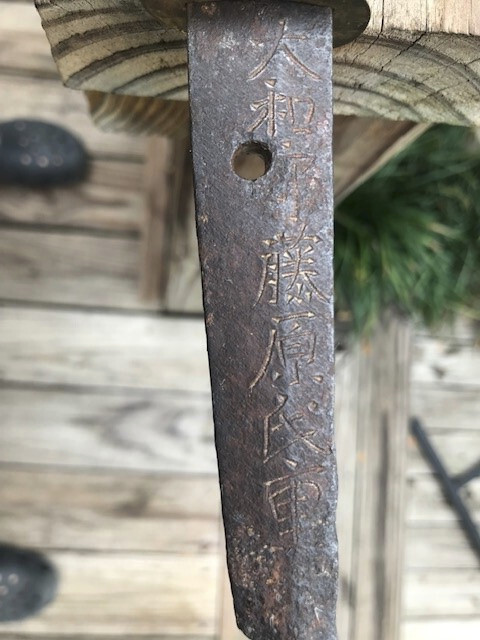

Dear members,
I was ask by a friend for help about his recently aquired wakizashi. Well, as a "katchu-bunny" my sword collecting years are already a while back. The mei reads "大和守藤原氏重" (Yamato no Kami Fujiwara Ujishige), but all I came up with, in my limited sword library, was the first generation Harima Ujishige, around Meireki (UJI 162). Unfortunately, I can't find this exact mei anywhere (neither in the books nor on the net), to compare the signature in question with confirmed examples. Can somebody bring me on the right track?
With some hope for help, thanks in advance!

Thanks David and Dan!
@Steve
Yes, I saw these examples and they caused my doubts. Also “Kanzan” has only the mei with the Daijō title, where at least the “Uji” and “Shige” characters are quite different chiseled. Unfortunately, the few pics of the blade I got are too blurry to judge the workmanship.
  • 6 months later...
Hello, did you or your friend found out more details about this mei? I am comparing it to this one and can see some similarities.
