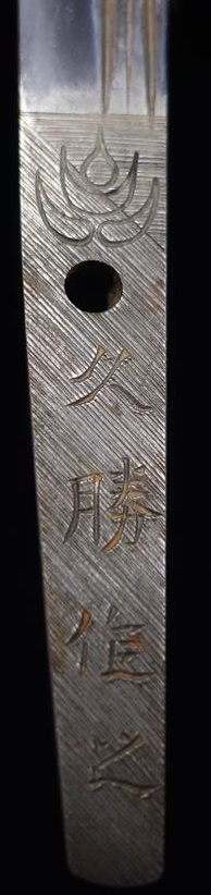

Itomagoi Posted October 31, 2022 Report Posted October 31, 2022 Hi, can someone help me with the translation? I think the taped area is the name of the owner? Many thanks in advance. 1 Quote
Bruce Pennington Posted October 31, 2022 Report Posted October 31, 2022 I would also appreciate it if someone understands the significance of the image above the ana. Is it flames or a flower? Also, I see the year - 1936 - but what are the 3 kanji between that and the 8th month? Quote
Itomagoi Posted October 31, 2022 Author Report Posted October 31, 2022 Bruce, according to my research, it is "Hoju" 宝珠. A pearl with flames that is supposed to grant the owner his wishes. (wish-fulfilling jewel). But there may be other meanings. Quote
Bruce Pennington Posted October 31, 2022 Report Posted October 31, 2022 It made me think of that, too, but it doesn't depict the jewel. Quote
Nobody Posted October 31, 2022 Report Posted October 31, 2022 久勝作之 – Hisakatsu made this. 昭和十一丙子歳八月日 – Showa 11th Hinoe-Ne year (1936), 8th month 天久美神劔 - 天久美-A divine sword 神劔 – divine sword 劔銘 天久美 ト號ス – Sword’s name: It is named 天久美 (reading?). 石城山麓ノ齋域ニ於テ鍛冶竹島久勝 – At the holy ground of the foot of Mt. Iwaki, sword smith Takeshima Hisakatsu. 昭和十一年十月十一日 – Showa 11th year, 10th month, 11th day 齋火結凝ニ依リテ拝戴ス – It was given through 齋火結凝 (unsure: something like Shinto rites?) 神族・・・・誌(wrote) – (unsure) 4 1 Quote
Nobody Posted October 31, 2022 Report Posted October 31, 2022 On 10/31/2022 at 1:46 PM, Bruce Pennington said: It made me think of that, too, but it doesn't depict the jewel. Expand Ref. Cintamani - Wikipedia 1 2 Quote

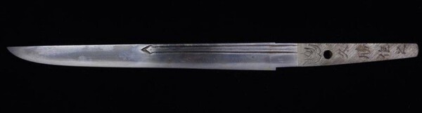

Itomagoi Posted October 31, 2022 Author Report Posted October 31, 2022 Thank you, Moriyama Koichi. Here is an other Tanto made by Hisakatsu in same style: https://www.Japanese-sword-katana.jp/未分類/1410-3043.htm 1 Quote
Michaelr Posted October 31, 2022 Report Posted October 31, 2022 Peter would it be possible to see some pictures of your Tanto and mounts? Thank you. MikeR Quote
Itomagoi Posted October 31, 2022 Author Report Posted October 31, 2022 Oh, sry. Yes, of course. 3 Quote

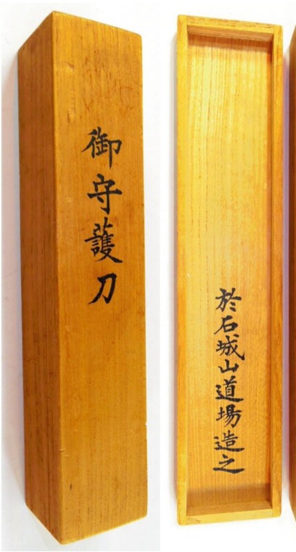

Itomagoi Posted November 1, 2022 Author Report Posted November 1, 2022 On 10/31/2022 at 2:37 PM, Itomagoi said: Thank you, Moriyama Koichi. Here is an other Tanto made by Hisakatsu in same style: https://www.Japanese-sword-katana.jp/未分類/1410-3043.htm Expand From my interest. What is the inscription of the other tanto on the box? Quote
Bugyotsuji Posted November 1, 2022 Report Posted November 1, 2022 御守護刀 Go Shugo Tō Protective blade 於石城山道場造之 Oite Iwaki Yama/Zan Dōjō Tsukuru kore Made at the Iwaki Mountain Dōjō 2 1 Quote
Itomagoi Posted November 1, 2022 Author Report Posted November 1, 2022 Thank you very much, Piers. I appreciate your translation. Quote

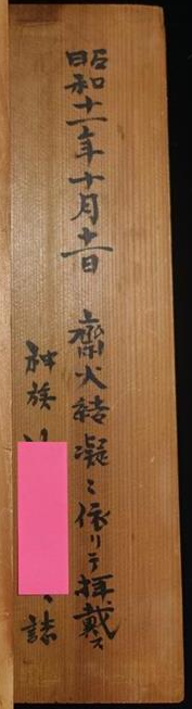

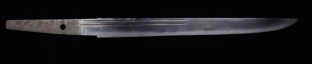

Itomagoi Posted August 2, 2023 Author Report Posted August 2, 2023 The tanto has arrived and I was wondering if anyone could help me with the rest of the translation. 劔銘 天久美 ト號ス – Sword’s name: It is named 天久美 (reading?). 齋火結凝ニ依リテ拝戴ス – It was given through 齋火結凝 (unsure: something like Shinto rites?) 神族・・・・誌(wrote) – (unsure) Quote
