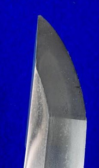

vajo Posted October 29, 2022 Report Posted October 29, 2022 Mei looks good for me. can't say anything about the blade, because the pictures are to blury. Ask him for better pictures, look for nie and ara nie. The position of the mei is correct and the yasurime is done in the correct way. The mei looks old. If it is a gendaito i can't tell it from the pictures. Polish looks like a wartime polish. Japanese Japan WW2 Showa Yukihiro Signed Katana Sword w/ Scabbard | eBay 1 1 Quote
vajo Posted October 29, 2022 Report Posted October 29, 2022 That picture looks like gendai. Its promising. I think it is a nice sword. For a reasonable price. polisher marks 1 Quote
