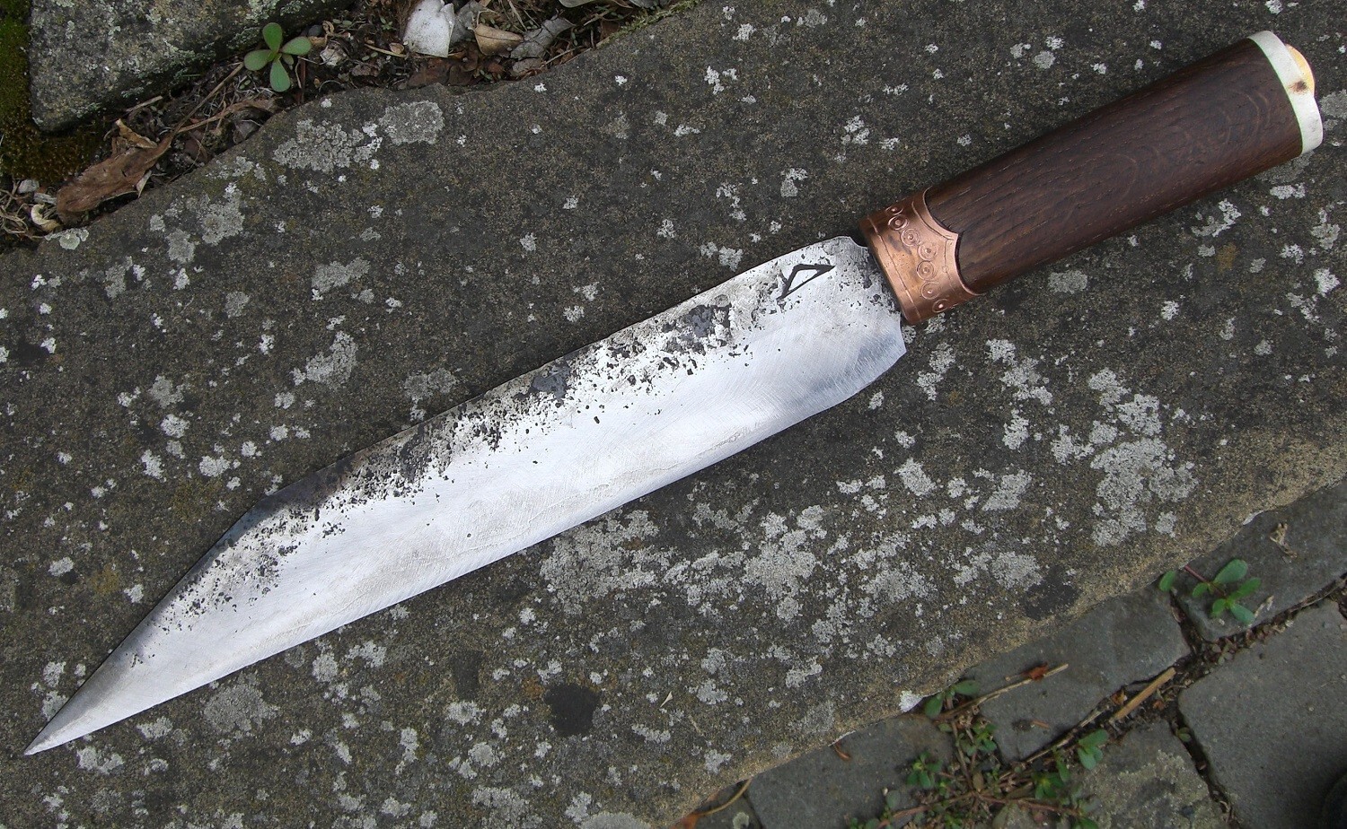

ROKUJURO Posted October 28, 2022 Report Posted October 28, 2022 David, if a knifemaker was to transform this into a knife, I am afraid he would have to trim the NAKAGO down to a fitting size for one hand. To keep the YAKIBA intact at the point, you could ask him to make a Seax point (Viking type). 4 Quote

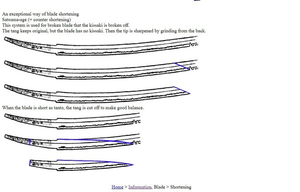

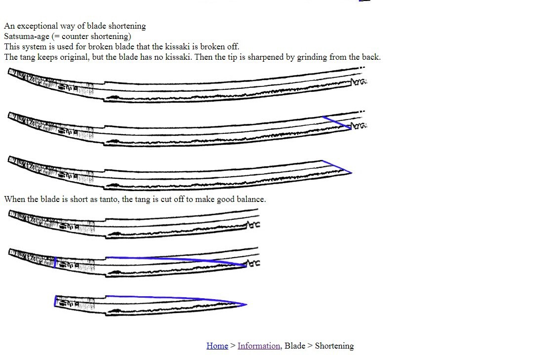

Dave R Posted October 29, 2022 Report Posted October 29, 2022 Or you could stay within tradition, a blade treated like this actually papered some years ago. http://www.ksky.ne.jp/~sumie99/suriage.html 5 Quote

drac2k Posted October 29, 2022 Author Report Posted October 29, 2022 Thanks guys for all of your support and great ideas! I think most of you understand what I'm trying to do and several people have summarized it perfectly. Rokujuro's idea of a seax got me thinking and I like the last picture of David R's diagram. The blade length is 20 cm. I will carry it to a local gun show November 25th and discuss it with the knife maker and advise the forum of my progress after that. 3 1 Quote

John C Posted November 29, 2022 Report Posted November 29, 2022 Too bad about the flu. I was interested in the project. When making the decision, remember there is a practical reason for the shape indicated by Dave R.'s diagram. Generally, only the edge is hardened steel (hence the hamon). Any other shape would introduce mild, soft, core, or unhardened steel to the tip. That's assuming, of course, you did not want to re-harden and temper the blade. John C. Quote
drac2k Posted November 29, 2022 Author Report Posted November 29, 2022 Thanks John; yes it was disappointing. I have decided to go with one of David's variations, probably the last illustration for the blade. I've been messing around with a couple of ideas for a guard under the habaki in a more Western style, while keeping a traditional handle. Quote

Shugyosha Posted February 9, 2023 Report Posted February 9, 2023 On 10/28/2022 at 9:58 PM, ROKUJURO said: David, if a knifemaker was to transform this into a knife, I am afraid he would have to trim the NAKAGO down to a fitting size for one hand. To keep the YAKIBA intact at the point, you could ask him to make a Seax point (Viking type). Expand Nice Seax! Sorry Jean, but how does the Viking seax differ from the Saxon version? 👍👍 Quote

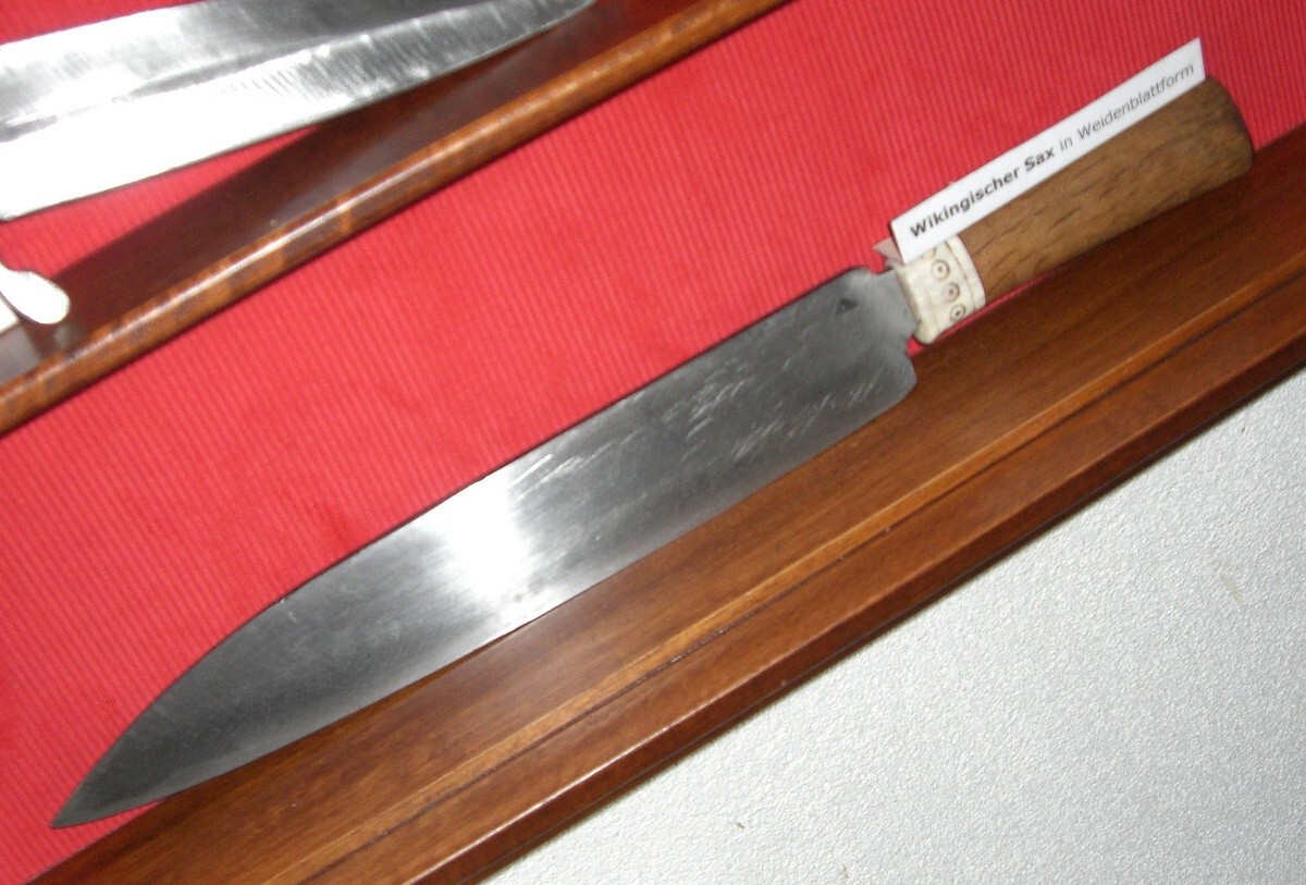

ROKUJURO Posted February 9, 2023 Report Posted February 9, 2023 On 2/9/2023 at 9:04 PM, Shugyosha said: .....how does the Viking seax differ from the Saxon version? 👍👍 Expand John, generally, seax had a very wide variety of forms. This had to do with the ethnics of the makers as well as the area of use and the times. Seaxes were in use from the Danube to northern Scandinavia, and not only Saxons and Vikings used them but also Germanic tribes. The Anglo-Saxons on the 'tin-islands' were those who used it the longest time - up to about the year 1.000! The seax in the photo above is a broad seax with a 'broken neck' shape of the tip, but there were many other versions in use (see below a 'willow leaf' blade). Some were found in graves with a length of up to 90 cm and a MOTO KASANE of 12 mm! 1 Quote
