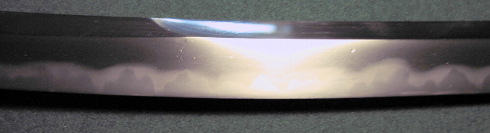

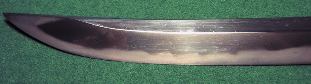

Robert C. Walker Posted June 3, 2009 Report Posted June 3, 2009 Here are some photos of my wakizashi, fresh from the polisher. I realize that they are poor photos but I wanted to get something posted. I will work on getting better ones. I am finding the boshi particularly difficult to photograph. I have been looking forward to getting the sword back so that I could study it and begin to understand all that I have been reading. I am working through describing the characteristics of the blade. I have not finished yet and I need to take some measurements but here is what I think I see so far: Tsukurikomi - shobu-jukuri Sori - Torii-zori O-kissaki with rounded fukura Iori mune with steep oroshi Nakago - Ubu, standard Nakagojiri - ha agari kurijiri Yasurime - kiri Jihada - ko-mokume & masame Hataraki - ji-nie Hamon - sugaha Boshi - It is really clear to the eye but I am stumped and I doubt these pictures will help Quote
Robert C. Walker Posted June 3, 2009 Author Report Posted June 3, 2009 A couple more just because I think it is pretty. Quote

Mark Green Posted June 3, 2009 Report Posted June 3, 2009 Nice sword Rob! I just love those Shobu-zukuri waks. Your Boshi looks to be Omaru/Komaru, hard to see the turnback length. Enjoy, and thanks for the pics. Mark G Quote
Jacques Posted June 3, 2009 Report Posted June 3, 2009 Hi, Mark Green said: Nice sword Rob! I just love those Shobu-zukuri waks. Your Boshi looks to be Omaru/Komaru, hard to see the turnback length. Enjoy, and thanks for the pics. Mark G IMHO, it looks more U-no-kubi-zukuri. :D May we know who is the polisher? Quote

reinhard Posted June 3, 2009 Report Posted June 3, 2009 Hi Robert, Taking pictures of hamon is quite tricky. One way consists in placing a spot or a single light bulb slightly above the top section of the sword and taking the picture from a low camera-angle slightly above the blade from opposite direction (i.e. from the bottom end of the blade), not unlike you are appreciating hamon when holding the sword in hands. This must be done in a dark room. The results will present you with at least a few inches of the hamon visible. You can see pics made by this techique on many Japanese web-sites and on Darcy Brockbank's, amongst others. reinhard Quote

Mark Green Posted June 4, 2009 Report Posted June 4, 2009 Hi Gang, Looking at Robert's pics, That hamon sure does run very large into the Nakago. Could we get a full Nakago, and part of the blade shot please, Robert? I think your polish looks good. Very natural. very much like it likely looked, when carried for work, hundreds of years ago. There is nothing wrong with that. So what does everyone think------- Mino? Moromachi? BUNGO???? I'm thinking shinto. just a feeling? Did the polisher have a say at this? I've seen a few Bizen, 1500's They were very powerful looking. The Mino a bit less beef., more if they were shinto I forgot, were the sizes ever posted on this sword? If not, Geeze Rob??? As my friend Reinhard has said many times, Size matters!!!!!!!! Newbees this is a MUST!!! The sizes, tell us a bunch. Not having the sword in hand is bad enough, We must have the facts, so those few here that know,(not me) Know what they are looking at. Pics are tough. Reinhard gave good advice. Check out Darcy's photo page. And experiment. New cams make this easy. Its all about the light angle. And Rob, your sword is very interesting, lets study on it some. Why would someone make this wonderful blade, with all the work that it took, and not sign it??? I just don't get unsigned swords, that do not have huge flaws. Do you think that one little blister, although deep, would keep the smith from claiming this work? Rambeling on now, Later, Mark G Oh, and Jacques, U-no-Kubi-zukuri? Please explain? I thought that was when the Shinogiji is slanted in the middle, while the lower part and the kissaki are normal. Or can it be like this as well. And wouldn't that need a kissaki, on a wak or Katana. I think, if it isn't a cut down pole arm, than it seems standard Shobu-zukuri to me. But I'm just a beginner, and have seen very few of this style, in hand. Quote

Keith Larman Posted June 4, 2009 Report Posted June 4, 2009 This is just a guess, but maybe Jacques is referring to the photo 244 up above? It looks like a reflection of something in the room on the shinogi ji of a shobu zukuri piece to me, but ... You see the same reflections in some of the other images. Quote
Jacques Posted June 4, 2009 Report Posted June 4, 2009 Hi, Keith Larman said: This is just a guess, but maybe Jacques is referring to the photo 244 up above? It looks like a reflection of something in the room on the shinogi ji of a shobu zukuri piece to me, but ... You see the same reflections in some of the other images. You are right Keith, seems i need new glasses Quote
