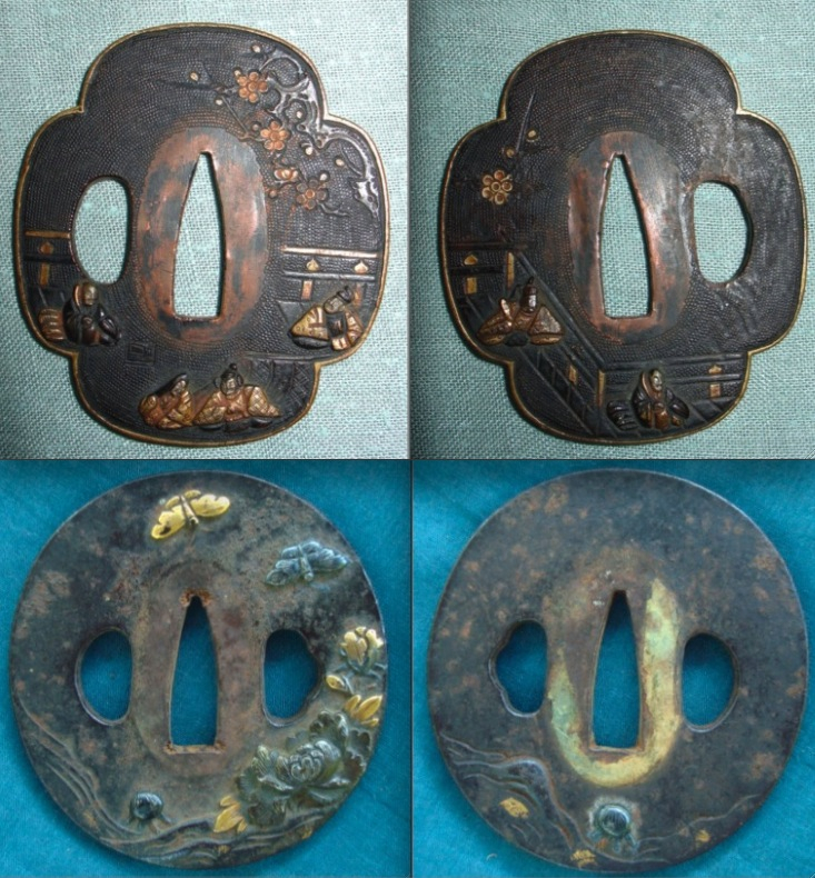

I personally don't think it is a good idea to be changing fittings on a koshirae. The koshirae as you got it is a collection of parts and could have some sort of historical meaning that we do not completing understand. You could be unitentionally deleting or mixing up a little piece of Japanese history.
I would be inclined to leave the original one on the koshirae esepcially if the one you are going to replace it with is not much better.
My very personal opinion.
Guri bori F/K in my view are very nice and should go with a matching tsuba. The wakizashi original tsuba seems very low quality to me, so it is possible that the original guri-bori tsuba has been sold in the past too and replaced with that one. You can think to replace it too but only with a matching one.
Other option, keep the koshirae as it is and make a whole new one as a spare. You can have many koshirae for one blade if you wish.
Nice fititngs. If you do decide to change the tsuba, I would go for something a bit more classy than the one you are pondering, IMHO. However the the one you bought on the koshirae might not be that bad so keep it, if only to preverse the koshirae's history as much as possible.
i think if restored id would be a great tsuba, seen a fellow from up in the twin cities do wonders with rust. i dont think eather of the tsuba match the F/K but like the not so busy new one the best if brought back to its glory.
This koshirae doesn't exactly represent the pinnacle of sword fittings and Robert, I think, is free to compile the parts the way he likes them. Nevertheless it should be kept in mind, that old koshirae were originally a mirror of the taste of their former owner. I fully agree with Henry here and even if the parts don't seem to match for a westerner: Sometimes they were chosen just for their individual merits and reflect their former owner's taste. - I'm aware of the fact, that many koshirae have been changed senselessly from late Edo days onwards; tastefully in Japan, often crudely outside. I remember seeing in Europe a complete Hamano-koshirae of the finest kind for a katana, signed and dated on some parts, but with a poor iron sukashi tsuba from Meiji-times flapping around nakago.
Changing parts of koshirae has been done and will be done for good reasons, but it should be done with a sense for Japanese aesthetics, a basic knowledge of Japanese history and its myths and a basic respect for history itself, just in case you don't know what you're doing.
As far as these two tsuba are concerned: Does the original one fit tightly to the blade? If yes, I would keep it.
reinhard
The butterfly and poenies tsuba "would" look better than the original one after some (very) long and (Very) careful rubbing, but it would never be a masterpiece. I doubt theres a aesthetical link between the F/k and original tsuba.
Regards
How would I go about "restoring" the peony tsuba? Is there some information on the web on how to do that carefully?
I would love to find a guribori tsuba to match the fuchi kashira but the only guribori pieces that I can find are sitting in museums. They appear to be pretty rare.

I will try to find some guidance for how to clean up the rust and then see what it looks like. Either way, I have both tsuba.

active rust is bad (red rust). you have to be careful especially on sukashi tsuba. You might need some ivory (or deer horn? not sure about that) that will scrape away the rust but isn't as hard as the iron so it won't scratch the tsuba. I think Jim G website or is it Rich Stein's has a section on cleaning tsuba?! Your tsuba I am sure will have patination issues which will be hard to address.
