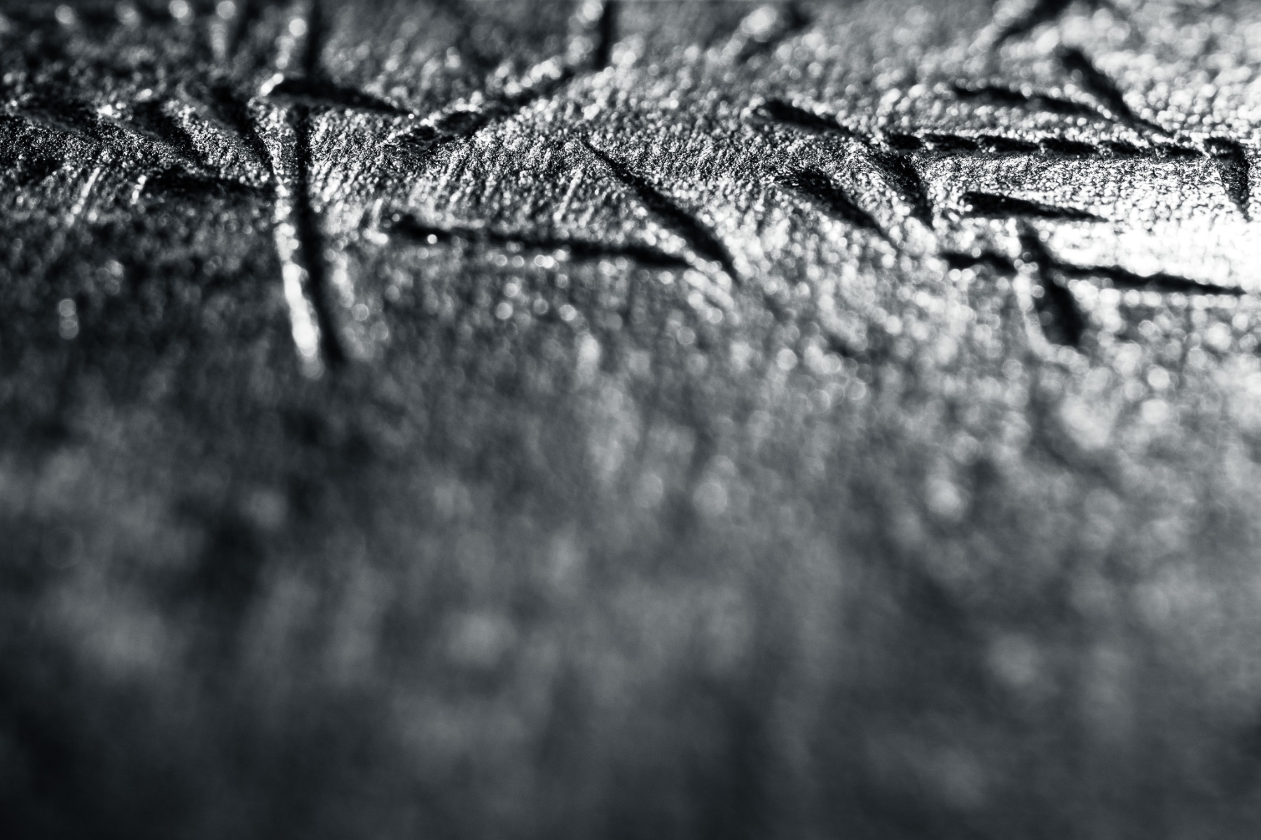

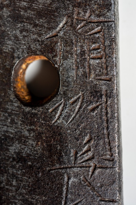

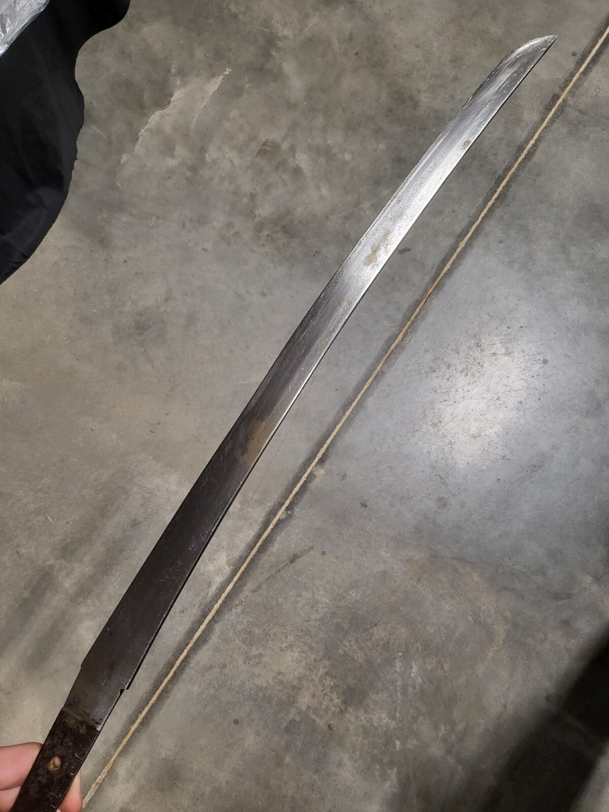

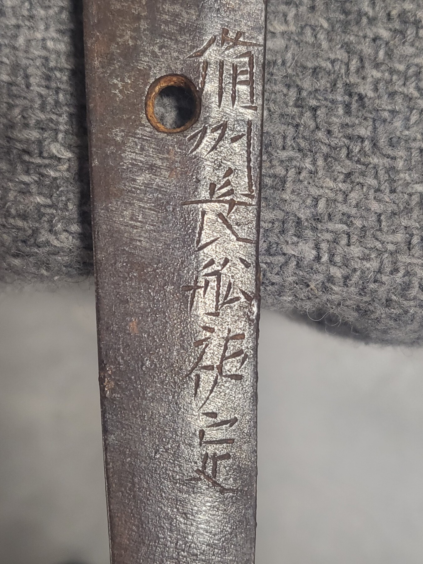

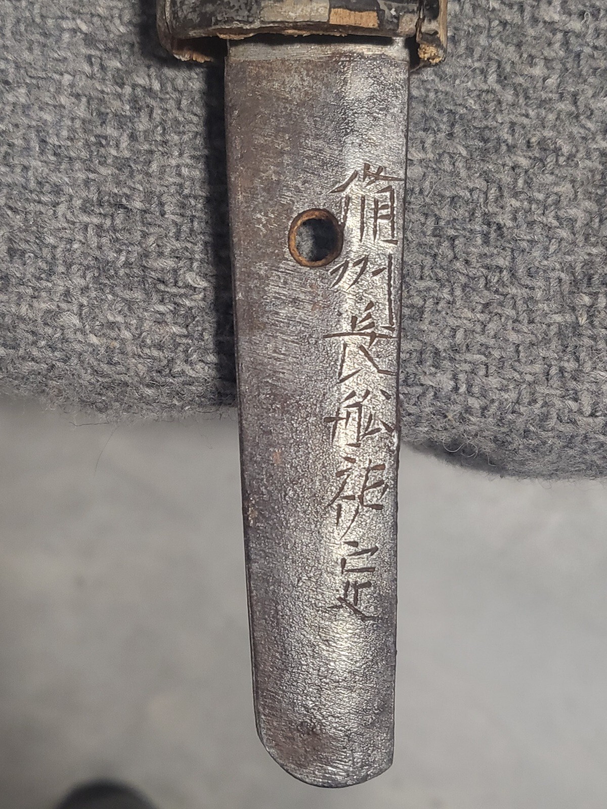

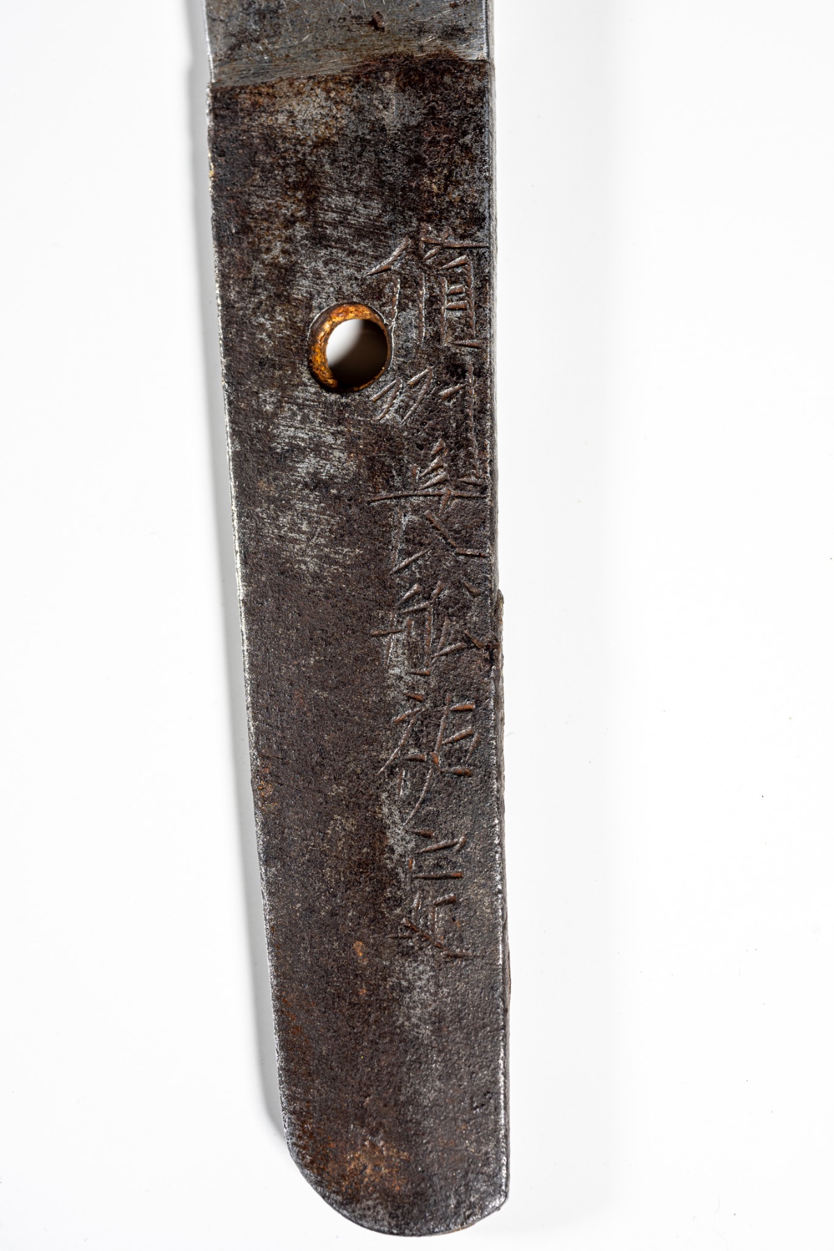

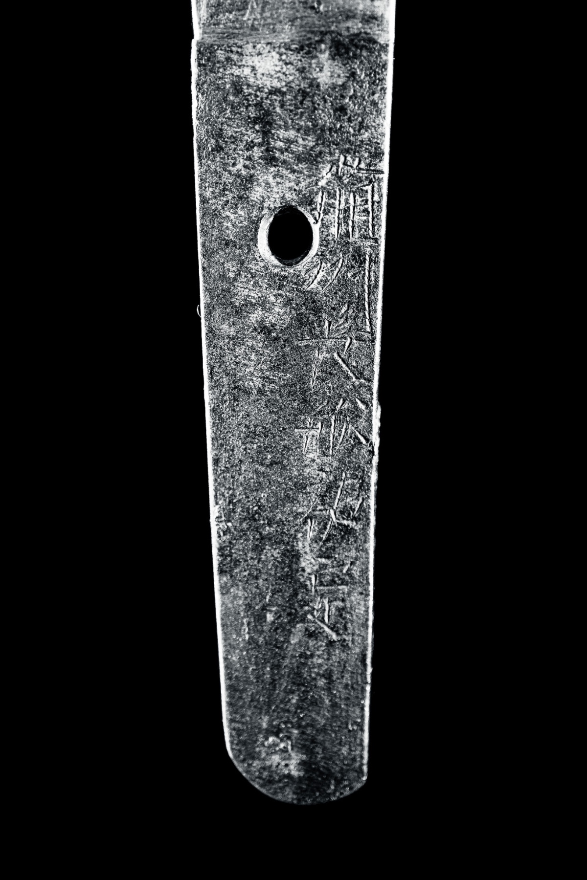

Just picked this sword up today at a local show in Colorado. This will not be sold and is now apart of my personal collection.
Would anyone here be able to help with translation. I tried Google translate with no help.
I'm currently at a show but can post additional pictures if needed. It's only signed on one side.
Thanks for your help.
- Jonathan Hoff

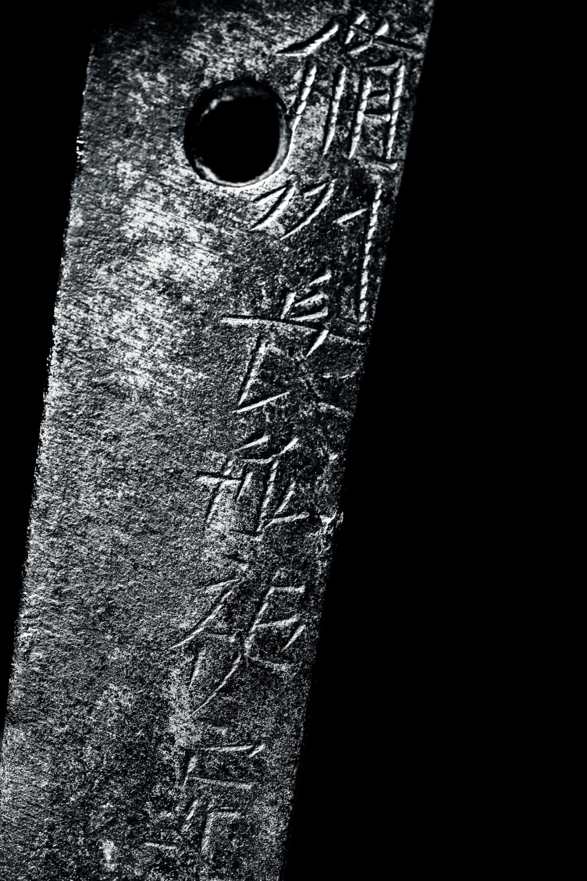

Jonathan,
it reads BISHÛ OSAFUNE SUKESADA.
I have no books on swords MEI, but I think there were many BISHÛ SUKESADA, so not sure about the era (in case the signature is authentic at all, which is not always the case).
  • Thanks 2
Markus Sesko lists these two "Osafune Sukesada":
SUKESADA (助定), Bunmei (文明, 1469-1487), Bizen – “Bishū Osafune Sukesada” (備州長船助定)
SUKESADA (助定), Daiei (大永, 1521-1528), Bizen – “Bizen no Kuni Osafune-jū Sukesada” (備前国長船住助定), “Bishū Osafune Sukesada” (備州長船助定), student of Hikobei no Jō Sukesada (彦兵衛尉祐定), mostly a chū-suguha-hitsure

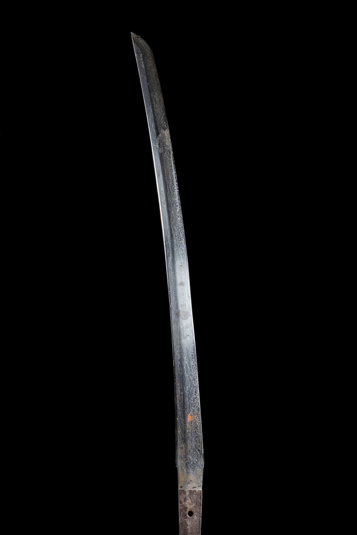

Jonathan,
the SUGATA shows a relatively shallow SORI, but that doesn't mean automatcally KANBUN JIDAI.
Without visible HADA and HAMON an assessment is difficult.

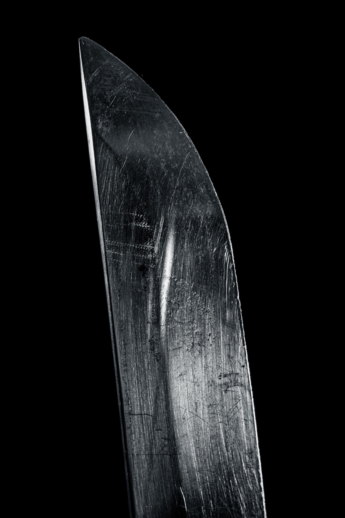

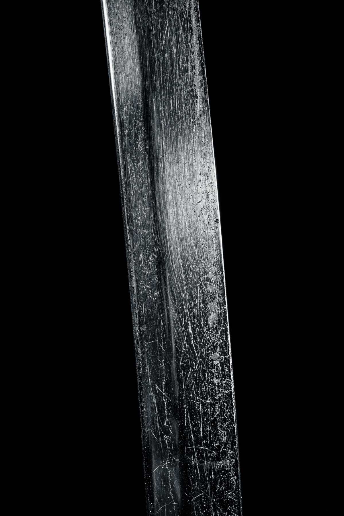

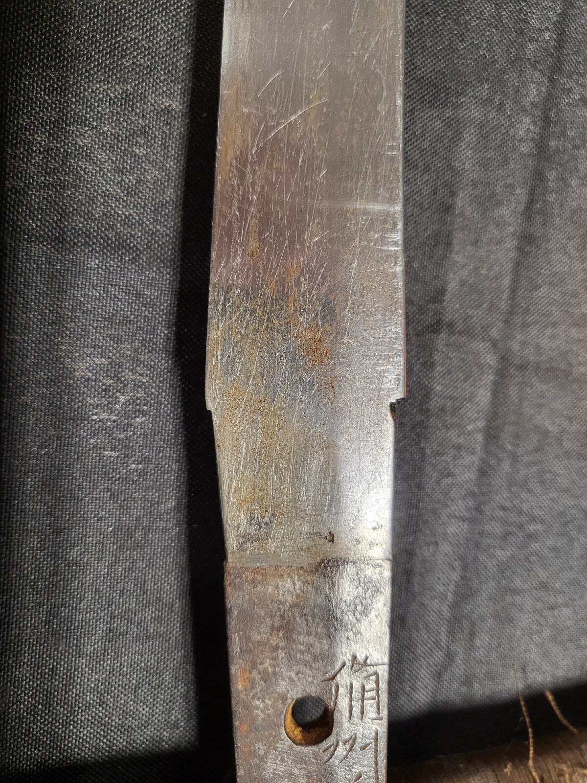

It took a bit longer then I expected to get back to you with the measurements. Hopefully I measured everything correctly.  If there are other measurements needed let me know.
The nagasa is 20 & 5/8 inches ( 20.625in )  ( 52.3 centimeters  )
The Nakego length is 5 & 1/16 inches in length. ( 12.8 centimeters )
The Sori is approximately 18 centimeters.
I included some pictures I took this evening.

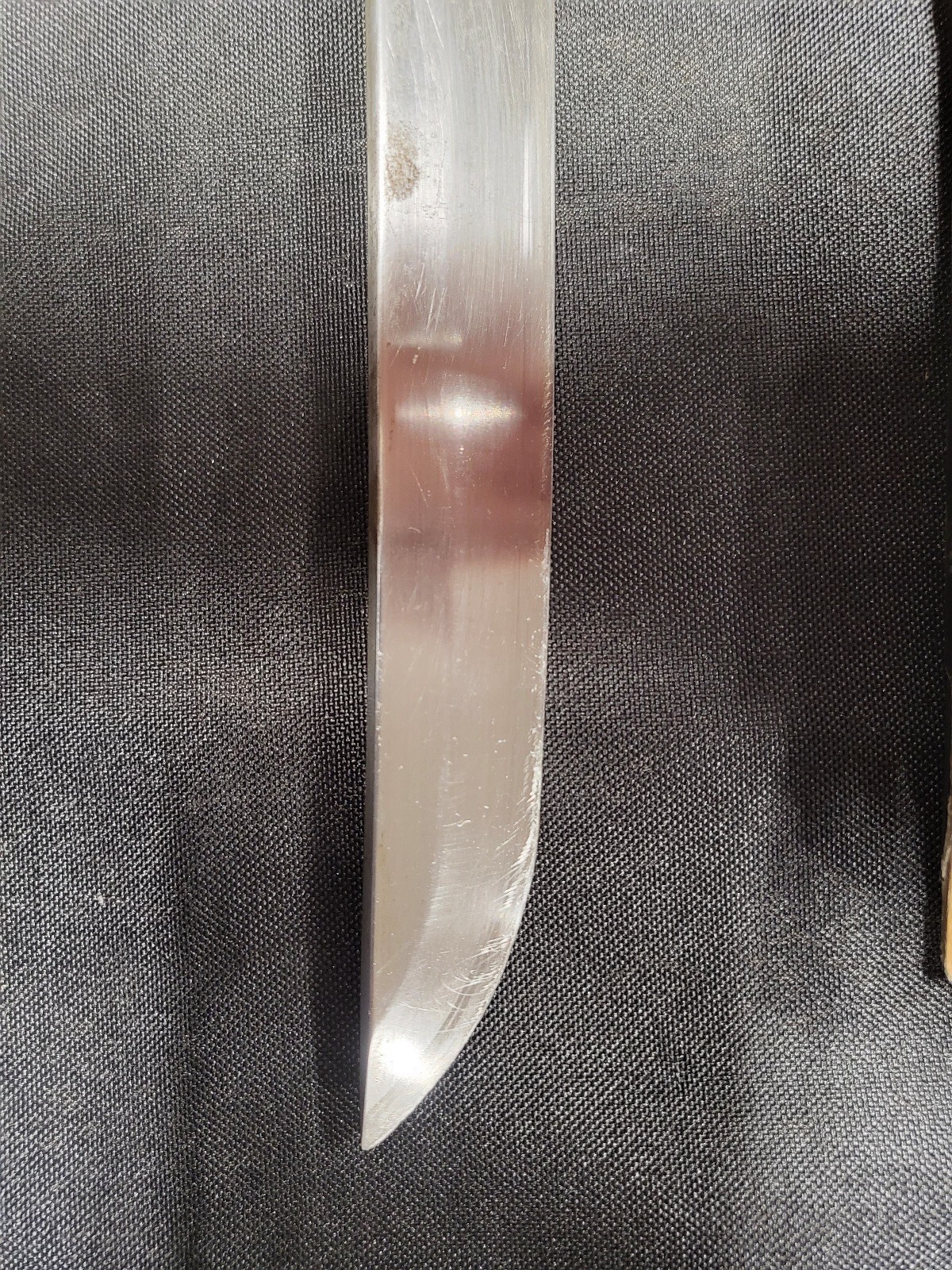

I picked up a caliper and a measuring stick hopefully this helps a bit more in determining things.
The Sori is 16.25mm
The Motohaba is 30.40mm
The Sakihaba is 21.55mm
The Motokasane is 7.21mm
The Sakikasane  is 4.87mm
The Nakego length is 122.95mm ( 4.84 inches )
The nagasa is 20.62 inches
Anything else please let me know.

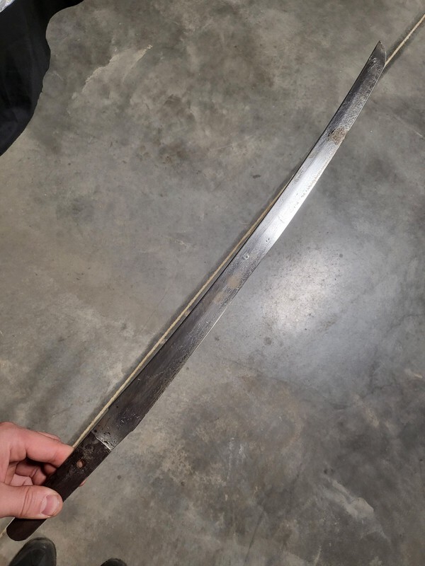

It looks like someone has already tried to give it a very amateur polish job, and has ruined it. It would need to be looked at by a professional Japanese sword polisher to see if it could be revived. And, given the cost and the potential value proposition of an unauthenticated wakizashi with a Sukesada name on it, it would be a very risky undertaking. Or, as we like to say, it would be a "labor of love", meaning you'd be doing it for the love of the sword, and not in the hope that you could recoup any investment made.
If you are just starting on your voyage into the world of nihontō, I'd say don't be too anxious to buy a sword. There are a ton of good Japanese swords out there. Unpapered, out-of-polish wakizashi are kind of at the low end of the quality/desirability spectrum. This one is even more handicapped because its not just out of polish, but it looks like it has an amateur polish that needs to be remedied.
