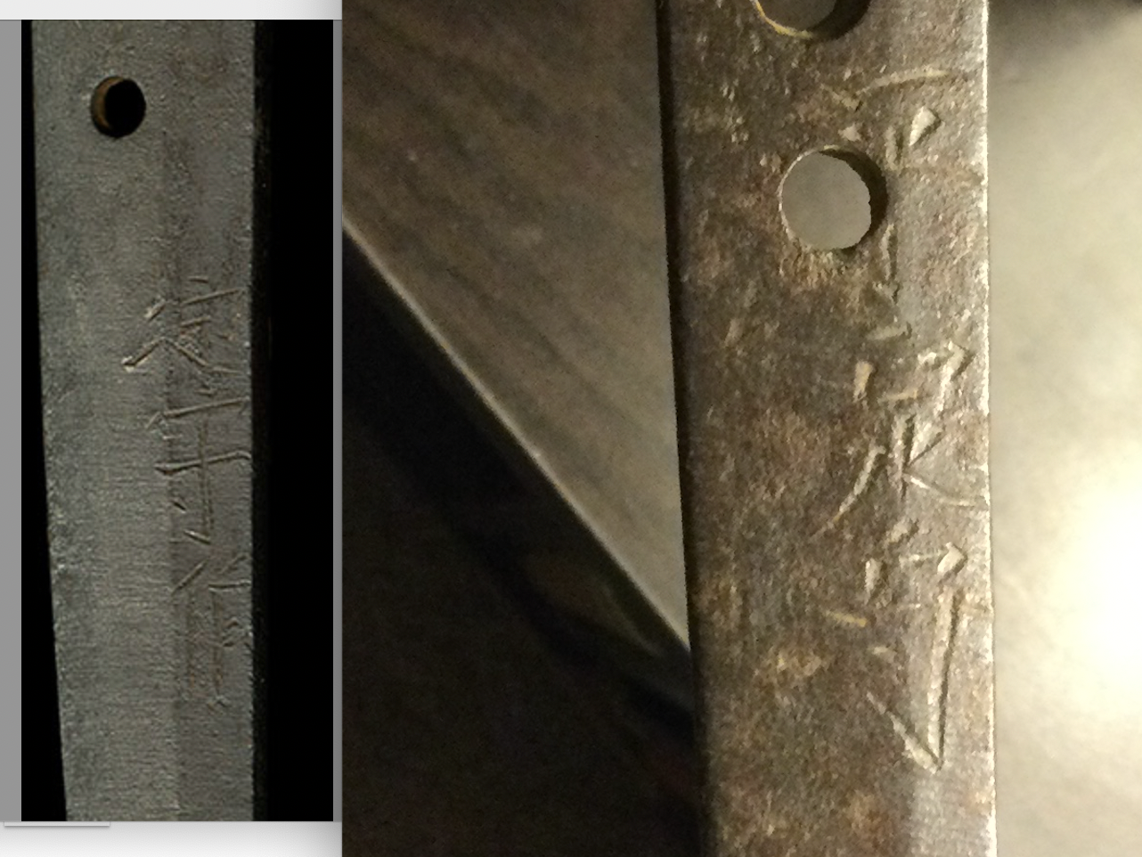

Matsunoki Posted October 24, 2022 Report Posted October 24, 2022 I’m not even saying the book is wrong. I am in no position to do that and would never dream of doing so. Does the book have absolutely all smiths listed. Could ther be omissions? Is that possible? I’m just saying making a “declaration” of gimei in these tenuous circumstances is unwarranted guesswork. Seems anyone who disagrees with you is a troll. As for the shortened Gunto theory….if they are indeed removed stamps on the nakago wouldn’t that place them originally somewhere on the actual blade rather than the nakago?….
Nihontocollector752 Posted October 24, 2022 Report Posted October 24, 2022 You also have to look at the quality of how said Takada or other shinto/shinshinto smiths carved their mei. They carved mei with excellent quality and precision. This looks like "chicken scratch" mei. Hastily done, placement is wrong, etc.
John C Posted October 24, 2022 Author Report Posted October 24, 2022 Folks: I was able to resize the pics to show the sugata (I hope). I too believe the signature may be gimei because it seems as if it were not done with any confidence. Like watching someone write a forged check - it's always hesitant. Thank you guys so much for the information. It all helps. John C.

Alex A Posted October 25, 2022 Report Posted October 25, 2022 Not wanting to jump in but feel this point has to be made for the sake of any newbies being sucked in by Jacques “everything in boxes” way of thinkng. Seen some swords with NBTHK, dated to the late Muromachi where the mei looked nothing like other examples, you would just look and assume gi-mei. NBTHK have more resources and Knowledge than Jacques, and are obviously a lot more open minded. The mei is the last thing you look at! This has gone way of mark, would advise owner to study hamon and hada closer, look for a school. Anyways, leave you to it 2
NewB Posted October 25, 2022 Report Posted October 25, 2022 Most swordsmiths were actually illiterate (from the older years, per my sensei) - you see sengoku sukesada with different chiseling of the characters signed by who knows whom.. Just as an example that is. So, I don't know where this is going but probably better to just to leave it to shinsa. My 2 coins.. ❤️ Johnny 1

John C Posted October 25, 2022 Author Report Posted October 25, 2022 Everyone: I really do appreciate all of the input. I guess it is somewhat comforting to know that my confusion over this sword is, at least in part, warranted. I think for now, I will just file this sword away as a "study" piece and look for examples of various eras that may fit the profile, etc. Thank you all very much for the interest in helping me solve this puzzle. And for the education and knowledge you all have provided. John C. p.s . I'll ditch the old Ipad and buy a better camera! 1
Alex A Posted October 25, 2022 Report Posted October 25, 2022 John, as Johnny pointed out, maybe one for Shinsa to sort this. Just having a look through Takada swords, surprising variation. See some smiths at a certain time producing running itame with masame in the shinogi-ji whilst others a Ko-mokume etc etc etc.. As said earlier, known for copying other schools. The hada did not shout Shinshinto to me, but who knows. Its a tough one, without seeing it in hand and using the available images. Cheers.

Jussi Ekholm Posted October 25, 2022 Report Posted October 25, 2022 I think there has been some good discussion yet somewhat heated. I know in the original translation thread I suspected it would be 平定守 Taira Sadamori instead of Minamoto that was on registration card. As I said then I couldn't find a single reference mei for comparison. Steve has found one and it is very different from the one on this sword. I would suspect the same thing as Jacques did that your sword in this thread would be gimei. Here is bit of an amateur explanation for what I feel on the signature. Basically the focus would be on the two characters, Sada 定 and Mori 守, and how they seem to me to be on reference signatures by Taira Takada smiths, in Bungo smith book. Of course not being native English speaker it is not easy to explain what I think I am seeing with words. Sada (定) character in general is wider on the reference Bungo smiths (while the reference Sadamori that Steve found seems to be extremely wide), and more sharp. Of course the sword in question is extremely narrow but still. In reference mei that Steve found, the Mori (守) character seems to be very long. Based on the few examples I saw in the book, the smith Hisamori (久守) seems to use bit similar long style in Mori. When you look at the long downward stroke in Mori on your sword, it seems to be on the very right side and there is a long upwards stroke at the bottom. In general I did not see these features in any Taira Takada mei, the long downwards stroke was mostly at the center of character and there was a small tick at the bottom. I am of course more than willing to change my view if other reference mei pop up somewhere, but this seems to be very unknown Bungo smith. The reason why I asked for a picture with habaki earlier is, that I think the extreme narrow form might be throwing us off. Would it be possible to see the tsuba in place and tsuka on top to see how the holes line up when tsuka is in place? As the tang is so narrow I think it might optically make us think the holes are further from machi than they are in reality? Of course I am bit puzzled as on some pictures the nakago looks very narrow and long and on some I feel it seems more regularish proportions. 1

John C Posted October 25, 2022 Author Report Posted October 25, 2022 Jussi: The mei from my blade and the reference sample side-by-side look very different. Even the phrasing "Sadamori saku" vs. "Taira Sadamori." So, a gimei then? As for the koshirae, I can take a pic if you think it would help, however as you have heard, my pictures are not very good using my current equipment. Additionally, the tsuka and tsuba are not original to the blade. Or at least the tsuba is not. It must be at least 5 or 6 mm too large and rattles on the blade. The saya seems to fit okay and the habaki is an exact fit. John C.
SteveM Posted October 26, 2022 Report Posted October 26, 2022 Hello John, Regarding the inscription; The first kanji is 平 (Taira). Taira is a well-known clan name. Swordsmiths often sign their swords using their clan name. It isn't the smith's real surname. It is an assertion of ancient nobility. It is the swordsmith's way of saying, "somewhere back in my family's history we were affiliated with a powerful and aristocratic family". There are four common clan names that one finds on swords and tsuba. In order of frequency (most common to least common), they are 1. Fujiwara (藤原) 2. Minamoto (源) 3. Taira (平) 4. Tachibana (橘) We know from looking in the swordsmith name indexes, that a smith named Sadamori did indeed use the clan name of Taira. There may not be many (or any) extant examples of this smith's work, but from the information given in the histories, it doesn't surprise us to see the name "Taira Sadamori" on a sword. So the inscription format itself is not suspicious or unusual. As was mentioned, it is common for a smith to start out using one form of signature early in his career (perhaps "Sadamori-saku"), and then change to another style once he achieves a certain level of success or renown. So this too, is no cause for suspicion. As to the authenticity of this particular sword's signature, we are already deep in the weeds, and in a way it isn't very relevant at this point. However, its important to focus on the sword itself: the shape, the hada, the hamon, etc. Unfortunately all of these things can be hard to judge over the internet, so often we jump to the shortcut, which is: trying to judge the signature (the angle of the strokes, the depth of the strokes, etc.). But here is the thing - even if the signature were a perfect, stroke-for-stroke copy of the same signature that is in the authenticated sword, it would still be essential to look at the sword itself to verify whether the work matches the work of the smith, because even if the signature is an exact copy, the signature will be judged gimei if the sword looks nothing like a Sadamori sword. Conversely, if the sword itself looks every bit like a Sadamori sword should look, but the signature is slightly unusual, the signature may still be judged as valid, because its harder to fake a sword than it is to fake a signature. To put this another way, with a bit of practice, I can make a very good copy of Monet's signature, but no matter how hard I try I will not be able to make a good copy of a Monet painting. Its just too hard to fake the style, the materials, the patina profile, etc. Unfortunately, we don't have a very clear idea of what a classic "Sadamori sword" should look like. All we have is that one sword to compare it against, and its just not super helpful given how obscure this smith seems to be. (But I agree that the NBTHK usually knows what they are talking about, and they have more resources at their disposal than we have). Consider it gimei and study as much as you can of the hada and hamon. Regarding the registration; It isn't unusual for clerks in the city halls and boards of education to make mistakes on the registration papers. In your case, because the hole is obscuring part of that kanji (平), and because it isn't written very cleanly to begin with, it is easy to mistake it for something else. Let's assume that the person registering the sword just made a simple error. 2 1
dkirkpatrick Posted October 26, 2022 Report Posted October 26, 2022 The hada and the nioiguchi especially by the ha machi, make me think this sword is saiba. Hate to say that without seeing in hand but just my impression.
Alex A Posted October 26, 2022 Report Posted October 26, 2022 Lots and lots of swords out there made by obscure/low level smiths where there is very little references. (for us) Not just Koto, Edo too. References that only the likes of a shinsa panel may have a hold of. No doubt they come across swords now and again where even they scratch their heads.
Matsunoki Posted October 26, 2022 Report Posted October 26, 2022 2 hours ago, dkirkpatrick said: the nioiguchi especially by the ha machi, make me think this sword is saiba Hi Doug, welcome to the debate! I also noticed this. In one image the hamon/nioiguchi clearly looks to finish bang on the hamachi which I think would suggest saiba IF we are looking at machiokuri? Any apparent continuation into the nakago could be a polishing creation or perhaps a shadow of the previous hamon. Anyone else see it? All the best Colin
