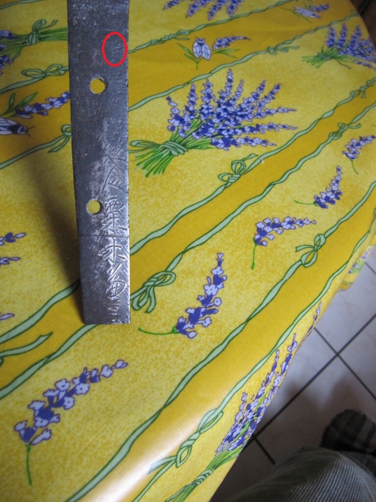

John C Posted October 18, 2022 Report Posted October 18, 2022 I was looking at my wak under a loop and noticed this "spot" on the ura side of the blade. Maybe I'm just seeing things, however it looks like someone tried to remove a mark of some sort. I am unsure since I am unfamiliar with typical nakago condition. Any thoughts? Regards, John C.
Nihontocollector752 Posted October 18, 2022 Report Posted October 18, 2022 Military blade? Sometimes stamps were removed
Matsunoki Posted October 18, 2022 Report Posted October 18, 2022 John- Can we see images of the whole nakago and the whole blade please? That will help in determining what the two “marks”might be. To me, based on what we can see of the nakago, it doesn’t look like a military sword ….it looks older….and the “marks” could simply be deeper rust pits. All the best.Colin
John C Posted October 18, 2022 Author Report Posted October 18, 2022 Jimmy: My thoughts as well. Could it be a military blade that someone tried to alter and make look older? The consensus is that it looks like an older blade, so I am not sure. Charles: Not sure how big the star stamp was, however that spot there is only about 3mm wide. The spot I identified is about 6mm wide, if that helps. John C.

lonely panet Posted October 19, 2022 Report Posted October 19, 2022 its all in your mind, its a pre war sward 1
Nihontocollector752 Posted October 19, 2022 Report Posted October 19, 2022 3 hours ago, lonely panet said: its all in your mind, its a pre war sward Pft, in all your infinite wisdom, please elaborate @John C could you cut to the chase and post the pics here so we can adequately answer your query (if possible)
NewB Posted October 19, 2022 Report Posted October 19, 2022 Looks like the holes were punched and most likely suriage. IMHO , I doubt this is a WWII blade with stamps being removed. J&U 1
Jacques Posted October 19, 2022 Report Posted October 19, 2022 On 10/18/2022 at 5:42 AM, John C said: I was looking at my wak under a loop and noticed this "spot" on the ura side of the blade. Maybe I'm just seeing things, however it looks like someone tried to remove a mark of some sort. I am unsure since I am unfamiliar with typical nakago condition. Any thoughts? Regards, John C. It is possible, here is a nakago of a showato that has been artificially aged, the stamp has been erased, a false patina has been applied, the nakago jiri has been sawed and a second mekugi ana has been pierced, I have cleaned the mei in order to read it. Please, pay attention at the mekugi ana they are instructive.
