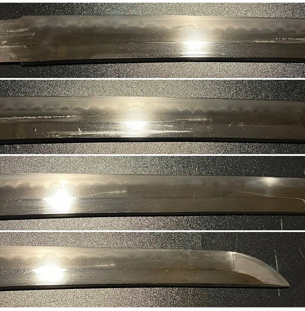

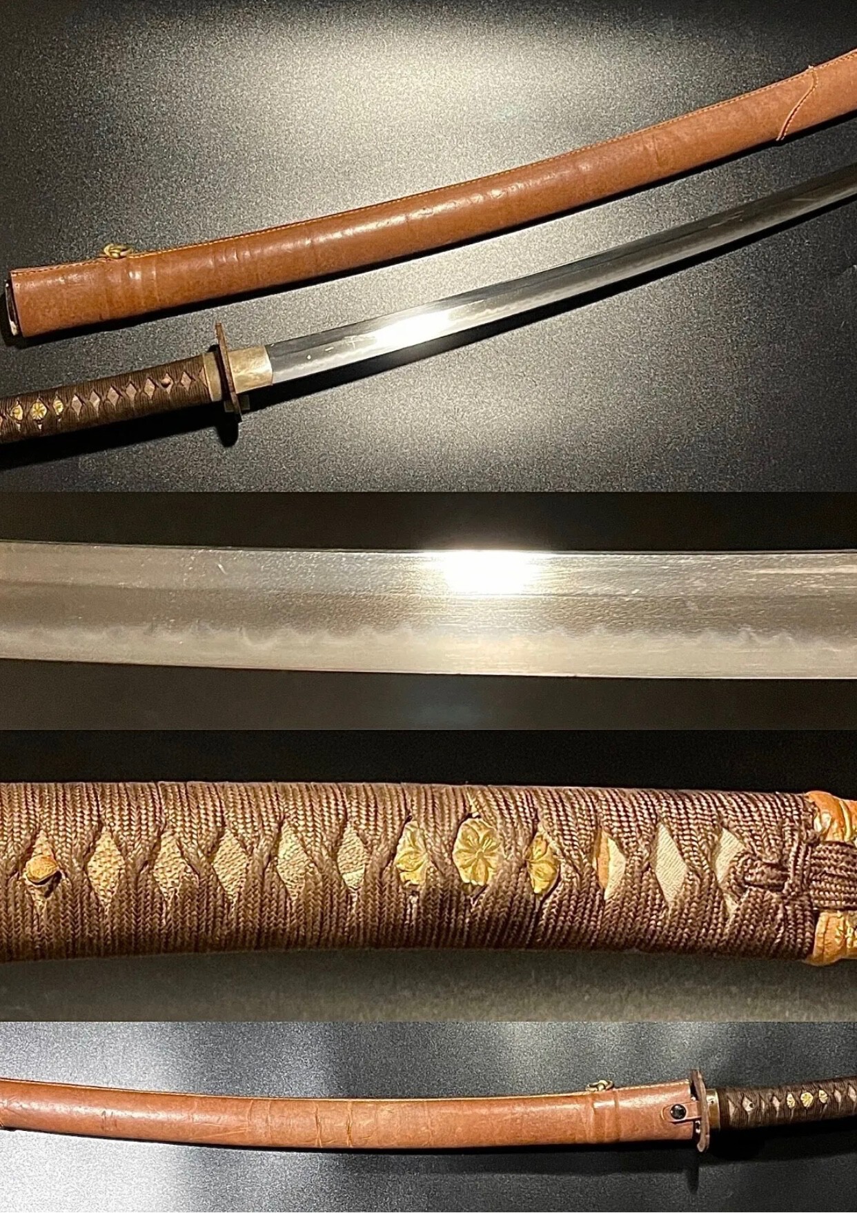

Hi can I get info with this sword
How old or what era I’m thinking koto but not sure the hamon looks decent I was concerned if there are scratches or something else like openings) Also is said to be Gendaito
Any information would be helpful Anyone know about This dealer

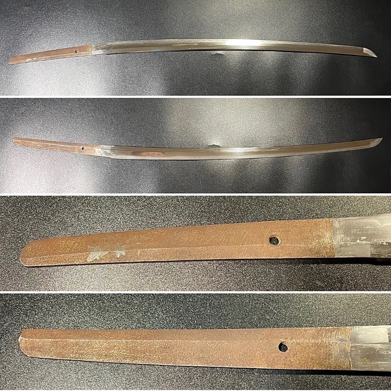

As usual we are working from limited photographs but I'm puzzled as to what makes you think this is Koto.  Hamon is pretty typical for Showa and it as suguha boshi, nakago is original and unaltered and is also what you would expect from Showa.  Where are you getting that Koto vibe from?  Interested to know.

yes showa most liked arsonal with know stamp But they were not always stamped

The others are being kind . This is mass a produced Showa piece . People are deluding themselves if they think that this is even possibly a gendaito and are on drugs or something  if they think it is Koto . Give it a miss

I’m almost certain it is a showato. Note the gunome with dark peaks in the photo? That’s textbook showato. Maybe the seki or showa stamp was worn off by abrasion or is covered by rust.
