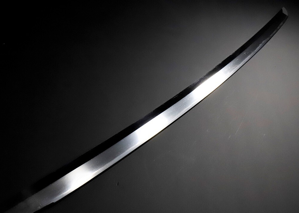

Rivkin Posted October 24, 2022 Report Posted October 24, 2022 Its Muromachi Tenbun. Uniform torii zori with just a tiny hint of koshii zori, not much taper, rough looking utsuri with no clear midare shape and certainly not jifu utsuri. The measurements of kissaki in situ are not a determining factor, ko kissaki of the early swords is tiny in comparison with what otherwise is a great blade with much greater width an hamachi. For the school the choice here is wide. Fuyuhiro, for example. Can be Bizen Sukesada. Can be something else, they are all similar in some of their work and the level of valuation reflects that. Its not mainline Soshu or Kaneuji school because it lacks nie activity. Quote
Utopianarian Posted October 24, 2022 Author Report Posted October 24, 2022 Depending on the angle of the pic or light source can dramatically change the appearance of the blade. Here are pics that show nie on the blade. I am starting to think posting pics of blades doesn’t really help much. In hand always best which is tough when one cannot attend group studies etc.. Quote

Jacques Posted October 30, 2022 Report Posted October 30, 2022 I won't say anything about this sword because I am not a fortune teller but I will say that you can only see an utsuri on a blade in a perfect state of polish (if the polisher is talented enough). Quote
Okan Posted October 30, 2022 Report Posted October 30, 2022 Dear George, I love your obsession and enthusiasm with your sword but I agree with @Jacques D. None of us here can attribute your sword to a specific school by looking at the pictures you've taken. Sometimes people see what they really want to see..When I look at your pictures I can see that it's a very nice sword, definitely koto, a little out of polish..Does it look like a Yamato blade..yes sure..But also looks like Yamashiro..and why not Bungo Takada? None of us here are professional appraisers..Even we were, we could be mistaken.. Let me give you an example: Here is a Kanenaga blade appraised by the famous Hitoshi Hayashida..He's also one of the official ww2 sword appraisers..(also sayagaki was written by him in 1950s) So the fancy sayagaki says in short: Kanenaga from Yamato Province This blade is ōsuriage and mumei Blade length ~ 62.3 cm Is mounted in a Nobunaga-koshirae This sword is referenced in the Higo Tōsō Roku. The scabbard is of the same dimensions as the scabbard of the sword that is a heirloom of the family of Marquess Hosokawa. Does it look like a Kanenaga?.yes it does..Also, how could Hayashida-san have made a mistake as he was looking at the blade up close and also a master of Kantei..But he did.. ..in 2017, NBTHK appraised the sword as Yamato Shikkake, with Tokubetsu Hozon Token. Hayashida-san was close but not right.. at the end of the day we are all humans right..what if NBTHK was wrong? Enjoy your lovely sword!.. Okan 2 1 Quote
Utopianarian Posted October 30, 2022 Author Report Posted October 30, 2022 Okan thank you. Very interesting and informative. Yamato blades are very hard to attribute if mumei in a lot of cases it seems. It’s kind of disheartening or I guess my expectations are too high and lack of experience. Especially with the excellent example of Hayashida-San vs NBTHK and the different points of view. Such a great amount of knowledge between the two and as you stated Yamato at the end of the day. All I have to say is I will never drop big bucks on a Papered mumei Yamato with a specific attribution ie…Kanenaga Quote

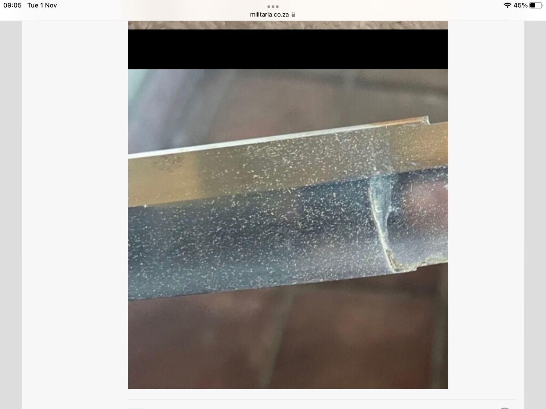

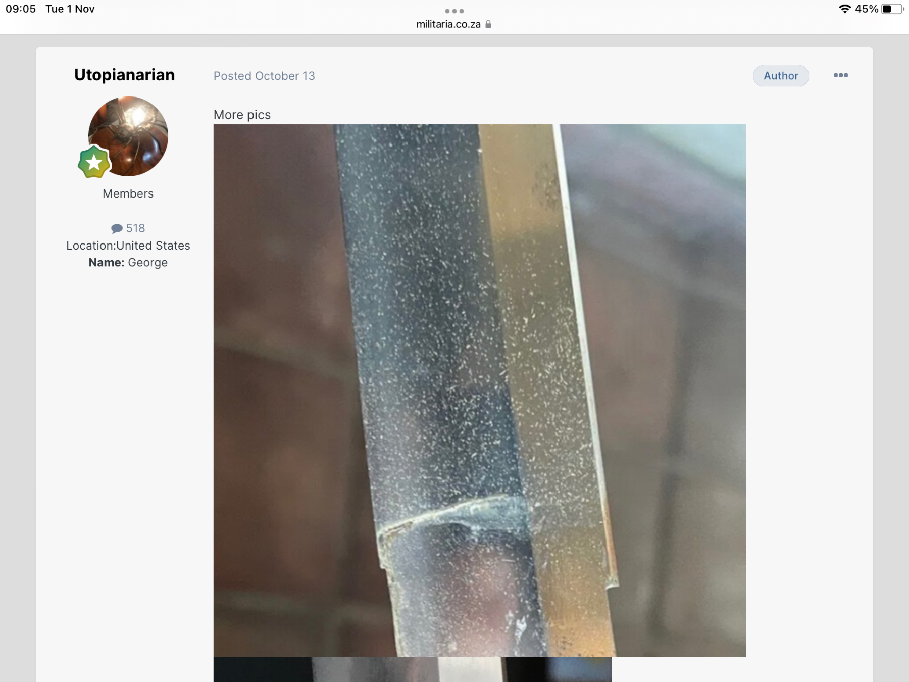

Matsunoki Posted November 1, 2022 Report Posted November 1, 2022 George, Hello, Can I just ask…….are you saying the “effect” that we can see in these two images, ie the “whiteish dots” all over the blade are nie? I have a blade with very similar characteristics and they are in fact the remains of very very fine surface powder rust that show up like this at a certain lighting angle. Quote
Utopianarian Posted November 1, 2022 Author Report Posted November 1, 2022 Surface powder and rust buildup is evident on the blade but are not reflective. The zoomed in pic is reflective nie when a light source is cast upon it. I don’t think “rust or surface powder ” is congruent or have much in respect to luminescent properties Quote
Matsunoki Posted November 1, 2022 Report Posted November 1, 2022 Please correct me if I’m wrong but the shinogi-ji is usually burnished with a steel burnishing rod (as opposed to stones) ie a uniform smooth mirror finish and nie are not usually visible in that part of the blade? Powder rust leaves minute surface pits, almost microscopic, which, if not removed by polishing, can create an illusion. However you have the blade in hand and an eye is far better than an image! Quote
Nihontocollector752 Posted November 1, 2022 Report Posted November 1, 2022 It's rust. Surface nie cannot be seen using random lighting and images from a phone or substandard setting, you need a finely polished sword and the right environment. There is a difference between grain and nie. To know is to know and when you know you'll know. Quote
