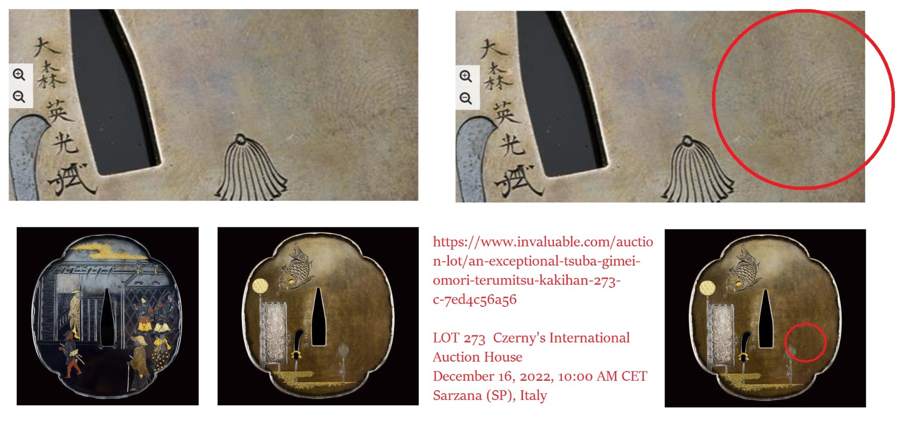

I’ve actually got another one to ask about though. Is this a gimei tsuba (no. 2 in this post)? The first image is taken from aoi Japan for comparison.
Xander,
this is a very solid ECHIZEN KINAI TSUBA in seemingly good condition! Nothing wrong with that. Cleaning a bit with a pointed piece of antler will improve the looks and prevent rust coming up. Be careful with that nice gold decoration!
Your attitude in collecting TSUBA is your personal thing, and there is nothing to criticize. Perhaps in the long range, you will develop another look at the subject and no longer enjoy the lower quality TSUBA. The problem is then that these cheaper TSUBA will not sell easily. But perhaps that is not really a problem...

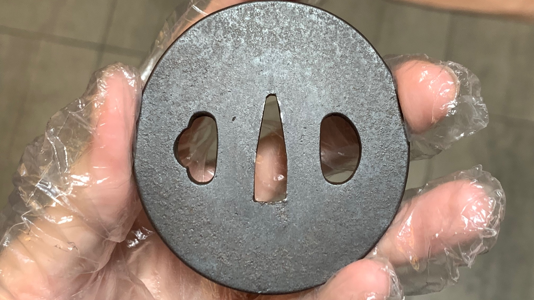

Xander, I see you wear plastic gloves when handling your tsuba. While most people don't bother very much as the tsuba was often meant to be handled and even gets a lot of its patina in this way - some can be damaged by handling Steves87  and I have been doing some research on just that subject and he is forwarding that information to a professor who is doing a paper. I found one example yesterday which shows fingerprint damage in an upcoming auction.
So good for going the extra effort in care of your collection.:thumbsup:
yep, that is a good practice to get into. Not sure how critical it is for iron guards, but any of the softer metals/alloys, it is important. Just in the last couple of weeks while searching, enough cases have appeared to know that it is a problem.
Xander, the two Kinai tsuba are from the later period of the school of the Rokudai (6th) Takahashi master, who had a number of deshi working for him (so variations in the basic mei).
They are good basic work in smaller tsuba, probably often given as presents.

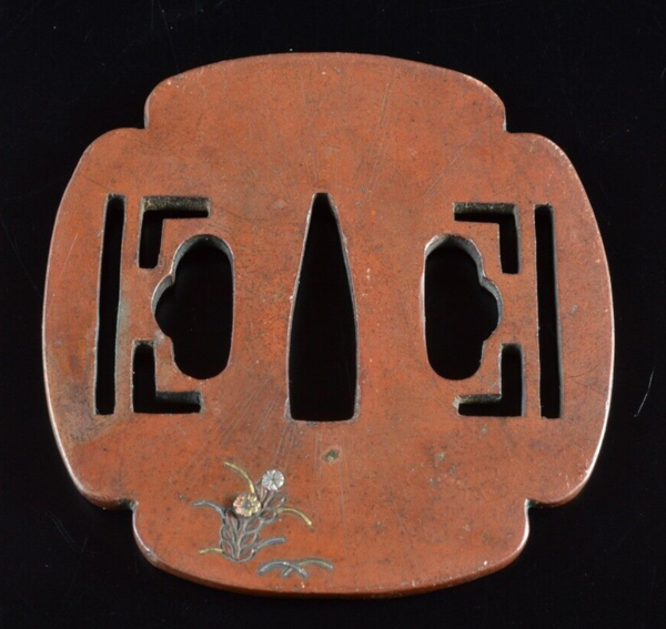

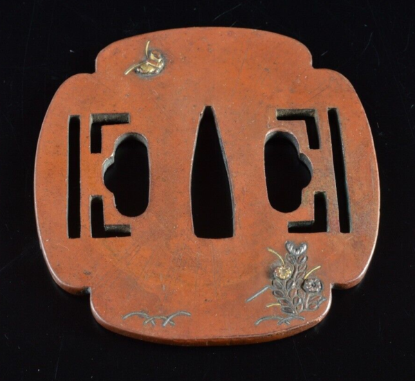

In the spirit of this thread, this tsuba passed by couple weeks ago.
Odd openwork and at first glance an odd copper tsuba but the (apologies, correct term for the pattern escapes me atm), careful outward radiating grooves (sunbeams from point on horizon), made me think it was perhaps more interesting than I gave it credit for, only having half-recorded seeing it while browsing. Maybe new and not a masterwork but interesting I thought. Interested in opinions on what it is. Thank you in advance.
Axel, the term you are looking for is "Amida Yasuri"  the Halo of the Buddha. Very faint and delicate on that piece. I think amazing skill, can you imagine working your way around and coming up short or too long in the spacing? Getting the depths all the same- like I say amazing, yet you need a microscope to see it!
I’ve always been kinda confused as to why some items are “meant to be handled.” I kinda understand the importance of patination but I personally find it odd as preservation of these items is often held as the utmost important thing. If I remember correctly there is a thread about whether nakago should be oiled. Wouldn’t patination eventually remove all traces or at least diminish the mei and yasurimei? I mean to put it in simple terms isn’t it basically “destroying” the outer layer of the metal?
