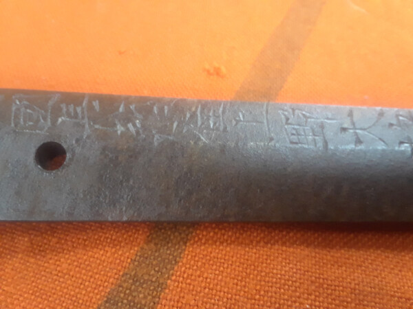

ChrisW Posted October 1, 2022 Report Posted October 1, 2022 Hello folks! I've got a katana a friend here needs a translation/ID for. I believe it to be mid-late 1800's but I could be very wrong. Its numbers: Nagasa: 29.25 inches Sori: 0.75 inch Nakago: 9 inches Height at yokote: 0.875 inch Hamon appears bright and attractive, the hada is indistinct. Appears to have osaka-yakidashi with nice kaeri on the boshi. I'll let the pictures do the rest of the talking: Quote

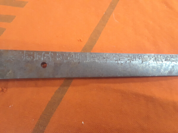

ChrisW Posted October 1, 2022 Author Report Posted October 1, 2022 And one more set of the blade: Quote

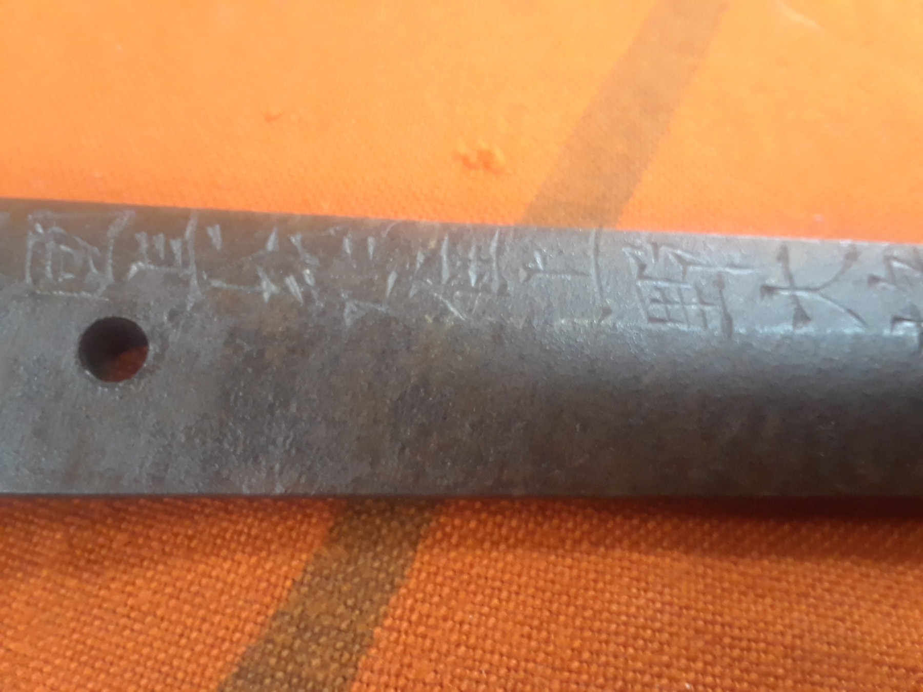

Jussi Ekholm Posted October 1, 2022 Report Posted October 1, 2022 My guess for signature would be - 備前国長船住上野大掾藤原祐定作 - Bizen no kuni Osafune jū Kōzuke no Daijō Fujiwara Sukesada saku and date I see as - 元禄十六年二月日 - 1703. The signature side is unfortunately bit blurry so I am not 100% sure. 3 Quote

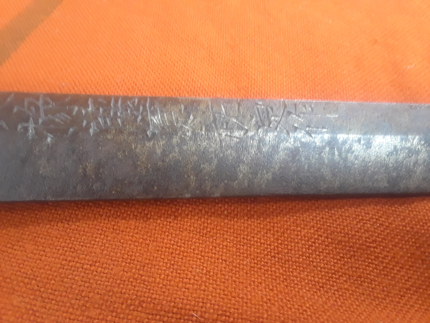

ChrisW Posted October 1, 2022 Author Report Posted October 1, 2022 On 10/1/2022 at 11:37 PM, Jussi Ekholm said: My guess for signature would be - 備前国長船住上野大掾藤原祐定作 - Bizen no kuni Osafune jū Kōzuke no Daijō Fujiwara Sukesada saku and date I see as - 元禄十六年二月日 - 1703. The signature side is unfortunately bit blurry so I am not 100% sure. Expand Let me see if this helps, it is broken into two parts here: Quote

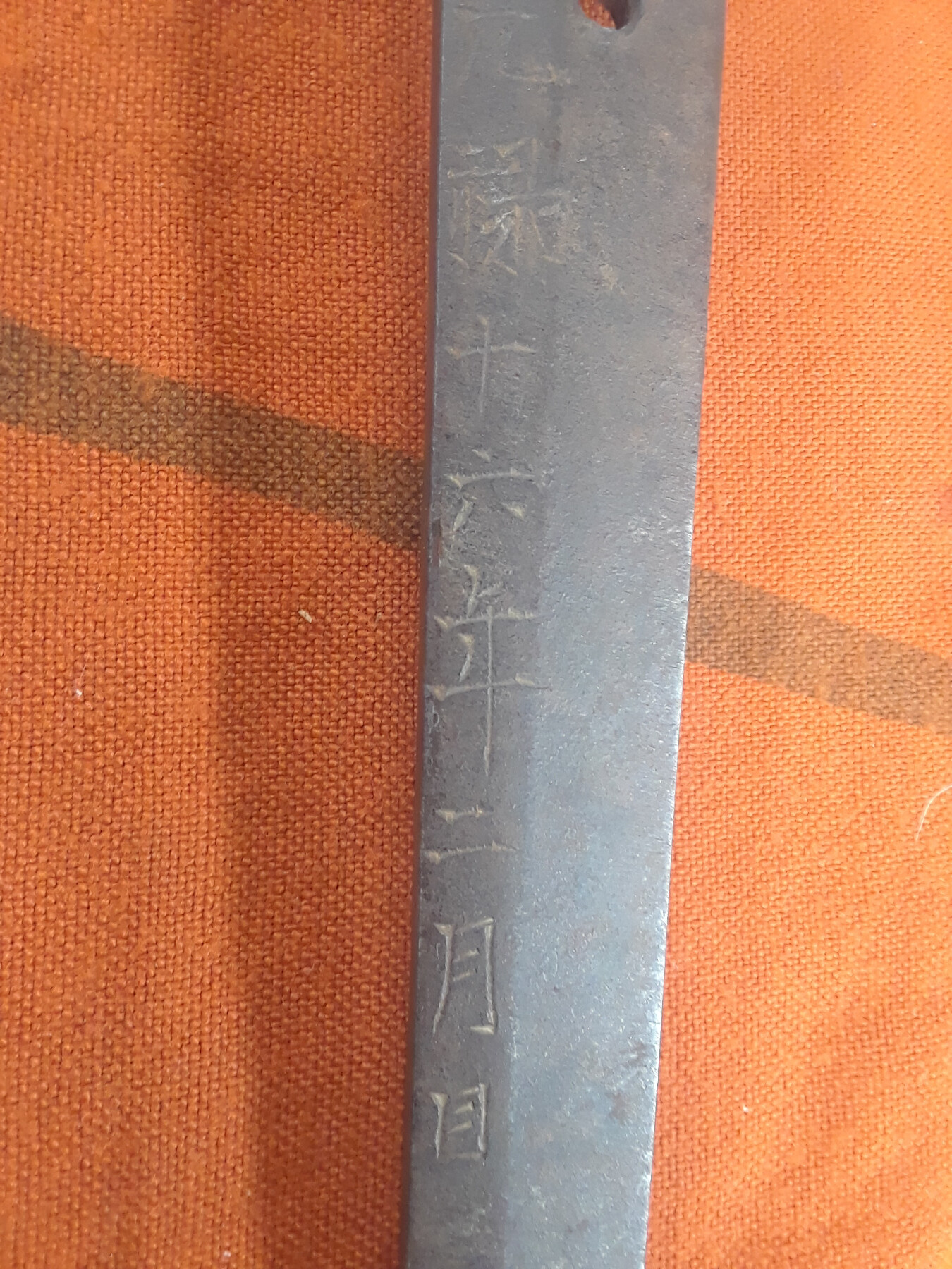

ChrisW Posted October 2, 2022 Author Report Posted October 2, 2022 And here's another shot of the nengo: Quote

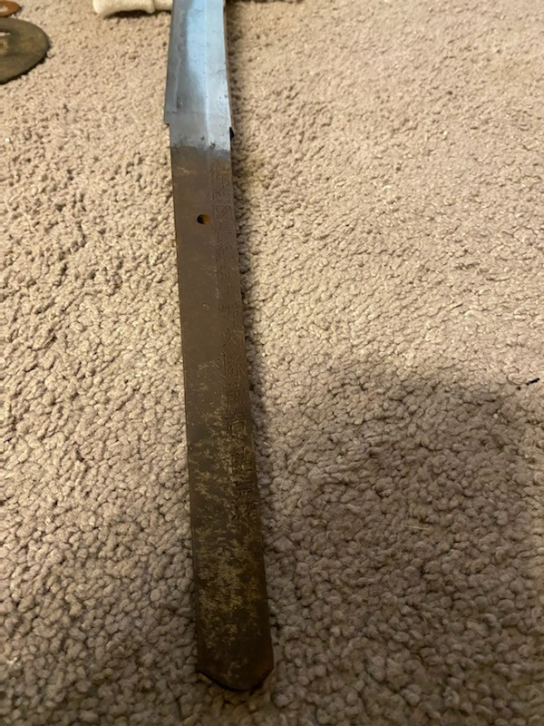

Jacques Posted October 2, 2022 Report Posted October 2, 2022 If possible i would like to see a photo of the whole nakago (from ha machi with nakago jiri included) Quote
ChrisW Posted October 2, 2022 Author Report Posted October 2, 2022 Sure thing, will get that as soon as I am able Jacques. Also, thanks to Brian or whichever mod moved the post! Quote

ChrisW Posted October 2, 2022 Author Report Posted October 2, 2022 @Jacques D. Here is a shot of the nakago and the overall of the blade: Quote
Rivkin Posted October 2, 2022 Report Posted October 2, 2022 It looks legit. The style is a mixture of shinto Bizen traits (yakidashi, sugu boshi, dense hada, no utsuri), lacks uniquely shinshinto bizen features and tries to imitate in places Muromachi elements, in places its more Kanemitsu-looking. The signature writing is well spaced, consistent speed and force of strikes. Sugata is ok. Nakago condition is quite a bit more modern (early Showa) nakago, but such things occasionally happen. Quote
ChrisW Posted October 2, 2022 Author Report Posted October 2, 2022 Thank you for the insights Kirill. Admittedly, I was caught off guard a bit by the condition of the nakago. It must have been well-cared for prior to its capture in WWII presumably. Quote
Jacques Posted October 3, 2022 Report Posted October 3, 2022 Chris, Good news, the nakago matches well with the one Sukesada made and as what I could see of the work also matches well, I would present this blade to a real expert as it has real chances to be shoshin. Nengo is Genroku 16 => 1703 it is Shinto Quote
