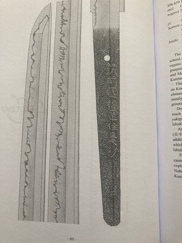

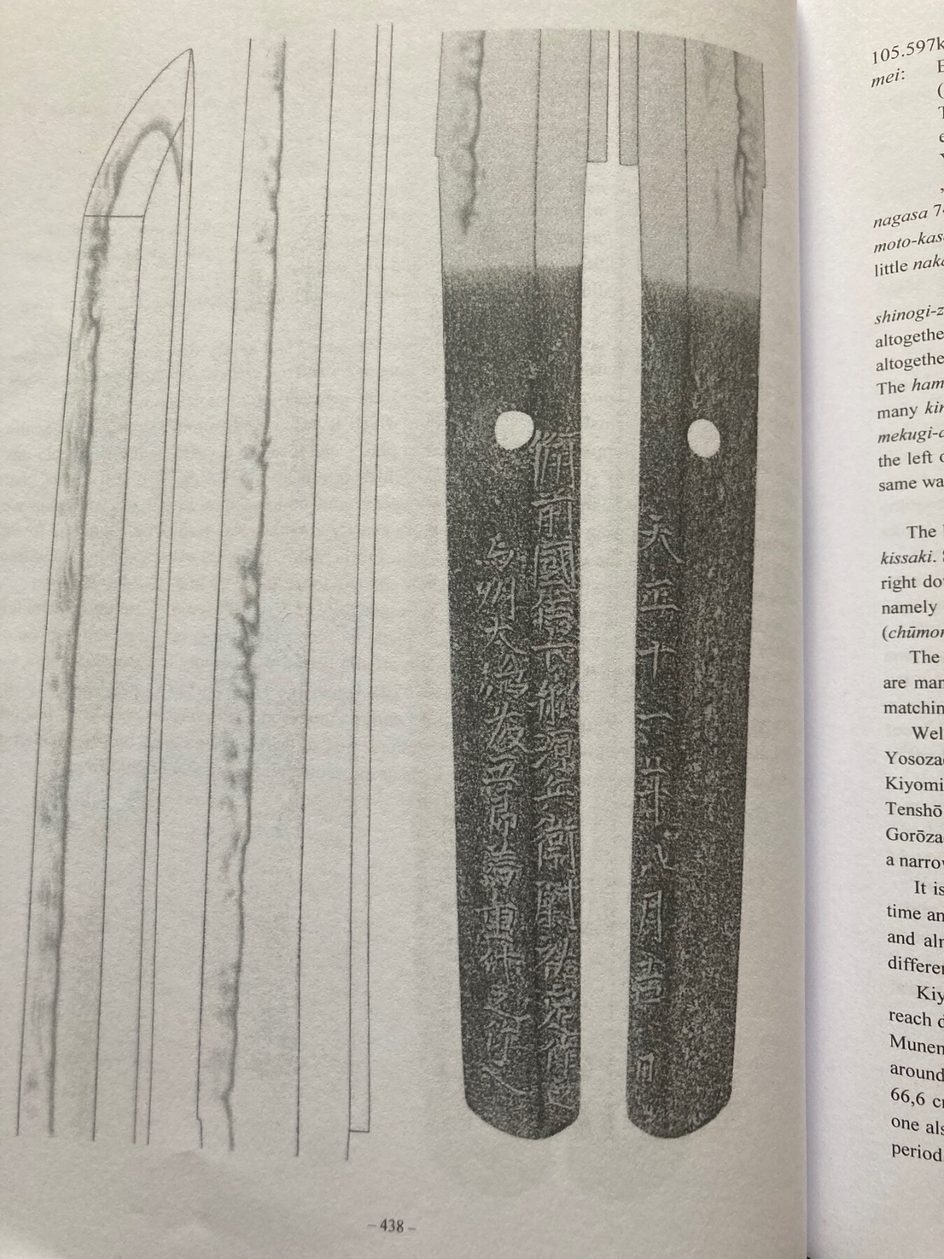

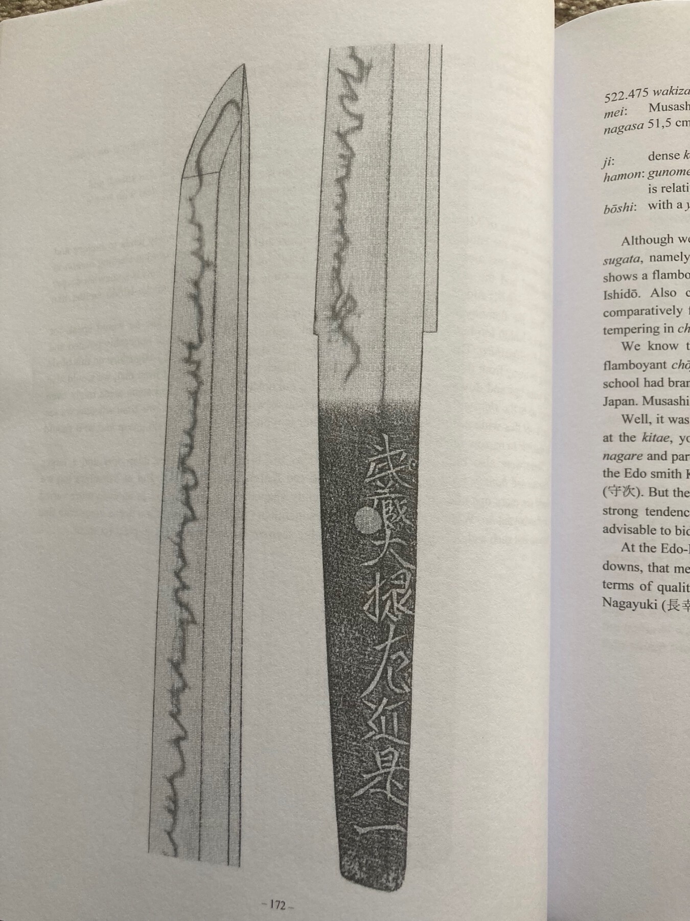

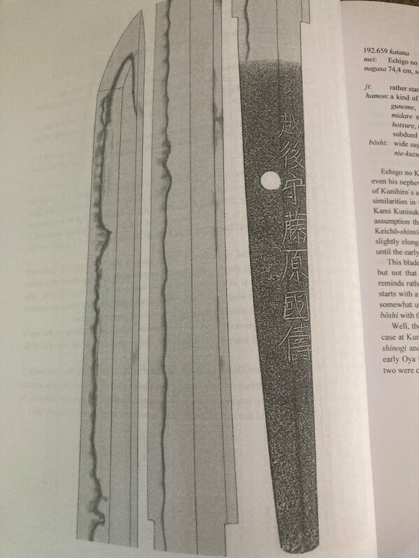

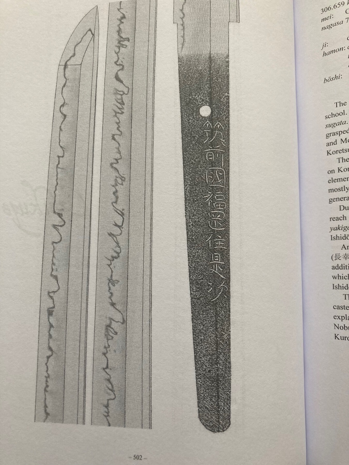

Alex A Posted October 6, 2022 Author Report Posted October 6, 2022 Wont bore anyone much more on this subject, something i needed to look into as its niggled for a while. Had some time today so been looking through Kantei books, actually quite interesting looking at different oshigata with regards the hamon at hamachi. Trying to get my head around it for once and looking for any points of view from others Final thoughts, don't automatically assume a blade has been shortened when you see the hamon run into the nakago, sometimes it can run surprisingly far. You see it in Uda. You see it in Bizen, also in the late Edo with regards Yokoyama school, especially when there is Suguha Yakidashi. (varies) Added some images. 1) Bizen Sukesada (Tensho) 2) Ishido Koretsugu 3) Ishido Korekazu (wild finish there, reminds me of the Yokoyama above) 4) Echizen Yasatsugu (quite popular on his blades, the ones i looked at) 5) Echigo Kunitomo Thanks to those that chipped in on what is a lacklustre subject, haha Quote
