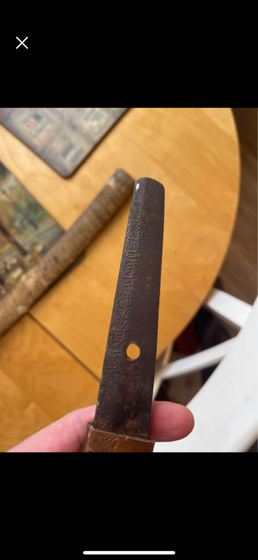

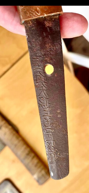

Unknown Posted September 27, 2022 Report Posted September 27, 2022 It is supposedly from ww2 but don’t know much about it. I’ll appreciate the person who can verify this. Thanks. Quote
David Flynn Posted September 27, 2022 Report Posted September 27, 2022 You need to post better photos. The Nakago (Tang) is upside down and difficult to read. Quote
Unknown Posted September 27, 2022 Author Report Posted September 27, 2022 Let me know if this works for you. And thanks. Quote
Unknown Posted September 27, 2022 Author Report Posted September 27, 2022 On 9/27/2022 at 8:55 PM, David Flynn said: You need to post better photos. The Nakago (Tang) is upside down and difficult to read. Expand Did an edit on the picture that maybe will give a better view. Quote
Jussi Ekholm Posted September 27, 2022 Report Posted September 27, 2022 I would think the signature is - 陸奥大掾三善長道 - Mutsu no Daijō Miyoshi Nagamichi 5 Quote
ROKUJURO Posted September 27, 2022 Report Posted September 27, 2022 Last photo is mirrored I think. 1 Quote
DoTanuki yokai Posted September 28, 2022 Report Posted September 28, 2022 The maker is relatively famous smith known as Aizu Nagamichi. https://nihonto.com/the-aizu-nagamichi-kei-会津長道系/ Quote
Unknown Posted September 28, 2022 Author Report Posted September 28, 2022 On 9/27/2022 at 9:54 PM, ROKUJURO said: Last photo is mirrored I think. Expand Yes it it, I thought it was going to help. Thanks to all. Quote
Bruce Pennington Posted September 28, 2022 Report Posted September 28, 2022 Might have been brought home from the war, but that's not a WWII sword. Much older. Still could have been used during the war, of course. Better pics of the saya (scabbard) might help, but it looks like a civil one, maybe wrapped like that to protect it? Quote

Jacques Posted September 29, 2022 Report Posted September 29, 2022 Mei seems legit, this sword deserves to be shown to real experts (probably the hardest to find outside of Japan). Quote
