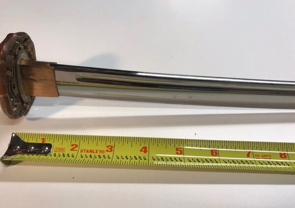

Thanks Francois good document by Bruce
the W as I referred to was one of 3 different stamped
1 star tagahamane added
2 w ?
3 X rejected

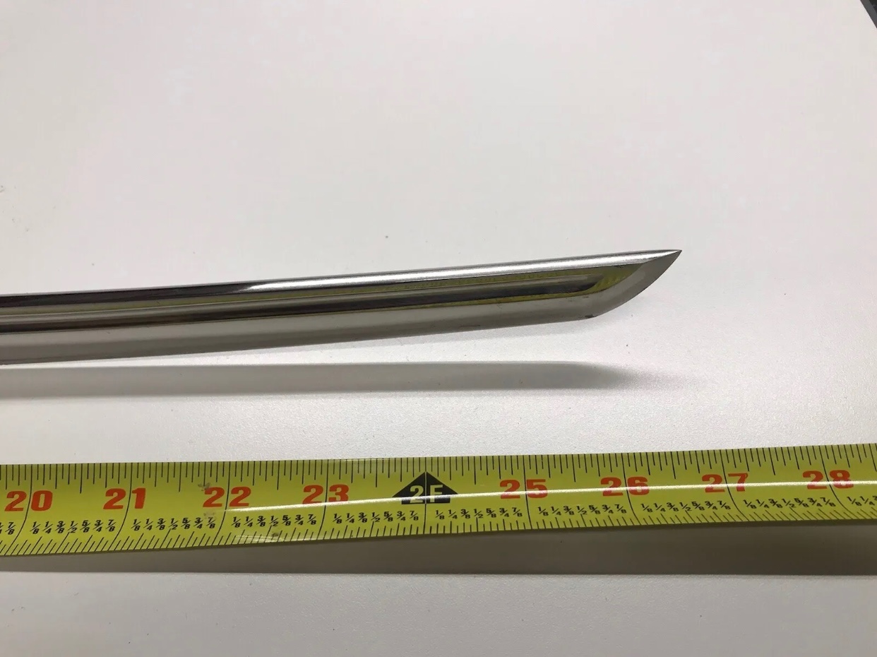

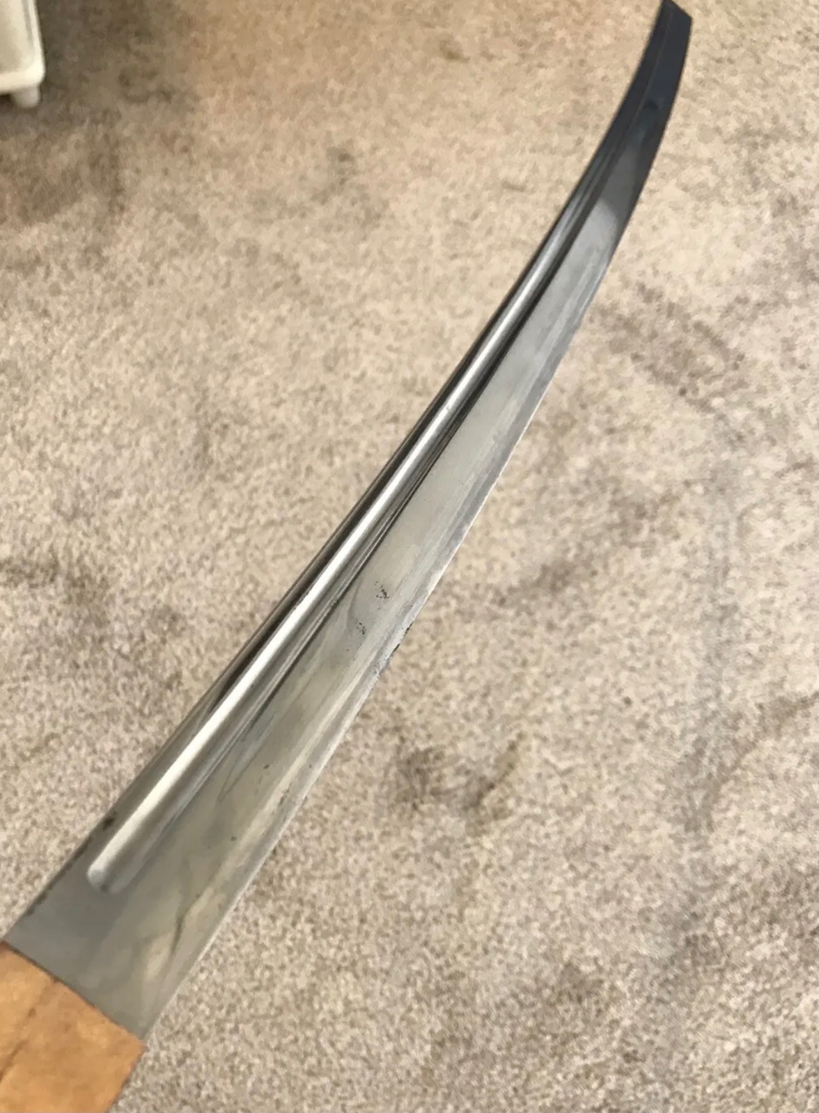

can anyone elaborate on the w stamp
It is an officer variant of the Type 95.  The Type 95 was highly thought of by the army for its cutting ability.  So a prototype was developed and tested that could be used by officers.  I think @Shamsy could own one of the test pieces used in the sword's development.

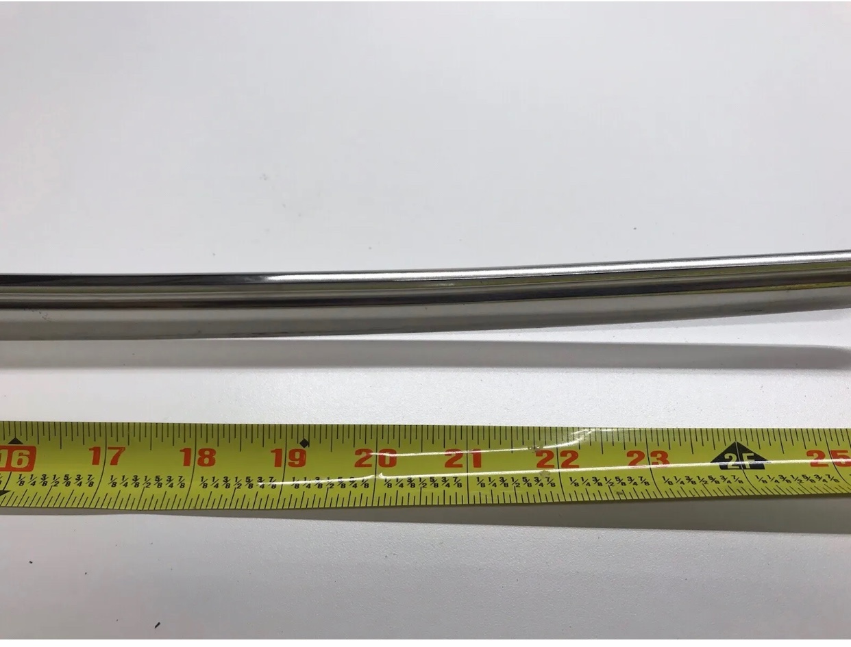

Well.  After reviewing several nakago of Type 95s and Zoheito, I'd have to lean toward John's zoheito idea too.  While the blades and blade tips are almost identical, the T95 nakago are longer, narrower, and lack a fully discernable yakote.  This one has the same shape and look of other zoheito nakago I have on file.
Steve, if this were an officer sword made with a Type 95 NCO blade, it would be a rare one to have in hand, as actual ones are very rare to come by.  If it's a zoheito, then it's not all that rare.  Less common than standard Type 94/98 gunto, but there are plenty of them around the collecting world.
Zoheito were an attempt to mass produce blades for officers during the sword shortage years after switching from the western styled kyugunto over to the samurai styled Japanese swords.  Single piece of steel, not made the traditional way.  The look and feel is almost identical to the Type 95 blade.

1.Star-(Army supplied) Material Inspection Stamp
2.M-Interim Inspection Stamp
3.X Failed Stamp
 The chart you  posted Where I got the 3 stamps from
Bruce already pointed out the w inspection is midway
my guess halfway through the inspection

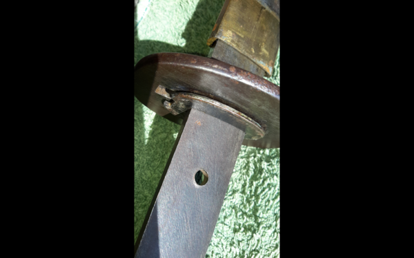

Steve,
I don't see a stamped number on the nakago.  If so, can you show a photo of it?  Or is the "K797" just stamped on the fittings?
Both the tang and all parts of the tsuba are stamped with a matching number: K797
The parts of the tsuba also have an ampersand ‘ &’ stamped on them.

Steve,
Bruce
Another 造兵刀 with number K781 on the Tang , Seppa.
