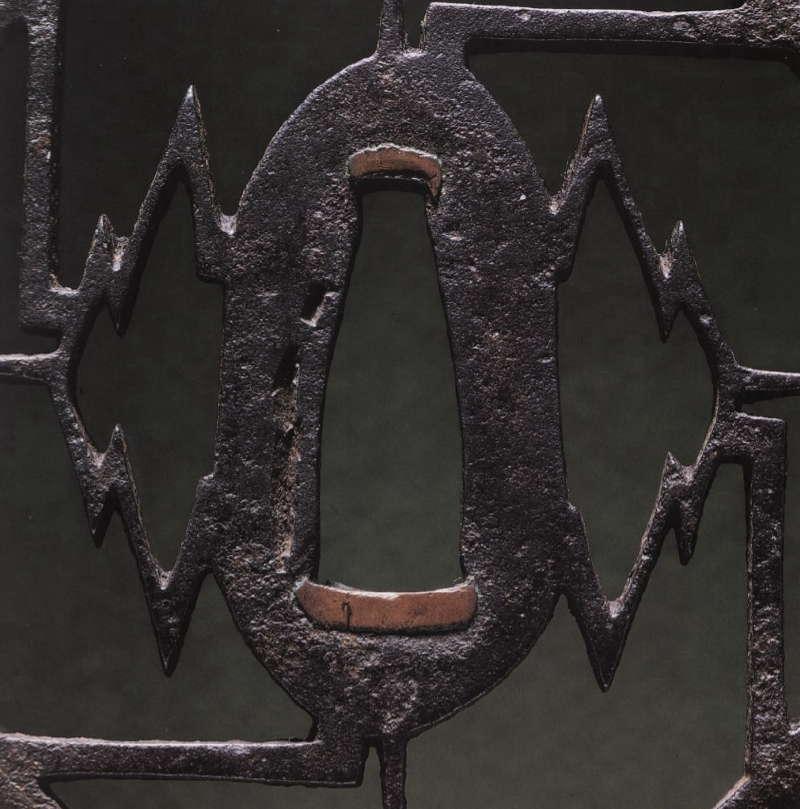

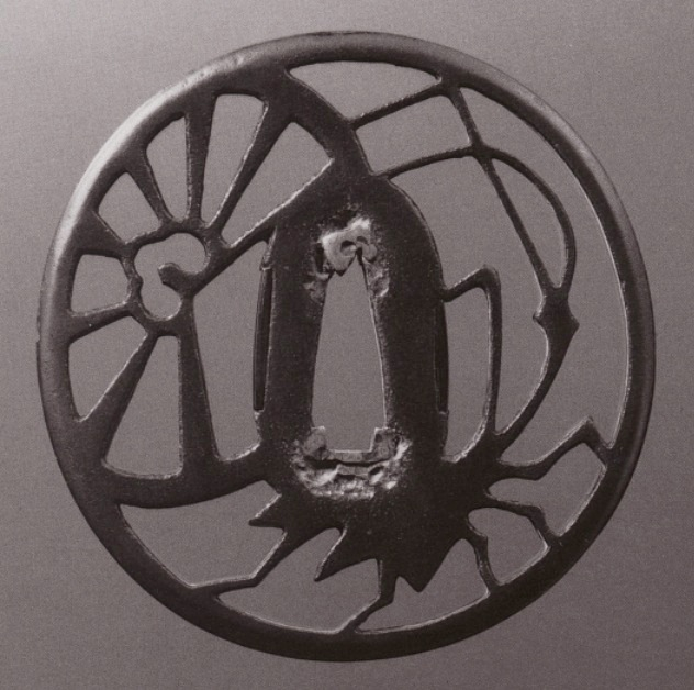

reinhard Posted May 25, 2009 Report Posted May 25, 2009 This may be a little help for understanding and comparison. This tsuba's design origins from the "kuruma ni tohroh"-legend. It is based on a Chinese story of a mantis preparing to attack a cartwheel. It may have been chosen to illustrate the brave attitude of the insect or it may suggest, that it is prudent to avoid meaningless conflicts. - What a great metaphor for what is going on here right now! - Apart from technical questions, this is also a matter of design. I would like to show you, what third master TADATORA made of this challenge and why Shan's tsuba looks like a parody. reinhard Quote
Kevin Adams Posted May 26, 2009 Report Posted May 26, 2009 Thank you for posting that picture, Reinhard - it is very helpful to me in keeping the design portion of this discussion in perspective Quote
Martin Posted May 26, 2009 Report Posted May 26, 2009 Hi all, it might be helpful to see both pieces in direct comparison. The execution of the Mantis on Shans Tsuba is quite clumsy. It is hard to make out its head (compared to the Tadatora example) and the feet are also weakly designed. A Mantis in a most abstract form so to speak :D Nonetheless (having only the pictures to judge) I think it is not a modern copy. The shifting of the Hitsu-Ana is quite commonly seen in Akasaka works and does IMHO not indicate a poor attempt to imitate Akasaka school work. Not least the broadness of the Seppa-Dai and the insinuated semicircular areas at the top and bottom of the Nakago-Ana (prepared to fit the Tsuba to the blade with Sekigane / Kuchi-Beni) makes me guess this is late Akasaka (or Akasaka style) work. Ford, I would be interested in how you can differentiate between iron and steel from the pictures. And maybe another silly question : Is there maybe a connection between material (Steel or iron) and certain Tsuba schools? Best, Quote

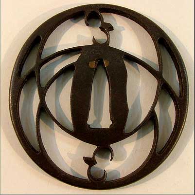

shan Posted May 26, 2009 Author Report Posted May 26, 2009 Guys, Thanks for the comparison. This is a road i have already travelled with Mike Yamasaki and Cyrus Chan. I have and so have they said it is not a masterworks by any stretch. It is pointless comparing mine to the 3rd master and probably one of The best smiths that ever came out of that school and one of his masterworks at that.Thats a beautiful Tsuba Martin,withiut doubt.If i had that i would be happy indeed. But...You may as well compare every blade asked about on this forum , to a Heian Nagamitsu,because it compares badly declare as modern or exceptionally poor quality. It is an established "assumption" that it is not by him or any of the Great ones in any way shape or form and not by any of the masters as early as that.It was the timeline that i was trying to establish. As a way of determining if an item is by a master or specific artist ,this method works well,but pointless when the item in question is so far from anything done by any of them. I have already said it is a very poor works and most agree to this ...unless this was by design. I have never and nor have any others thought this a great Tsuba.But they did think it an genuine piece and from around th 4th 5th or 6th gen It is poorly executed and is nothing like the example (or indeed the ones given me by all the experts)but as the school moved with the times the designs became more abstract at times. What i am at this point trying to establish is why at least 2 people thought it a modern Item made for Ebay sales.(which is not where i got it from sadly ) Beautiful Tsuba though martin. there are others by this smith that are not as good as this and are more abstract as with all others.It depends on what they were trying to achieve. shan Quote
Martin Posted May 26, 2009 Report Posted May 26, 2009 Shan, I did not want to imply, that your Tsuba could be a 3rd Master piece by just showing them next to each other I think it is just helpful to compare the workmanship and design of a Ko-Akasaka Master to that of your piece. And why do you always insist that this is such an exceptionally poor quality piece? Try to enjoy it as it is... (and if that´s not possible - sell it !). Cheers, Quote

shan Posted May 26, 2009 Author Report Posted May 26, 2009 Hi Martin, Thanks for your responses and I think you misunderstood my comments (always hard with the written word) "I did not want to imply, that your Tsuba could be a 3rd Master piece" I was not suggesting you were. I was just saying that placing it next to such a fantastic piece only heightens the fact that it is a poor work by comparison.(if it were me i would say Poor copy or fake straight away) Don’t get me wrong Mine, its Nice enough...Just nothing i would have "written home about". I have been made well aware by any number of experts and novices alike that it is not a great piece and barely worthy of much (if any) consideration or discussion. The story was as i said at first... I saw something similar and approached the owner of this and they said theres was Akasaka and probably Tadatoki maybe 5th-6th gen. I thought i had best research mine (although it was IMHO not as nice as the other) to be sure. I contacted several Big Names and they in turn suggested Bigger names and so on and so on ...and the "general" consensus was that it was most likely Akasaka and could be (opinions differ here) anything from 4th gen to 6th gen+.Not a masterpiece but nice enough. Worse case it was probably possibly maybe perhaps definatly going to get "Akasaka School" at shinsa. Then i contacted another specialist site of Mike Yamasaki and Cyrus Chan, (Mike did say possibly rejected if the panel were in a bad mood due to patination) They did not like the colour and thought it a Later "school" piece that may have been partly or completely repatinated. They showed as you have examples from masterpieces which told me what I already knew and that was that it is No masterpiece.(I have also googled Akasaka) This along with Fords dislike and suggestion of young age, made me cease in any trades and ask the forum what they felt. None of these specialists or experts had until this forum (and ford) Even suggested that it was a modern item. (I cannot tell you if they thought this though) so it has gone from Definatly akasaka and will shinsa to the school at least IMHO...to .....Made last year to sell on Ebay. ............... this is one giant leap from defiantly sending it to shinsa and it being a "safe bet" ...to "don`t wast your money its a Mug/cup coaster". I am just trying now to find out how it can elicit so many near identical opinions from different sources to such widely varying opinions from others. I have asked you all…and it is these opinions that will help me and perhaps everyone to understand the fundamental issues that make an item “right” or Just plain “wrong”. It’s the subtle things I believe that can differentiate a great works from a masterpiece,But this subtlety can also help in other ways… Please do keep spitballing and brainstorming guys its all useful stuff. Quote

shan Posted May 26, 2009 Author Report Posted May 26, 2009 For Reinhard,because If we must compare a master to a possible student... then here is another masterworks but the same smith.Tadatora or maybe Tadamune.Different design but sukashi cut in a similar way.Perhaps this design could have been refined more? Please note,I am not trying to compare my Tsuba to a Master,Just showing that anyone can produce a masterpiece and call all else garbage. Yet there will be average pieces by the same hand. (Image was found on the internet and used as an example only.) regards shan Quote
Markus Posted May 27, 2009 Report Posted May 27, 2009 shan said: Perhaps this design could have been refined more? Are you referring to the one on the right? The design needs no more refining. It is a dynamic representation of the Musashino motif as its best, interpreted according to the aesthetical principles of iki as expected from the Akasaka school. BTW: I have an identical piece in my collection http://en.wikipedia.org/wiki/Iki_(aesthetic_ideal) Quote
reinhard Posted May 27, 2009 Report Posted May 27, 2009 Shan, this newly presented tsuba looks like one of the better works of fourth master TADAMUNE (a similar example can be seen on p.273 of Sasano sensei's book, BTW). I'm not quite sure though, what this is supposed to illustrate. Their design and workmanship are completely different. The new example seems to be well balanced in shape and design and traditionally made (although difficult to tell from a tiny picture alone). Just one more thing for the newbies out there: Judging an iron sukashi tsuba is trickier than it seems. Aesthetics, proportions and design are important as well as technical aspects: surface, including tsuchime, tekkotsu, color and condition of patina and some other aspects have to be considered carefully and should be seen in hands. Some fine tsuba have been deteriorated by careless handling and/or storage, but solid art can stand bad treatment to some extent. A shade of their former beauty, they remain still classy, but the tsuba in question has no quality whatsoever. Neither from a design point of view nor from workmanship's. What should be kept in mind is: Genuine iron tsuba were made by CHISELLING sukashi out of a carefully forged plate. At least some traces of the process and of the basic material should be still visible somewhere. During later Edo period sukashi tsuba were filed, polished and patinated afterwards in sophisticated ways, but if they look like uninspired, chemically treated fretwork, they are almost certainly modern copies. The attachement may help illustrating what I'm talking about. It is a close-up of the early Akasaka tsuba from the Compton collection. Everything about this tsuba is just perfect. Workmanship, steel texture, patina and colour, chisel-marks, color of the seki-gane and so forth. It may give you a reference point. It might be better to let this thread fade, for so many objections have been repeated several times by now, but this is up to the mods, of course. Shan reloaded, as we know him. reinhard Quote

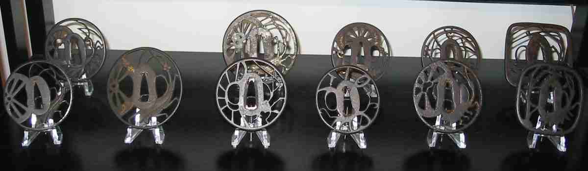

Mantis dude Posted May 27, 2009 Report Posted May 27, 2009 I know this pic isn't great but I consider this shelf to be my akasaka style row. Would really love to have a person of knowledge come and evaluate all my pieces and compare and contrast. I have a feeling it would be a great learning opportunity to compare and contrast all my pieces and styles. Some in the photo haven't been posted yet to the site, I need to add a bunch in many categories. I have another sukashi shelf but that is more choshu/bushu and shoami. Quote
