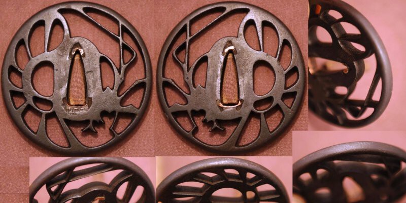

shan Posted May 21, 2009 Report Posted May 21, 2009 I have this Tsuba that i had not researched and one day last week i was browsing the net and saw a very similar one attributed to Akasaka sukashi Tadatoki 4th Generation. Not knowing anything about this area of sword fittings, i also asked a few people by email what they thought of it and it came back as. its a mantis and wheel theme that akasaka were known for in an abstract form.Most thought it without doubt Akasaka and many thought one of the middle Tadatoki smiths. "Their workmanship shows a combination of Kyo-sukashi and Owari-sukashi first then adds a taste of the Hayashi school of Higo tsuba later.Their tsuba is relatively thick and then has round mimi (outer line) and a little large hitsu-ana also powerful ke-bori carving is done on it." Some liked the item although one thought it rather "roughly made" and another thought it possibly a middle tadatoki work but when he was studying (not yet a master). Some loved it.Felt it would paper to Akasaka no problem and it was a good Tsuba and later tadatoki 5th or 6th gen. and recently one thought it modern Junk. All opinions were "Not in hand" so i cannot quote anyone without permission. I would love your opinions on this "good or bad" as the "jury is still out" on whether this is Nice or complete Junk. I had some interest in it from several people, but wanted to "hold off "until i could be sure it was what i was selling it as. The Photo colours are not consistent sorry,I have also gently cleaned some wax and stuff from it since these images were taken. Many thanks Shan Quote
paulb Posted May 21, 2009 Report Posted May 21, 2009 Shan, without any pretence of expertise in this field I would make the following comments: 1. I like the design very much and it looks to have similarities to many Akasaka tsuba I have seen before on various websites and in hand. 2. I don't see any basis for considering it to be "modern junk" 3. The texture of the iron in the rim looks interesting and sort of what I would hope to see. 4. I am a little concerned with the flatness and colour of the inside surfaces if the design as they lack the rust I would expect to see and show no signs of layering which can occasionally be seen in Akasaka work. Overall I think it is a good design and based on the main photos a good colour (is the silver on the photos around the nakago-ana reflection or bright metal?) I sure those with a lot more experience in this field will enlighten both odf us. regards Paul Quote
Ford Hallam Posted May 21, 2009 Report Posted May 21, 2009 hmmm...I think I would have been even more convinced in my opinion had I been sent these much clearer images. I never suggested junk but as far as I can tell this is plain mild steel and the work of an amateur. Not much older than 50 years. I would like to point out that anyone can make a plain steel cut-out based on a picture in a book so I would suggest that any considerations based on the actual design are irrelevant if the steel itself doesn't support that attribution. my email reply; Quote it's hard to make absolute statements on pieces like this especially based only on some images but for what it's worth these are my thoughts. At first glance I would think of Akasaka. I assume you know the motif that this is based on.... the other possibility would be a Higo province copy but this seems unlikely to me due to the lack of character in the steel. As you can see your version has been abstracted quite a lot. Now this is something the Akasaka school probably did ( this abstraction) better then any other group. Personally, I think they were quite influenced by fabric designers in the then cosmopolitan Edo, their sense of design is quite unlike any other school in this respect...but that's another essay Having pointed out the abstraction I have to also say that in this case it seems as though the maker has lost sight of the original work and so has ended up with shapes that don't really fit together very well. If you imagine making a tracing of the original and then making a tracing of the tracing etc, etc , etc you end up with something that has lost its design integrity. This has clearly happened here. In my experience this is less likely to happen when the maker is a professional...some of the piercings don't line up perfectly and some of the shapes are a bit awkward also. There are a couple of aspects, like the point that pokes into the space that would accommodate the kogai, that make me feel this maker didn't instinctively understand a tsuba's function and merely copied a shape. This is why I would suggest an amateur made this....probably sometime in the last 50 years. The steel is very plain, from what I can see and although Akasaka work in the later periods is very tightly forged and refined steel there is always some texture to the plate...here it seems to lack any defining features at all. not much more I could say...but I hope I've provided some food for thought at least. Quote

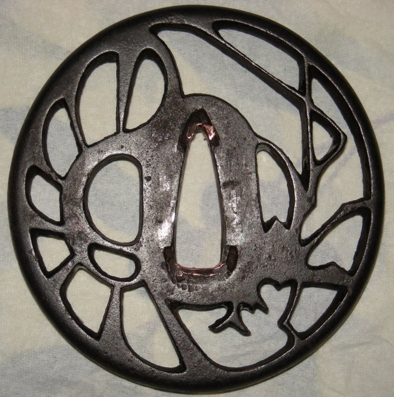

shan Posted May 21, 2009 Author Report Posted May 21, 2009 This is probably not going to make any difference but i will post an image i took in daylight with no flash. for reference shan Quote

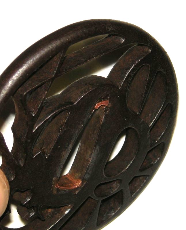

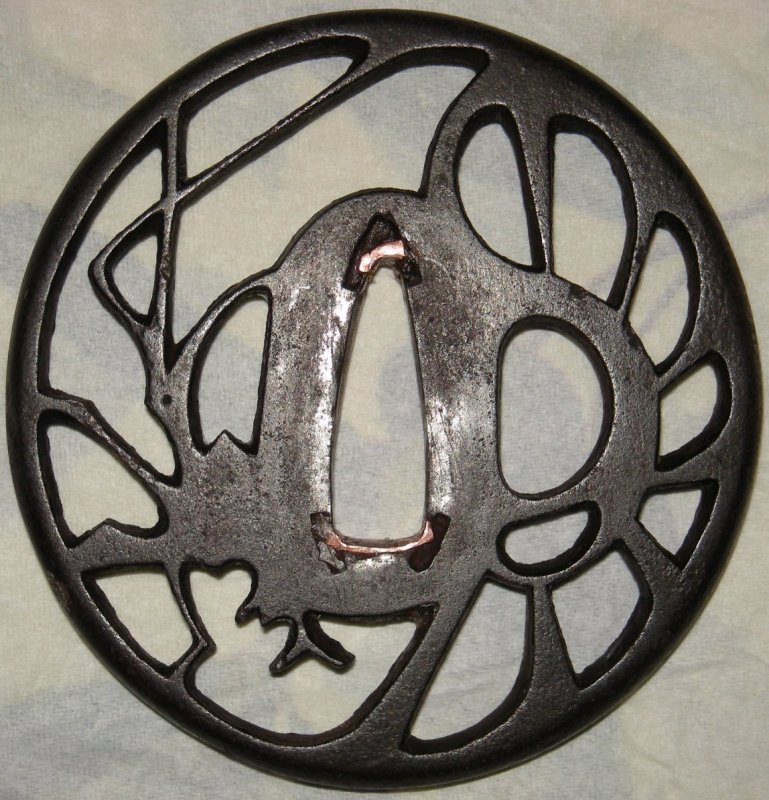

shan Posted May 23, 2009 Author Report Posted May 23, 2009 Hi,Requested updates. the dimensions are: 7.2mm at seppa dai 6.2mm at Mimi 73.5mm across the hitsu ana 75.5mm down the nakago ana. I have also added these images taken in "natural" light.(although they still look different to the eye than the lens in some). perhaps they help....perhaps they hinder. First is a more natural look to the Tsuba and texture is better. second is a better image of the rust in the sukashi. Then there is the mimi then lastly these strange images of Layers in the nakago ana Thanks shan Quote

Rich T Posted May 24, 2009 Report Posted May 24, 2009 I think this is, based on the last images, a middle to late Tadatoki tsuba (1700's - 1800's) and not modern at all. I have to disagree with Ford and co. Shan, send it to the NBTHK and see what they say. Prove all wrong (or right) LOL. Rich EDIT: looking back at the last lot of photo's, I am going to keep my dates, but might consider a Shoami copy of Akasaka. Quote
Ford Hallam Posted May 24, 2009 Report Posted May 24, 2009 Quote reinhardare you suggesting the tsuba is a cast one? nick I can't speak for Reinhard but those marks inside the nekago ana look suspiciously like an "as cast " surface. The copper sekigane looks bright as a new penny too....and as rough as a goats knee On the basis of this new evidence I'd like to revise my initial opinion and suggest this is much newer than the 50 years I first thought. I now believe this to be a cast steel tsuba, possibly made from a mould taken from an original but the great thickness makes me think otherwise, cast metal shrinks so does the wax model generally used to make the mould so that would mean an even thicker starting point. It's probably no older than ebay. night night, Ford Quote

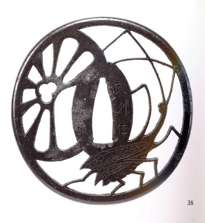

Ford Hallam Posted May 24, 2009 Report Posted May 24, 2009 Further research, a close comparison with the steel texture and colour of this example as well as an apparently similar manufacturing process point towards this group. Here's a link. Quote
reinhard Posted May 24, 2009 Report Posted May 24, 2009 I agree with Ford. Thickness of the tsuba, its plain surface, sharp angles along the sukashi-ridges, lack of any kind of tekkotsu, brightly shining parts of seki-gane while others look artificially patinated, strange structures within the cross-sections of the bars/nakago-ana and other features make it look suspicious. This tsuba was probably cast, but I'm no metallurgist. - It contains many features of the huge amount of modern sukashi-tsuba flooding the market recently. They look nice at first glance, but won't stand expertise. Maybe I'll be proven wrong. reinhard Quote
