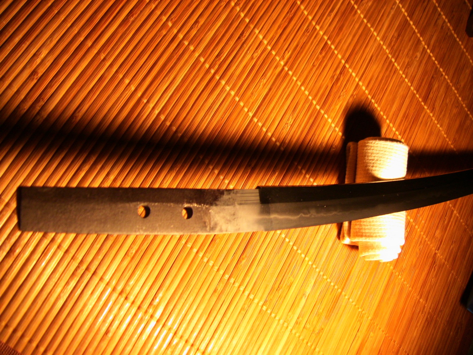

swordnoob Posted September 14, 2022 Author Report Posted September 14, 2022 On 9/14/2022 at 5:48 PM, Alex A said: Hi Victor, difficult to tell from that image This might help, see the images. http://www.ksky.ne.jp/~sumie99/suriage.html Expand Hi Alex, The hamon is sort of like this. Or were you referring to something else? Quote
Alex A Posted September 14, 2022 Report Posted September 14, 2022 Just difficult to see in that image, but now you draw those lines then yes it does go past. In the link i sent you, the third photograph down shows it clear, what i normally look for . Cheers. Quote
swordnoob Posted September 14, 2022 Author Report Posted September 14, 2022 To be honest, I can't tell whether the hamon goes past the hamachi in that photo or whether that's some polish. Is it at the blue line or the red line? Quote
Alex A Posted September 15, 2022 Report Posted September 15, 2022 Hi Victor, only have a few minutes, Its the blue line. Sometimes, can be real difficult to see but quite easy really in that image. Sometimes the shape of the hamon dont help. The nakago is heat treated to remove the hamon so it can be reshaped also. I dont see any reason why folk willing to try cant get to the bottom of this regarding school, trouble is it can be really time consuming, especially if your not familiar with the work. Look at the school Jacques mentioned, try find a match for hamon and boshi, the hamon is very bright. At the moment, im kind of on the end of the Muromachi going into Edo. Cant ignore that nakago chop and the masame, your sword is full of it in the Shinogi-Ji. Also the mention of dark steel, i will try add a pic of that for you when i get time. After the Muromachi period Mino smiths moved elsewhere and set up shop. It can get confusing as you see older traits mixed with new stuff. Ie, Masame mixed with Mokume. So, i would maybe be looking at smiths like Owari Seki, where you see mokume mixed with masame and also notare mixed with Sanbon-sugi. Early, and just a few thoughts. Maybe look into that school and see if anything comes up online or other Mino offshoots. Ps, not ruling out anything yet, as dont know for sure. Too easy in this game to assume and get it wrong, then make a complete plonker out of oneself online, quite good at that Cheers. Quote
Jacques Posted September 15, 2022 Report Posted September 15, 2022 On 9/14/2022 at 5:56 PM, swordnoob said: Hi Alex, The hamon is sort of like this. Or were you referring to something else? Expand Ok, it's ubu. That one is suriage Quote
Alex A Posted September 15, 2022 Report Posted September 15, 2022 Actually, now looking at the red lines you draw, strikes me as unusual seeing a gunome pattern there. Makes me wonder about the hamon in that part of the blade. can we really call it Yakidashi? Wonder if polish has had an effect in that area of the blade maybe Quote

Jacques Posted September 15, 2022 Report Posted September 15, 2022 On 9/15/2022 at 1:12 PM, Alex A said: Hi Victor, boshi good for Owari too, no kaeri, just noticed by chance on a quick search. https://www.aoijapan.net/wakizashi-mumei-owari-seki/ Connoisseurs states Ko Maru for Owari. Cheers Expand The comparison is not relevant this waki is possibly a naginata naoshi one. Victor Quote Do you have any others photos of suriage blades with the hamon much closer to the ha Expand It wouldn't add anything. What you need to see is the exit of the hamon in relation to the width of the hamon further in the blade. In the case of a suriage nakago, the hamon will enter the nakago at the same level as the one we will see 10 centimeters before (see the picture I posted). Your sword is ubu and Shinto. Quote

swordnoob Posted September 16, 2022 Author Report Posted September 16, 2022 On 9/15/2022 at 2:33 PM, Jacques D. said: The comparison is not relevant this waki is possibly a naginata naoshi one. Victor It wouldn't add anything. What you need to see is the exit of the hamon in relation to the width of the hamon further in the blade. In the case of a suriage nakago, the hamon will enter the nakago at the same level as the one we will see 10 centimeters before (see the picture I posted). Your sword is ubu and Shinto. Expand Hi Jacques, thank you for clarifying. I think I understand what you mean now. You'd see the hamon continue further in the nakago whenever there's suriage as that's where it originally was prior to shortening (assuming there wasn't some heat treatment that happened during shortening). I guess the only counter example I can think of is if the hamon wasn't wider than the width of the hamachi (I'm not sure if any swords were made that way) Alex, David, and Kirill. Thank you for the shinsa suggestion. I assume you're referring to https://nthkamerica.com/? Quote
