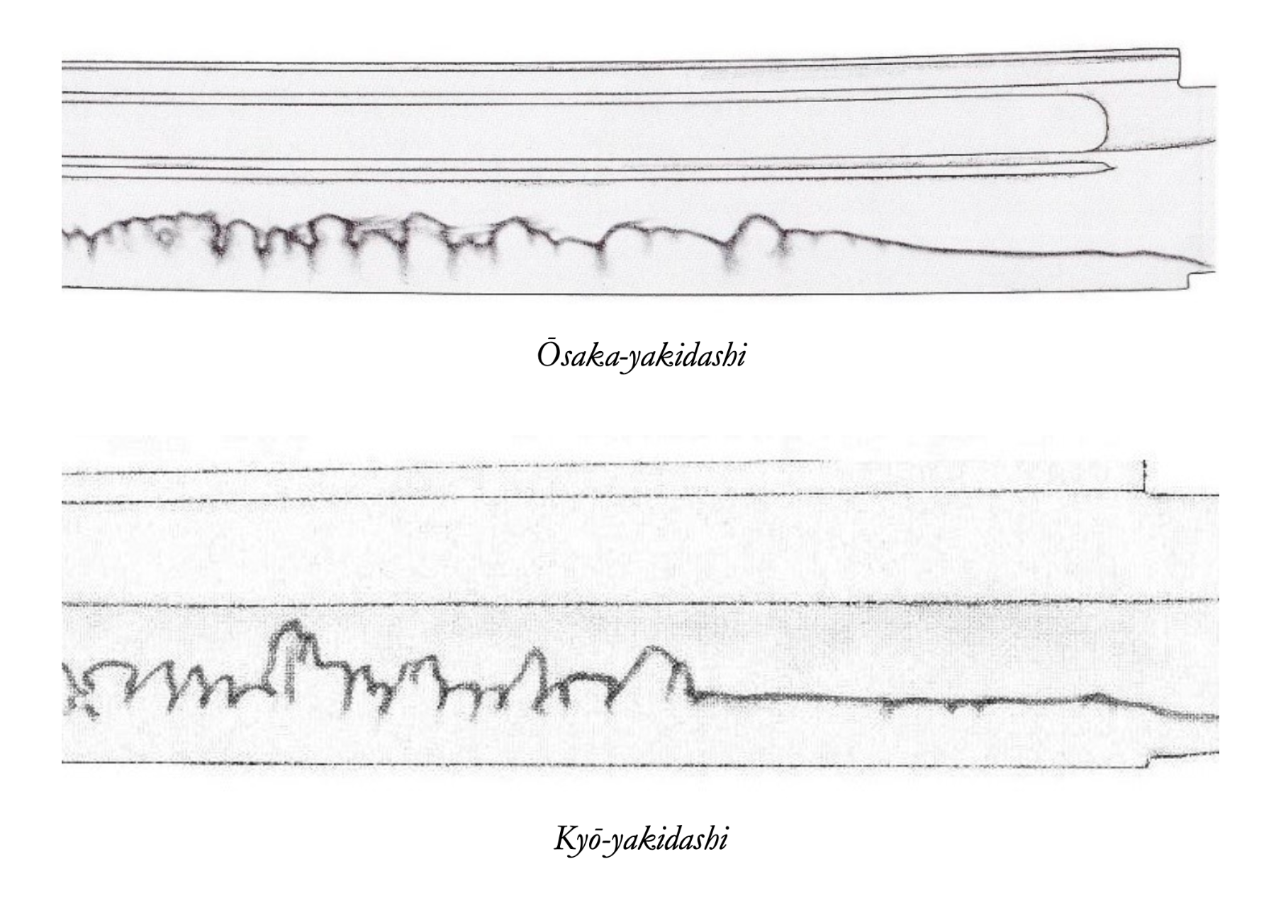

francois2605 Posted September 8, 2022 Report Posted September 8, 2022 On 9/8/2022 at 9:46 AM, WellsFargo said: hamon which started with a straight line from before / under the hamachi and then gently progressed into gunome midare Expand My 2 cents: the technical term for this is yakidashi. From Markus Sesko's Encyclopedia of Japanese Swords. Quote yakidashi (焼出し) – The beginning of a hamon around the ha-machi. At unshortened blades, the hamon usually runs a little bit into the tang. There are different interpretations of this starting of the hamon and we basically distinguish between the following forms: sugu- yakidashi (直刃焼出し), straight start which turns after a more or less short distance into the “actual” hamon; Ōsaka-yakidashi (大坂焼出し), also starts straight or as gentle notare but the yakiba widens smoothly to turn into the “actual” hamon; Kyō-yakidashi (京焼出し), the yakiba starts in suguha but turns then rather abruptly into the “actual” hamon; Mino-yakidashi (美濃焼出し), the yakiba starts with a koshi-ba; Satsuma-yakidashi (薩摩焼出し), term to refers to Satsuma-shintō blades where the hamon starts like at most kotō blades right away as midareba. Expand 2 Quote
