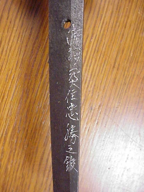

As it happens I have my first question regarding a translation that I am some dificulty with. I have been able to decipher the following characters:
1-7 numbered from tip of blade to bottom:
1-?
2-?
3-?
4- ju
5- chu
6- katsu?
7- kore
8- saku?
Any help on the translation and on the smith would be greatly appreciated.
Thanks in advance!
John
Hi John,the last 5 characters read as follows:
ju Tadakatsu kore kitau
The last 2 characters "he who has made this".
Tadakatsu was a Showa swordsmith from Seki/Gifu,who worked for the army during the war.Hawley gave him the TAD 64.He is not mentioned in Slough's Oshigata Book.
Ludolf,
Thank you very much for such a quick reply. One of the things I must do is get the Hawley book.
"Hawley gave him the TAD 64" Since I do not have the book available can you tell me if this would be a mediocre rating for a smith?
Thank you!!!!
John
TAD 64 is an index # in Hawley's, meaning he is the 64th smith listed who signed with the 1st character "Tada". Hawley lists him at 8 points, which is at the low end for that book. The point ranking numbers in Hawley's are often meaningless. Don't worry about the points; study the blade.
