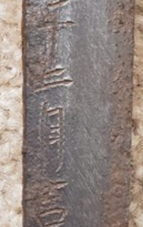

Can't make out the first kanji properly. Anyone?
x-shu ju Kanehisa?
Looks like it's dated second month Tenpo something....maybe 6th year  of Tempo meaning 1835? Somewhere close to 1830 anyways.
Yes, 1831.

you see a 2 for that 3rd kanji making it 1831?
Two strokes, 2 'arrow head points'

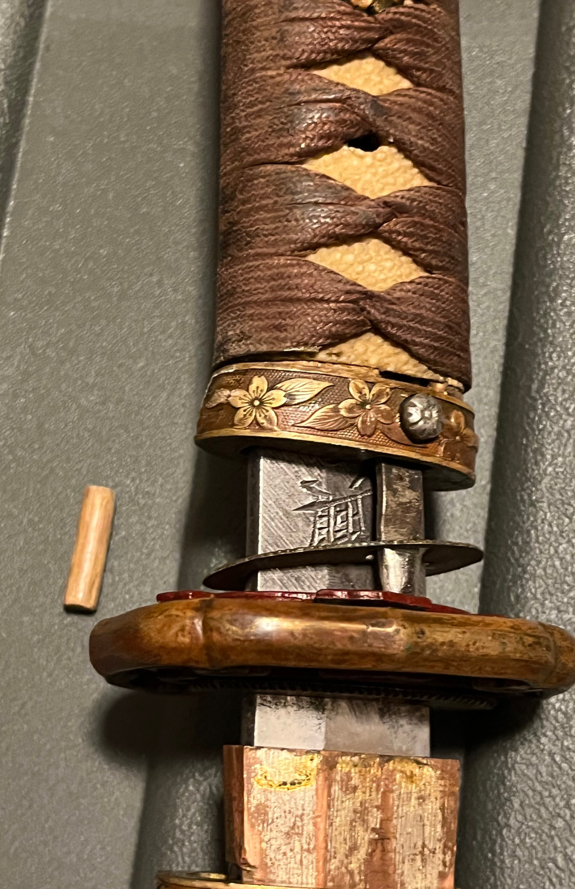

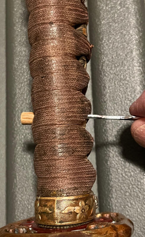

Jonathan,
Your concerns are normal for someone not used to doing these things.  I can assure you, though, these swords were made for easy disassembly and cleaning.  There is one small bamboo peg (mekugi) horizontally placed through the handle and tang (tuska & nakago) that holds everything on.  Simply push that peg out, sometimes they are tapered and only come out in one direction, and everything else slides right off!

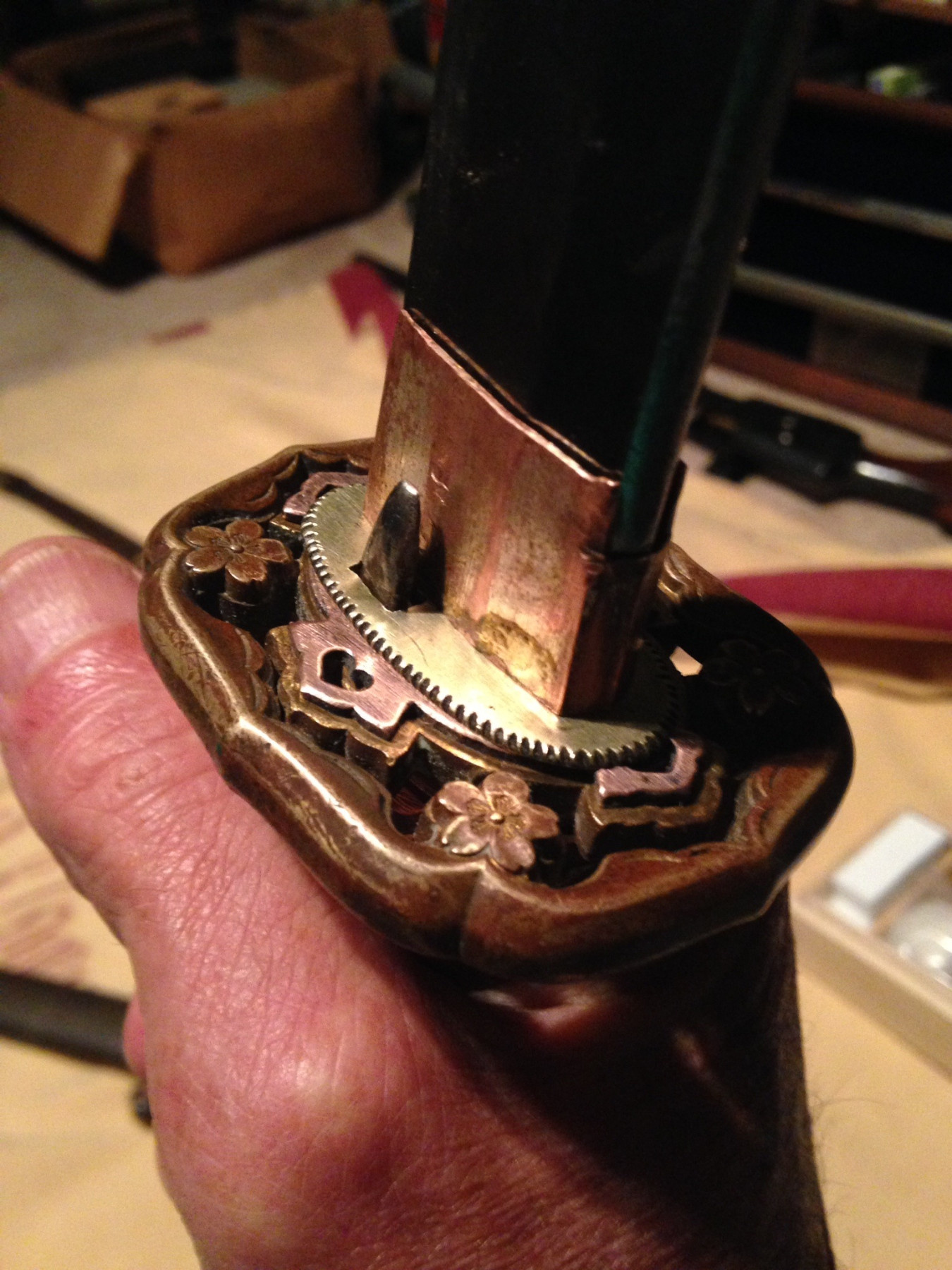

As to adding seppa, this is always difficult to answer.  I've had a number of my gunto that needed extra seppa, over the years.  I bought a bag of 8 or 10 seppa and picked out the ones that looked good and fit.  The rest I've given away already, or I'd send them to you.  I checked ebay and didn't see any WWII seppa currently for sale.  You could try posting your need for seppa on the Want to Buy forum.   Dan Watson, at Crimson Mist Military Antiques has a bunch of them, but he's asking $20 each!  I've been able to haggle a bit with him, though.  The difficulty is getting something the right size.  You could ask him if he'd send you a bunch, let you pick the ones that you like and send the rest back to him.  Don't know if he'd do that, but wouldn't hurt to ask.
There are guys at NMB that carry parts, too.  Don't recall who they are though.
I should add that the number of seppa can range from 2 to 8.  Here's an example from the Ohmura site:
