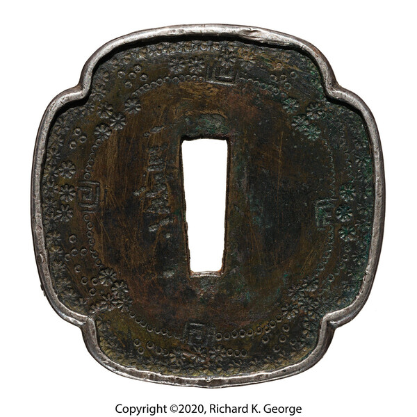

Kamakura period tsuba - silver fukurin may not be original.  kind of plain, but I hope it helps.
Best,
rkg
(Richard George)

Kamakura-bori style tsuba have little to do with the Kamakura period.
The "wood carving style of the Kamakura period" tsubas do not => tsubas from Kamakura period. Careful with that.
RKG's tsuba is actual Kamakura<->Nambokuchu.
Curran is right - the Kamakura in Kamakura-bori is from the place name and not the time period. Chinese style, cinnabar lacquered wood carving is a local specialty in Kamakura to this day - the name I believe is a later appellation given the close appearance and likely inspiration from Kamakura style wood carving...

The wooden tsuba is an unusual piece, it looks incredibly awesome and cursed at the same time.
