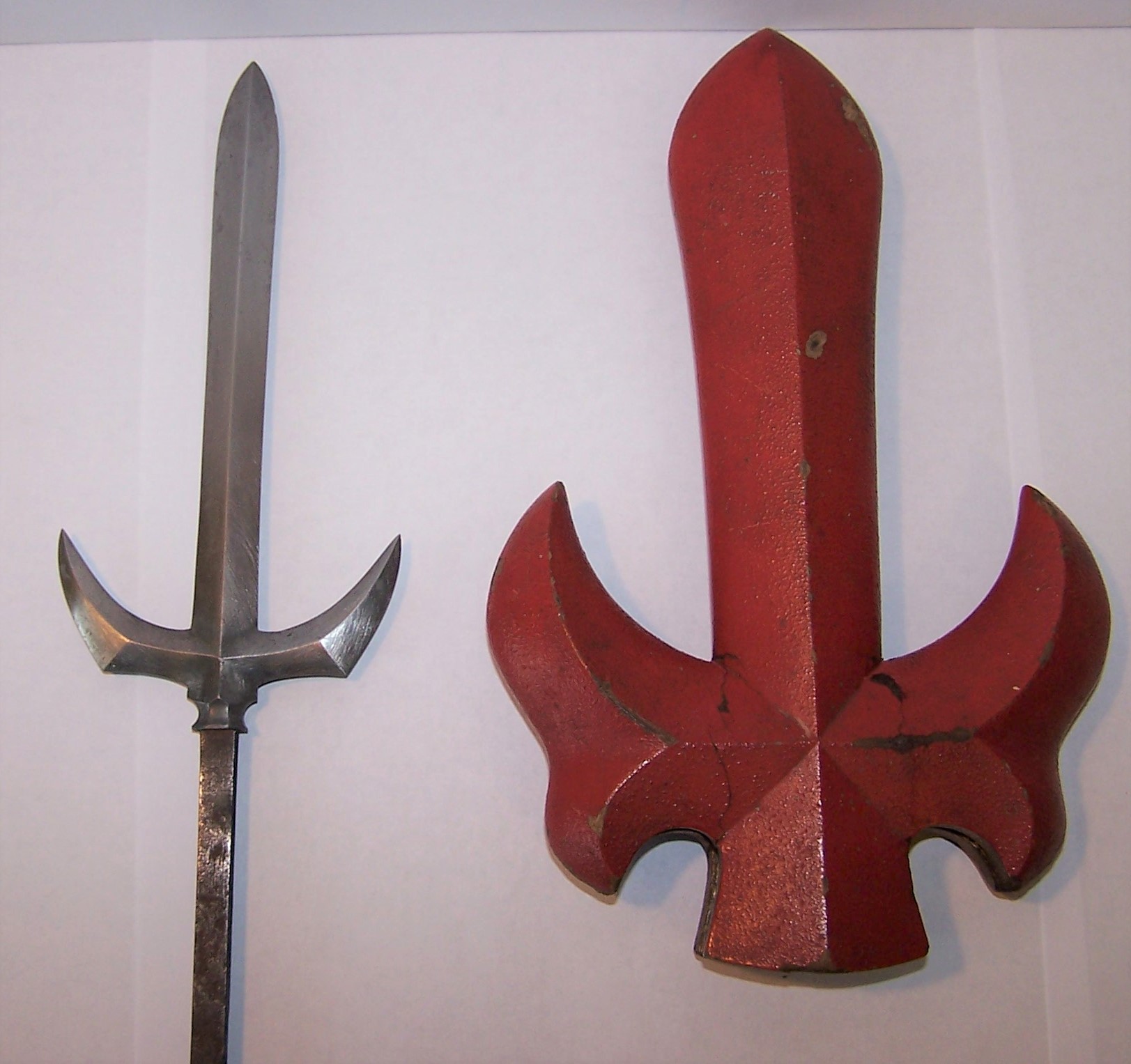

hddennis Posted August 29, 2022 Report Posted August 29, 2022 Another yari follwed me home again. I could use help on who made it. Thanks in Advance,] Howard Dennis 1 Quote
Nobody Posted August 30, 2022 Report Posted August 30, 2022 美濃守藤原政常 - Mino no kami Fujiwara Masatsune 2 Quote
hddennis Posted August 30, 2022 Author Report Posted August 30, 2022 Nobody, Thank You for translating that for me. Howard Dennis Quote

hddennis Posted August 30, 2022 Author Report Posted August 30, 2022 Thanks Geraint, actually I just happened across this accidently while doing an online search for Japanese antiques. I really would like to see it in polish but have heard so many horror stories about trying to get it done I really don't know what to do next. Howard Dennis Quote
NewB Posted August 30, 2022 Report Posted August 30, 2022 43 minutes ago, hddennis said: Thanks Geraint, actually I just happened across this accidently while doing an online search for Japanese antiques. I really would like to see it in polish but have heard so many horror stories about trying to get it done I really don't know what to do next. Howard Dennis Hello Research 'Togishi in the US'. I've heard of Robert Benson out of Hawai, Ted Tenold (here on the forum) and Woody Hall (Bob Benson's student, out of Vegas). There are few more names that my mind can't reproduce at the moment. Japanese blades HAVE TO BE polished by traditionally trained polisher. Any other attempt will ruin the blade - period. Until then keep it lightly oiled (the forum has info on that) and do not attempt to do anything to the steel whatsoever (no touching, swinging, hitting etc)! Cheers J&U Quote
hddennis Posted August 30, 2022 Author Report Posted August 30, 2022 Thanks Darkcon, I was going to check with Robert Benson first. He did a beautiful polish on a Muromachi Kunimune hitasura tanto for me a few years ago but I don't know how he feels about doing a yari. Howard Dennis 1 Quote
Franco Posted August 30, 2022 Report Posted August 30, 2022 Beware when looking for a polisher that you'll want to find one who is not only an excellent polisher, but also qualified to do yari. Not all polishers have the proper training. Also, you can expect the polish to be a bit pricey with so many surfaces to polish Quote
NewB Posted August 31, 2022 Report Posted August 31, 2022 4 hours ago, hddennis said: Thanks Darkcon, I was going to check with Robert Benson first. He did a beautiful polish on a Muromachi Kunimune hitasura tanto for me a few years ago but I don't know how he feels about doing a yari. Howard Dennis As Franco D mentioned below reaching out and conversing with the project would let you know whether they'll take on the task. Some of them refuse katana and wakizashi should they feel the outcome isn't in the best of the interest in both parties. Lovely detail of his polish Awesome J&U Quote
hddennis Posted August 31, 2022 Author Report Posted August 31, 2022 11 hours ago, Darkcon said: As Franco D mentioned below reaching out and conversing with the project would let you know whether they'll take on the task. Some of them refuse katana and wakizashi should they feel the outcome isn't in the best of the interest in both parties. Lovely detail of his polish Awesome J&U In defense of Robert Benson's skills's I have to add that the white spots are uchiko I failed to notice before taking those pictures. Howard Dennis Quote
