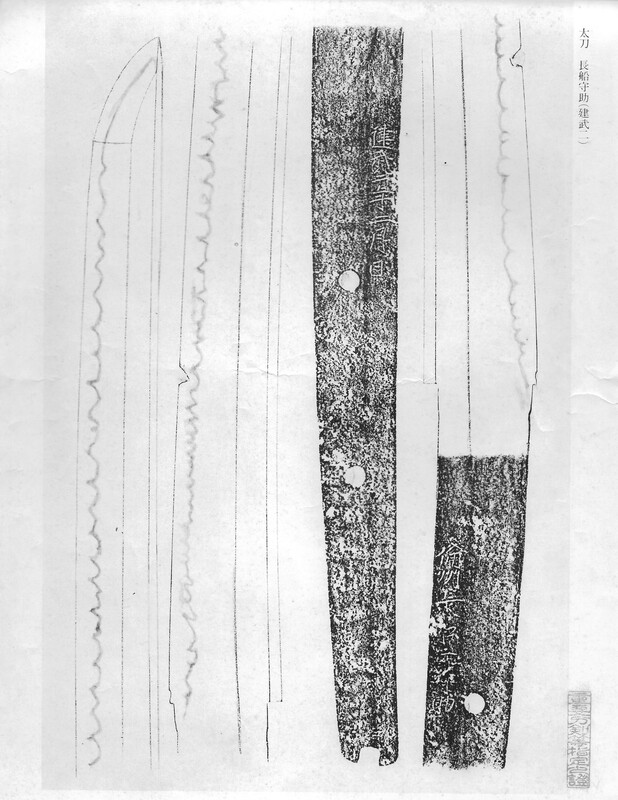

Toryu2020 Posted September 4, 2022 Report Posted September 4, 2022 Ubu, zaimei, dated 1335, 87.7 cm I'd say that's a fully realized Nanboku-cho shape at a time we'd call "Early Nanboku-cho"... -t 2 Quote
