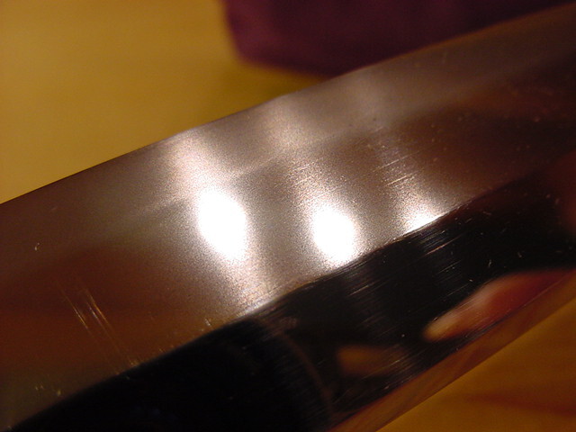

Ted Tenold Posted May 13, 2009 Report Posted May 13, 2009 I'm not convinced this is a hand forged blade. It would take more than just these images to define it, but most hand forged blades will have more attentive finishing of the nakago. Smiths are a pretty methodical breed that believe finishing a sword means finishing the nakago as well. Doesn't mean it's not water quenched either hand forged or not though. I'd also say that industrially produced monosteels when highly polished, can exhibit some pretty conspicuous "hada-like" grain in them. It's a product of the rolling and milling process incidentally called "mill grain". It can be quite convincing (or deceiving) too. Alloy banding formations can also look like small kinsugi or chikei like activity too. Mantetsu and Dairen swords often exhibit this hada"esque" feature and look very similar to that on Hizen blades. Some are courser and some very very fine. I had one SMR gunto with long strands of running itame and masame throughout the whole blade. Those swords were not hand forged, but produced by an innovative electrolitic process. Here's two images of a Koaisshin blade. Quote

Gunome Posted May 13, 2009 Report Posted May 13, 2009 Hello, I'd also say that industrially produced monosteels when highly polished, can exhibit some pretty conspicuous "hada-like" grain in them. (...) Mantetsu and Dairen swords often exhibit this hada"esque" feature and look very similar to that on Hizen blades. Some are courser and some very very fine. (...) Those swords were not hand forged, but produced by an innovative electrolitic process. Does these swords had any stamps (showa, seki) ? Thanks Sébastien Quote

Ted Tenold Posted May 13, 2009 Report Posted May 13, 2009 Does these swords had any stamps (showa, seki) ? No, I have not seen any that have any mark other than what the SMR factory placed on them. There is an assembly number stamped on the nakago mune, the SMR logo with date (on early production) or the standardized "Koaisshin Mantetsu Saku" inscription with date. Quote
