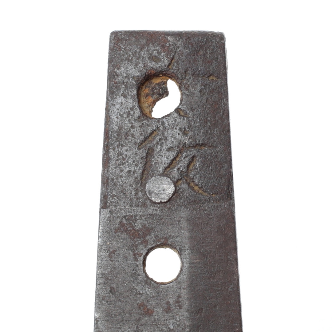

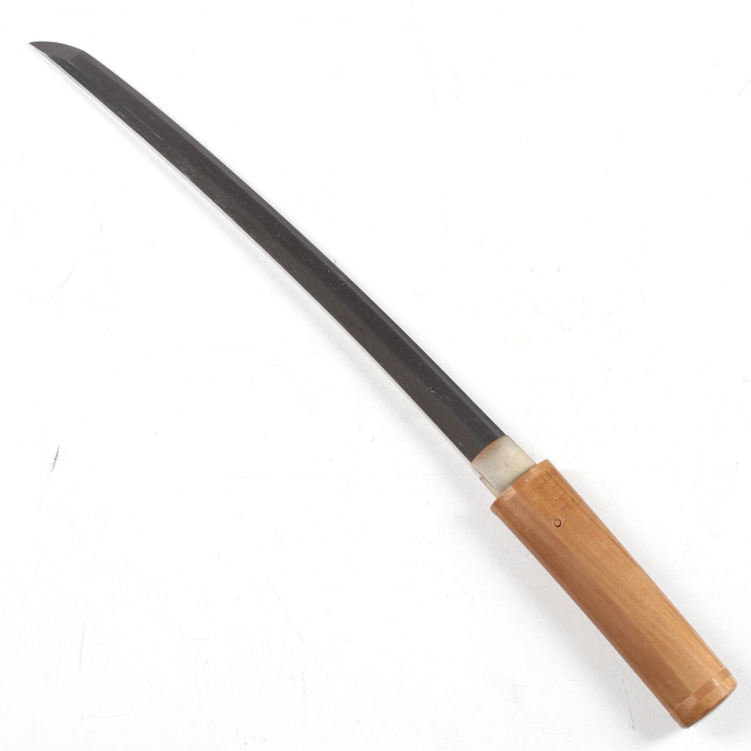

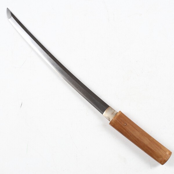

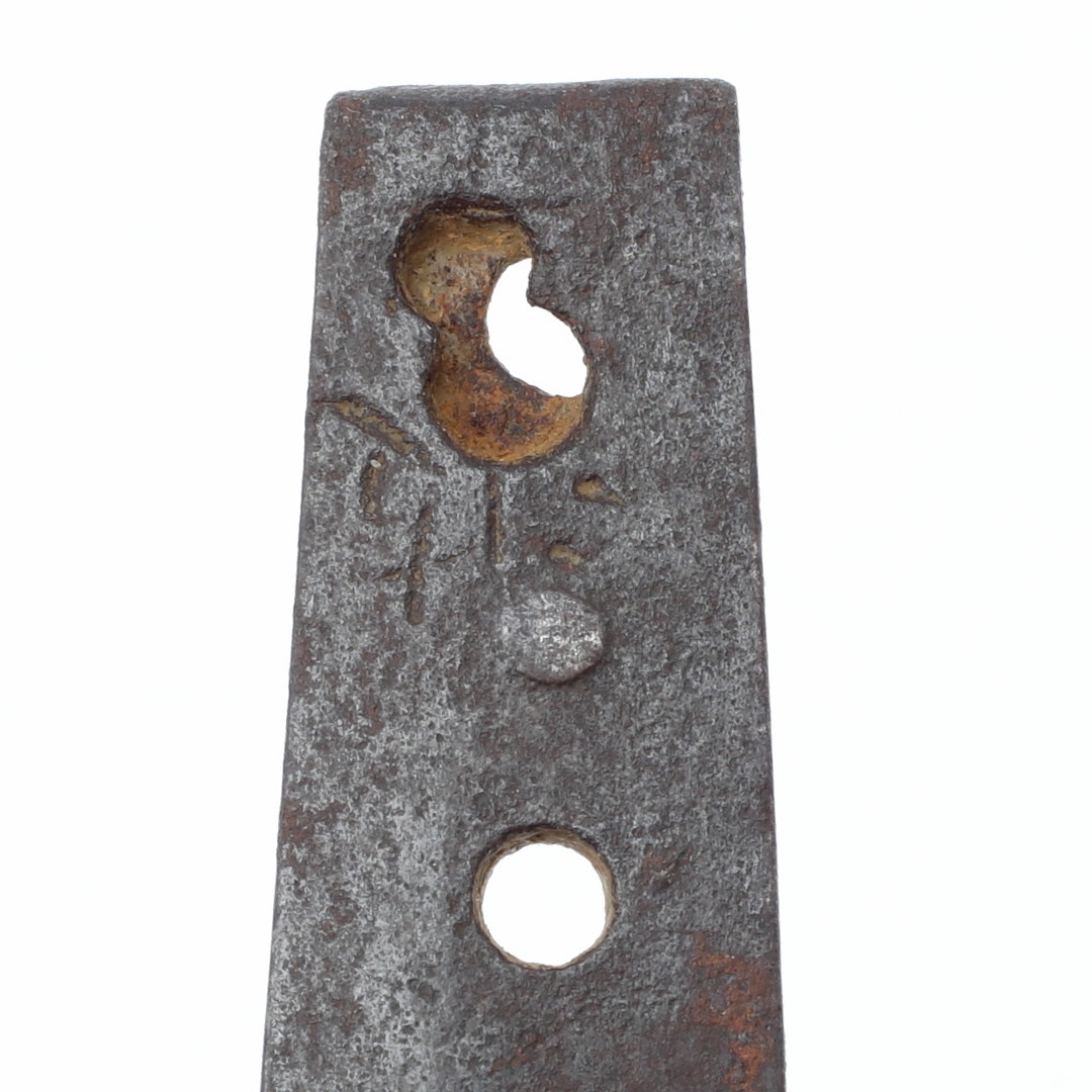

Caracal Posted August 24, 2022 Report Posted August 24, 2022 Need help! This sword is up for auction. Does anyone know anything about the smith - Masachika 正近, and the school Naminohira 波平 in the region of Satsuma 薩摩 and the active period of the smith. I can't find anything?? Quote

Geraint Posted August 24, 2022 Report Posted August 24, 2022 If the nagasa is now 35.6 cms then even when first made it would only have been about 40cms, so we are looking at a shinogi zukuri wakizashi of about 40cms. Might just fit with Oei? Doesn't mean it's not a nice blade and after all you would not be buying the sellers opinions on this one. All the best. Quote

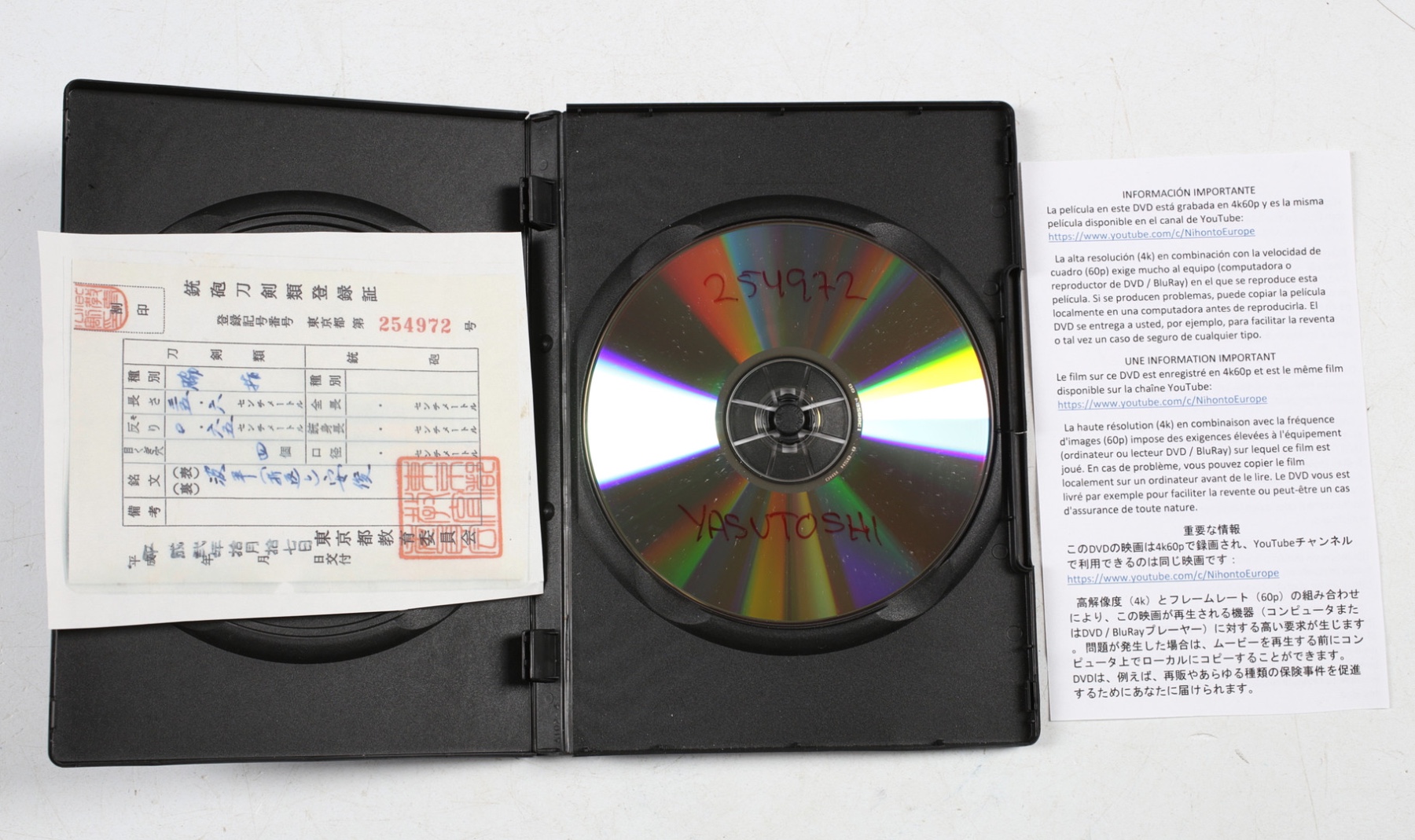

Baba Yaga Posted August 24, 2022 Report Posted August 24, 2022 The CD with the registration is a good touch for establishing valid price and authenticity that not there. 1 Quote

SteveM Posted August 25, 2022 Report Posted August 25, 2022 The swordsmith with that name does exist. He's the one noted by Marius in the post above. This sword has been cut down from its original size. The part of the original nakago with the name on it was preserved, and this piece was bent back and now forms part of the new (shortened) nakago. Its called "orikaeshi mei". Its not so unusual. Whether the signature is authentic or not requires more training and resources than I have. This sword should exhibit "ayasugi hada", if it is an authentic Yasutoshi, but you can't see much of the hada with that video. Also, the video states the item is a sword, but the length actually means it is classified as a wakizashi, which is noted on the registration card. Quote
DoTanuki yokai Posted August 27, 2022 Report Posted August 27, 2022 I would like to see the bent over part from the side but from what I see it does not look legit. Quote
Ken-Hawaii Posted August 27, 2022 Report Posted August 27, 2022 Where is a photo of the bare blade, ao sugata can be determined?? The mei is the last feature you look at. Quote
