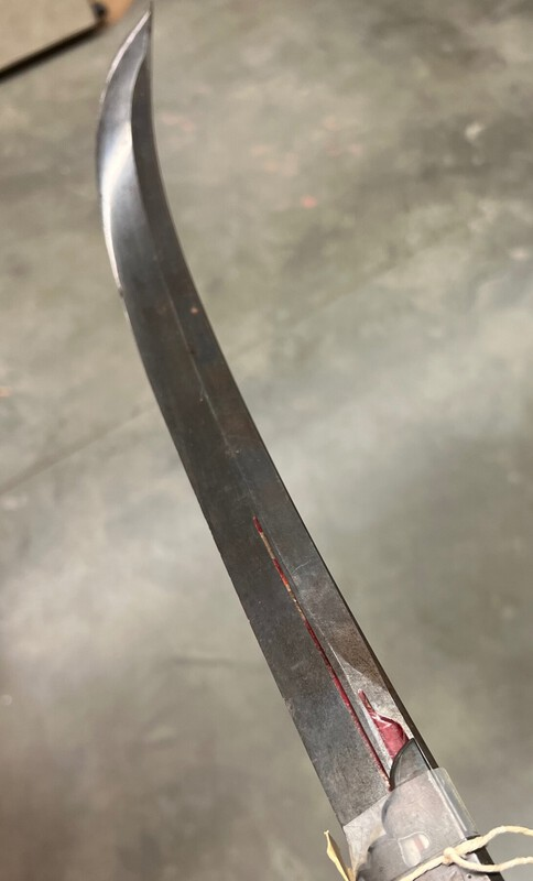

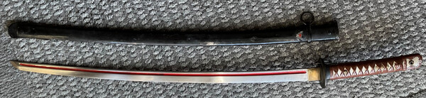

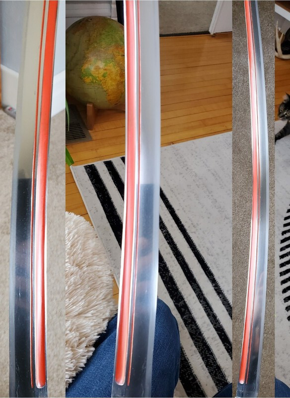

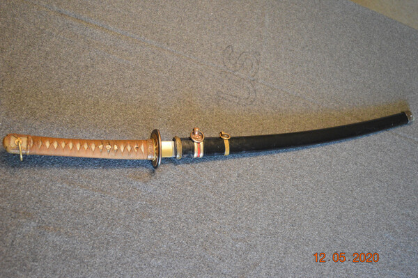

Urushi is found swords, yari, and other edge weapons of centuries past, and the topic is discussed on several NMB threads.  I'd like to link them together for future searches and discuss the practice of whether WWII soldiers (or shops) adorned gunto with it.  Until recently, not knowing much about the practice of old, when I saw it on gunto my first reaction was "Bubba job!".  But after getting the privilege of seeing a Type 95, in hand, with a full urushi treatment, I'm convinced that this one, at least, and possibly others we've seen are wartime done.

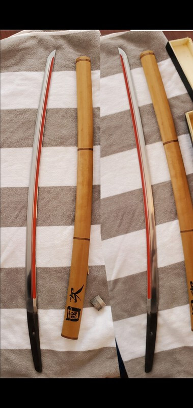

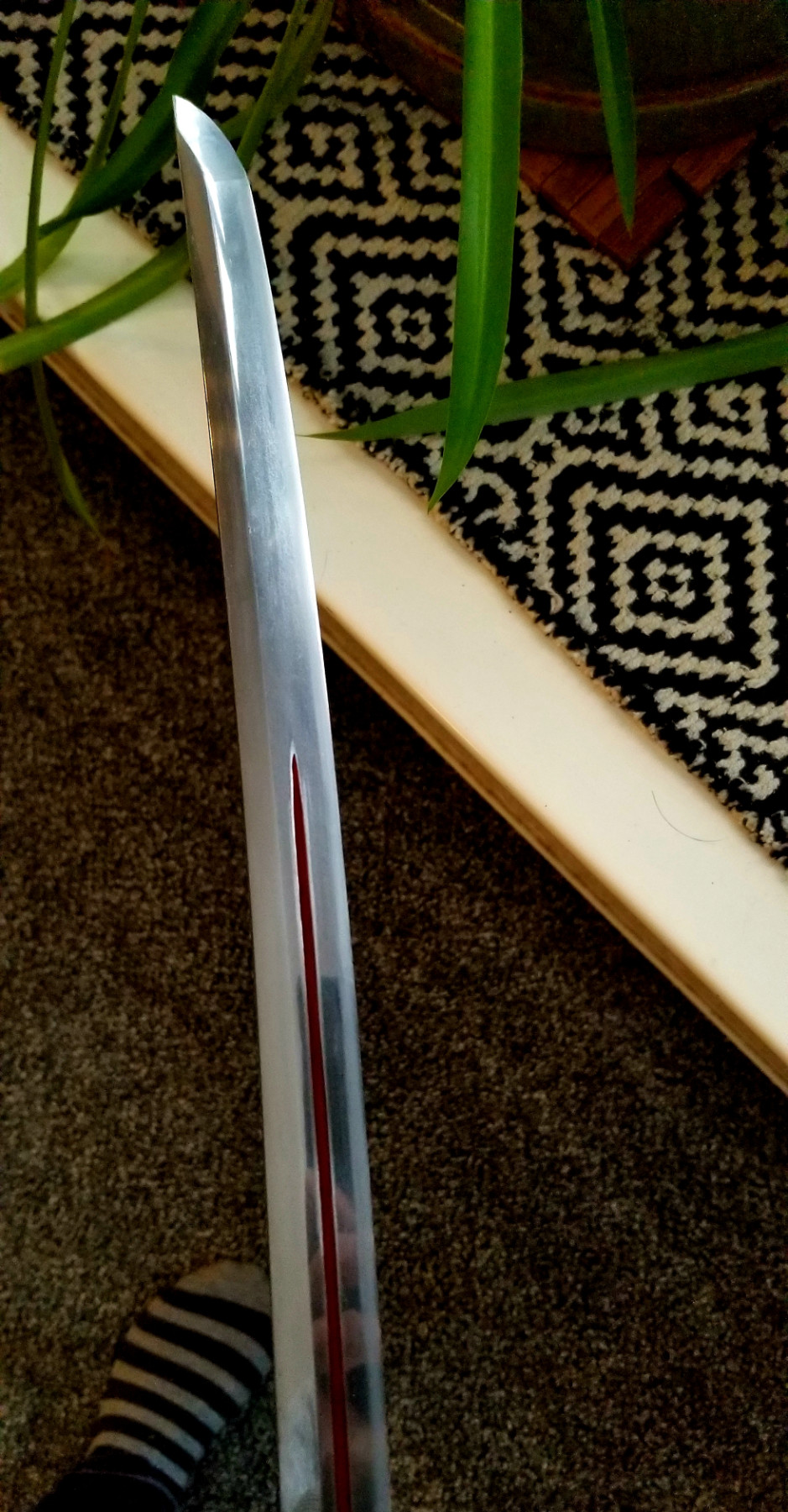

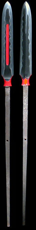

Here are the older ones I've found in my search:
Posted by Adam, @waljamada HERE.
Screenshot_20220104-142647_Gallery.thumb.jpg.f78c1433ff066abe4146e782d19e2dbd.jpg.5741bd39ee373ddd8bcbb8d06f62b694.jpgSmartSelect_20220104-142553_Gallery.thumb.jpg.3b81b6456bfdcc0a79f71185472739a9.jpg.5c5f5c360b3a76d457b5f7838eef33db.jpgSmartSelect_20220104-143321_Gallery.thumb.jpg.d66810578fad208bd0a281da8e778f26.jpg.72ede3ad269de15ceb797dbc0d05f6dc.jpg
Posted by Kirill, @Rivkin, HERE.
post-2253-0-93286100-1570161897_thumb.jpg.a97e72851a4db717478bb0948888f439.jpgpost-2253-0-83790700-1570161884_thumb.jpg.44fe7b7d804b9dfff263512053e36093.jpg
(reference link needed) IBB.Co
20200130-164032.jpg20200130-164142.thumb.jpg.0be03ece0b100ac9c5a5537a2614c162.jpg20200130-164322.thumb.jpg.8273f3cd42da7d61c176778310cdbcf3.jpg
By @Jock HERE.
post-391-1419677305177_thumb.jpg.cd167b9d7f8d7e24457eb8ffcbc65fde.jpgpost-391-14196773048817_thumb.jpg.b13698c3cb04b0a0d2f24959ebc02a6a.jpgpost-391-14196773050093_thumb.jpg.b332612976fd333897adf79d0c879de0.jpg

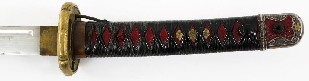

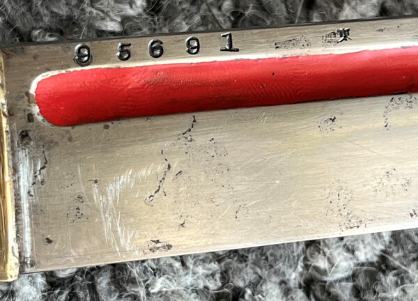

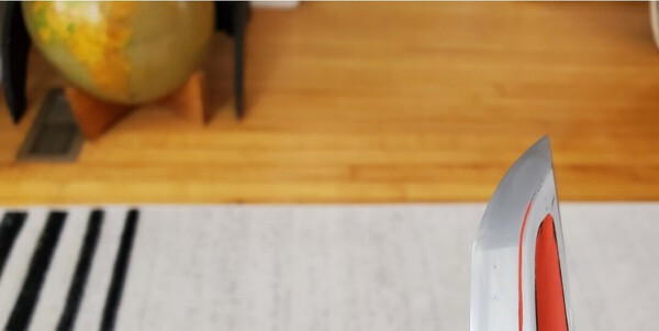

Now for the gunto.  The primo example that got me going is this one:
IMG_4153.thumb.jpg.0d216c6867e0bb271d86b93f286d85ae.jpgIMG_4148.thumb.jpg.23c72b597eea103deada5d65d188931e.jpg
42A104CA-C0CB-42BB-9843-12397B9CF72A.thumb.JPG.beb4937d015617cc1359a093933f2ab3.JPG0E63C1E6-4C77-48D6-977F-45F718F32501.thumb.JPG.05821a74b9f09a1e79abedf71f10bcfc.JPG
I have more photos, but this gunto deserves a thread of it's own, so I'll set that up later.

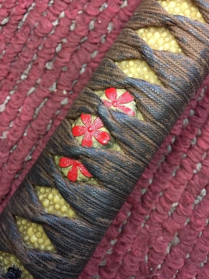

Posted by @lambo35 HERE.
DSC_0066.thumb.JPG.f4f900f77bb8c0ff74d26c38a09698fb.JPG.a06b1fc5b7f71de7c9ae316f18384ed2.JPG
Posted by @ribendao HERE.
img.thumb.jpg.993b4f3e4e7cf697c3aaae08fa16e329.jpgType95.thumb.jpg.dbab3f3517c86ea7b7211a4ac4b7be86.jpg.709b6b93ba64c7b440f9ab66cb4aa56d.jpg
Posted by Erich Jr (link  and avatar name needed)
image_4916518.thumb.jpg.8ed3a03a3cd36c3d12cc2a0047b93866.jpgimage_4917868.thumb.jpg.14849eca9849d3c42d3411ef9b9aa784.jpgimage_4917968.thumb.jpg.0965ec880c09e0039e12c5a6c68fca3e.jpgimage_4918625.thumb.jpg.e3c721a01c86836dfd660b165bd13bf6.jpg

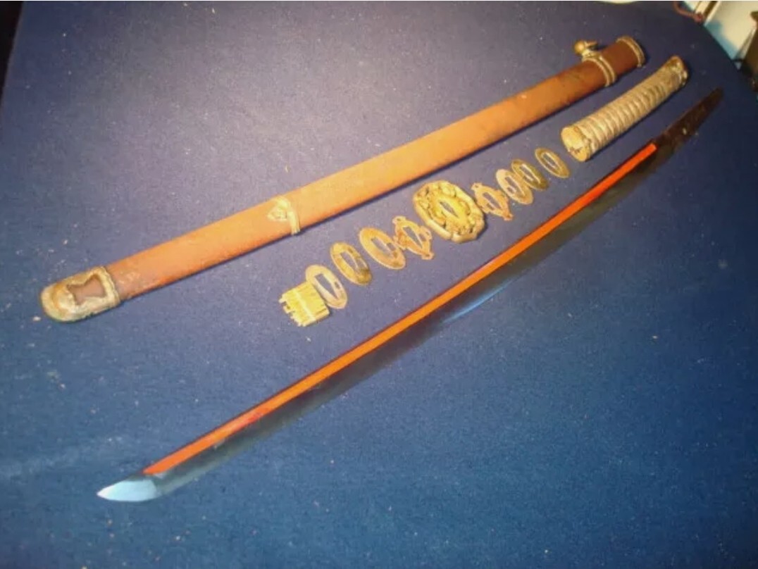

I know the instant replies will be "Obvious Bubba jobs!!!".  One thing that stands out to me, though, is that they all have the common theme of red & black.  So, how is it that multiple Bubbas all over the country (world maybe?) coordinated their paint jobs?  I don't buy it.  After seeing the first Type 95 in hand, taking it apart, and examining it.  I feel very strongly it was wartime paint.
If anyone has links to the missing ones above, I'd appreciate updates on them.  More examples are welcome!

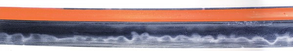

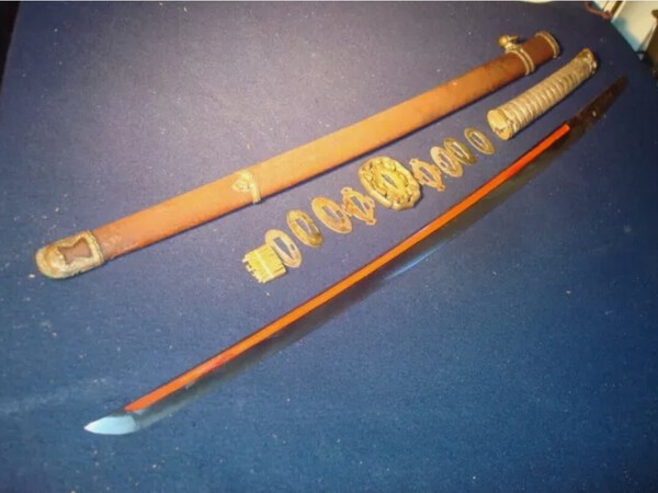

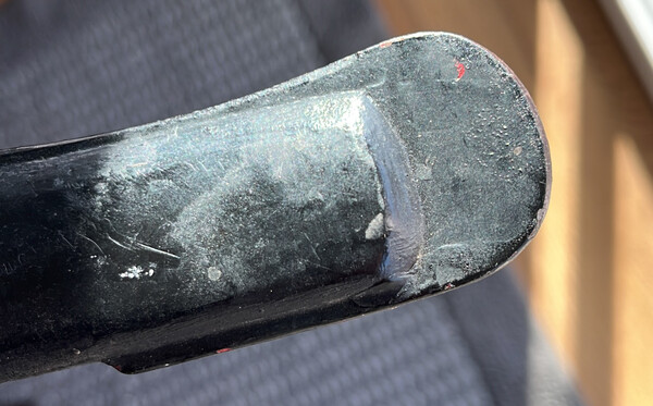

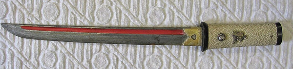

I think there is merit that some of the extra paint jobs were done by the Japanese during wartime. The Type 95 you cite makes a compelling case.
The trick, or complication, will be to define what rules separate the post-war Western treatment (aka Bubba job) from the war-era Japanese treatment. I would recommend not limiting your analysis to red urushi either. There are many other colors to consider - e.g. black painted Type 95's, bronzed Type 95's, etc. I've handled very many with different paint schemes. One of them was a Shodai Hisamichi katana in Type 98 mounts w/ family mon. The blade had been dipped in red paint(?) and was coated at the kissaki and monouchi, mimicking usage. Pretty sure that was not war-era Japanese treatment, even if it had a healthy dose of red.
Here's another I handled earlier this year. The orange was actually pretty well done. Bubba job?

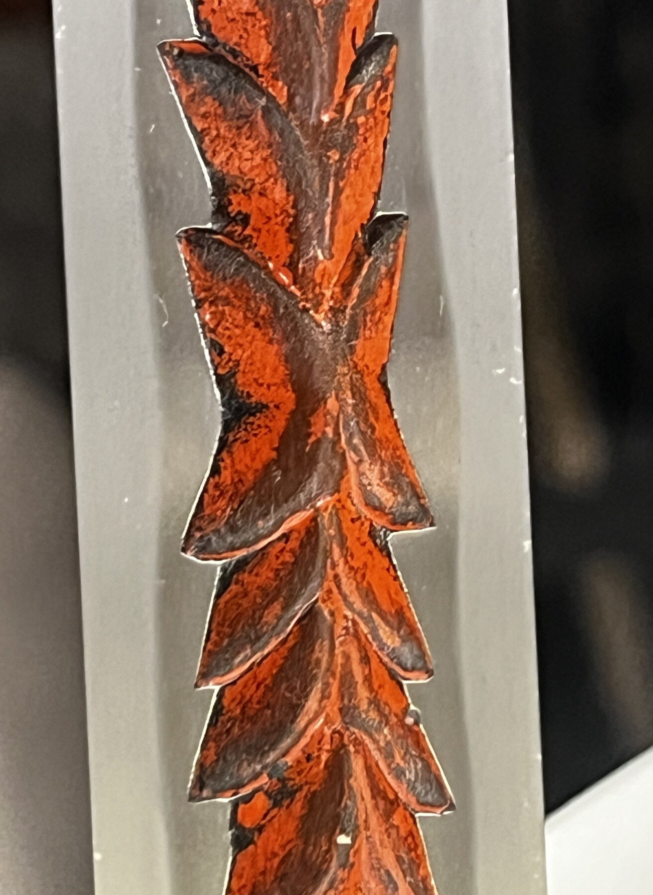

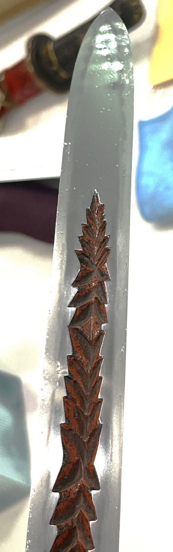

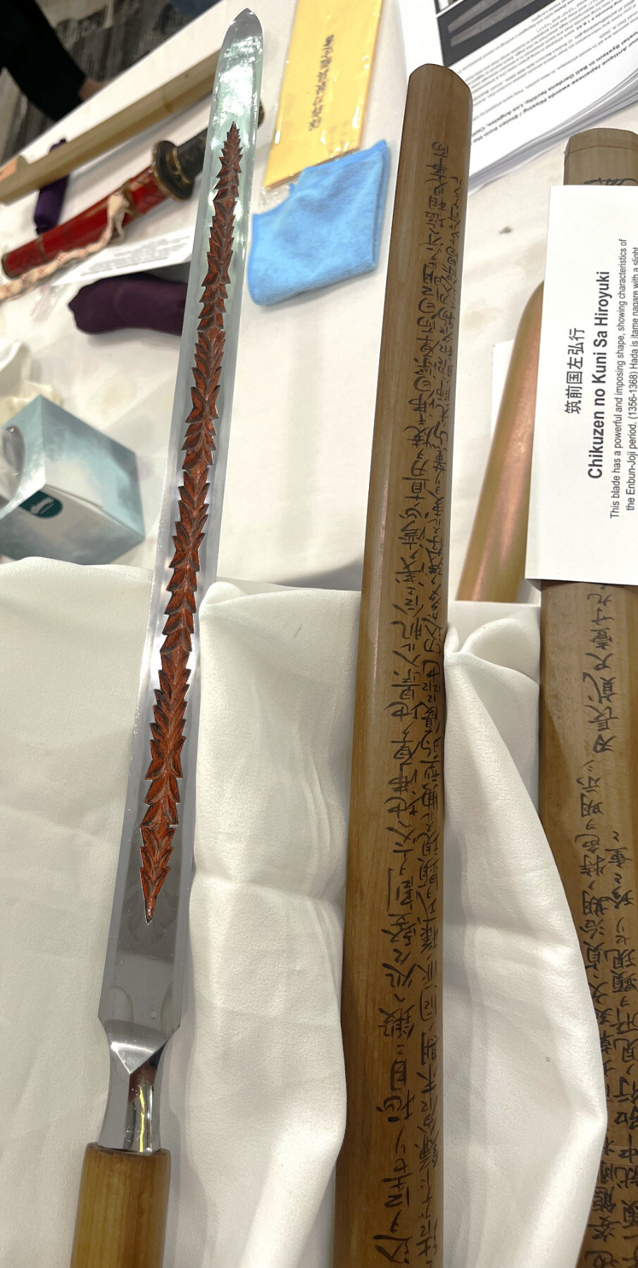

Darcy pointed out that could be a Yamato Senj'uin or Uda blade from the Kamakura era.

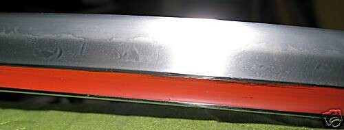

You see if the paint is made by a professional craftsman or DIY. The paint should be in straight strokes not daubed. The edges of the paint must be sharp without fringe or waves.

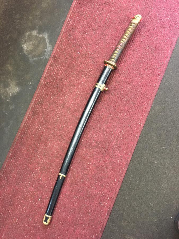

I'd like to see the saya on that Naginata "gunto"...
I am inclined to agree with Stephen.

Edit: I see now in the original post, that it came with NO saya. Strengthening Stephens theory, IMO.
