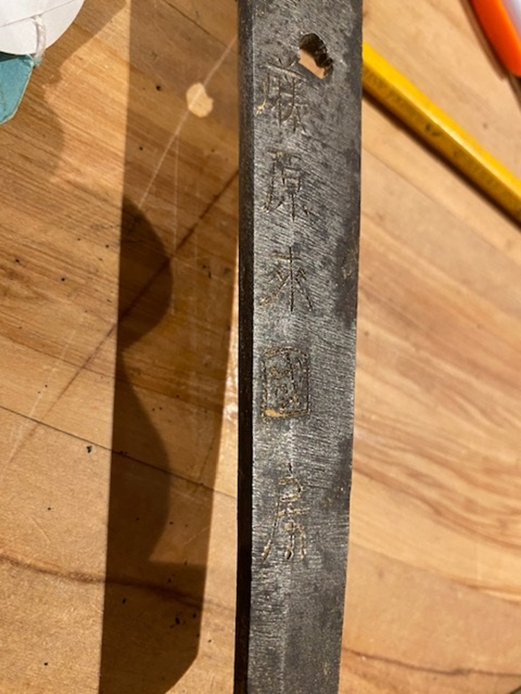

CLM Posted August 18, 2022 Author Report Posted August 18, 2022 Thanks Steve The sword is was described as a 1887 Pattern Kyu Gunto with old blade. It is an army sword. In my very limited experience it appears to a hand made blade. So I'm guessing it it no so very old but 1920's, 30's or early 40's made sword but traditionally made? Any luck with the other two? Quote

CLM Posted August 20, 2022 Author Report Posted August 20, 2022 ok, I'm attaching in a sequence of posts more pictures of the complete swords. First up is the three older blades, closest to further away, - Hizen-no-kuni Saga-ju Fujiwara Yoshihiro, -Bishu Osafune, - Fujiwara Rai Kunifusa Quote
