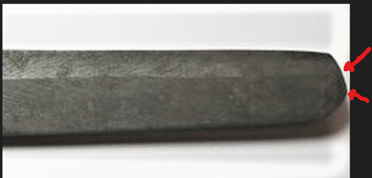

Took a closer look, and you're right!  A half-struck Seki stamp ...... but no mei.  What a strange one!
Another oddity - (and my technical lingo on this is weak) the curve of the nakago jiri is upside down from where it should be!  It should be inline with the shinogi:

I have circled the Seki 関 stamp on the picture below.   Only the left side of the stamp is still visible as this side of the nakago was sanitized for reasons unknown.  To see the stamp clearly, one needs to download the picture and then zoom in on the location.  FYI, I did not notice it until Brian & Bruce mentioned it.  This got me curious as to where it was at.
