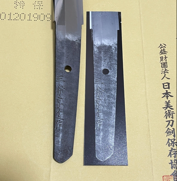

Ziyistudio Posted August 6, 2022 Report Posted August 6, 2022 I found this late Edo period sword on Ebay that is signed by Sanjo Munechika (三条宗近). I know Sanjo Munechika as a very famous smith from the Heian period, but couldn't find anything about this "late Edo Sanjo Munechika". I'm kind of confused and wonder if this sword is legit. Someone please educate me on this, would really appreciate any feedback. here is the Ebay link: https://www.ebay.com/itm/314058081007 Quote
Shugyosha Posted August 6, 2022 Report Posted August 6, 2022 Hi ZZ, The paper looks correct and there are references to a smith signing this way in the late Edo period on the internet. https://art.thewalters.org/detail/8128// Im away from my books so can’t be more precise. No doubt someone else will chip in. Quote
Alex A Posted August 6, 2022 Report Posted August 6, 2022 There was a late Edo Smith , according to Markus index p418 Bunka 1804 to 1818 Yamato Mikasa Sanroku Ju Sanjo Kokaji Munechika Quote
Alex A Posted August 6, 2022 Report Posted August 6, 2022 Just to add, very little on this smith, as is sometimes the case so not much comparisons. Id be wary. 1 Quote
Ziyistudio Posted August 6, 2022 Author Report Posted August 6, 2022 On 8/6/2022 at 7:05 AM, Shugyosha said: Hi ZZ, The paper looks correct and there are references to a smith signing this way in the late Edo period on the internet. https://art.thewalters.org/detail/8128// Im away from my books so can’t be more precise. No doubt someone else will chip in. Expand Thanx a lot, that's the same guy! The signiture calligraphy from ur reference does resemble the ebay one but those characters are etched slightly differently. I'm no expert though, I guess it's legit? But the ebay one was made before the smith was given permission to use the mon marking? Quote
Ziyistudio Posted August 6, 2022 Author Report Posted August 6, 2022 On 8/6/2022 at 9:20 AM, Alex A said: Just to add, very little on this smith, as is sometimes the case so not much comparisons. Id be wary. Expand You are right. The offer the seller gave was attractive though... I need to be calm lol. Do people generally shy away from smith with very little information? I'm a newbie newbie Quote
SteveM Posted August 6, 2022 Report Posted August 6, 2022 I wouldn't compare the signature on the wakizashi to the signature on the kogatana. They are two very different things. Kogatana are often signed as an homage to a famous smith, rather than signed by that smith's own hand. Its likely that the kogatana is meant to refer to the famous Sanjō Munechika, and not the one from Edo/Meiji. Regarding the wakizashi, it already has authentication papers by the NBTHK, so I don't think you have to worry about it being a fake. There are some other papered examples here https://www.e-sword.jp/katana/1410-1077.htm https://www.e-sword.jp/wakisashi/1910-2055.htm 2 1 Quote
Alex A Posted August 6, 2022 Report Posted August 6, 2022 Hi, better staying away from Ebay Check out the dealers listed here Just for comparison, look at other swords of similar price https://www.aoijapan.com/japaneseswords/wakizashi/ Places like Aoi will varify the papers are genuine Quote
Alex A Posted August 6, 2022 Report Posted August 6, 2022 On 8/6/2022 at 7:17 PM, Ziyistudio said: You are right. The offer the seller gave was attractive though... I need to be calm lol. Do people generally shy away from smith with very little information? I'm a newbie newbie Expand You will find blades by better smiths for the same money, smiths where you can find out lots of information. Ebay not a good place to shop when your a newbie. Plenty of posts about books on here, buy a few introductory books and read them before you spend any money. Cheers Quote
Ken-Hawaii Posted August 7, 2022 Report Posted August 7, 2022 Ziyi, the mei is the LAST thing to examine. The sugata is the first, & it tells us that this blade was late Shinto or early Shinshinto. It's signed tachi-mei, which is unusual. Yakidashi show the blade is ubu, but the ana sren't as smoothly cut as are most blades in that era. Good advice to stay away from eBay until you have lots more experience. 1 Quote
Alex A Posted August 7, 2022 Report Posted August 7, 2022 Il be honest, my niggle is how a relatively unknown smith from the late Edo period can obtain TH on what looks to be a pretty average blade. Hence why i would want confirmation from NBTHK before buying. Had a quick look at the Sho-shin site at the rankings yesterday and this particular smith i could not see there either Not enough info. Good to be cautious Quote
