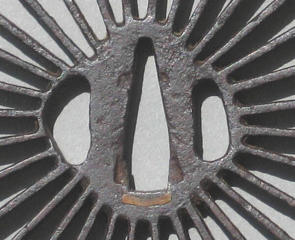

Also I wondered if it hadn't been lightly treated with wet and dry and then re-darkened. As the pics show there is a filler, a shim in the Nakago Ana which is unlike any other that I have seen being quite neatly positioned with a thin metal of some sort.

Hi Roger, are you sure there is a shim? It looks to me [thanks to the new lenses in my eyes] that there are long chisel marks (tagane) to tighten the fit around the nakago of the sword. But to be honest I don't know why a shim wouldn't have been better?  The guard looks good to me but you are probably correct that it has been re-patinated at some time [looks in great condition none the less.] :thumbsup:
Thanks for your response Dale- I feel reassured.
As for the so called 'shim', you are again quite correct. I put it to a couple of owners of much sharper eyes than mine and they agree with you- chiseled lines, tagane,  no shim.

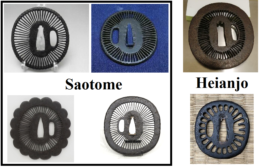

Roger there is a lot of overlap in the designs - some are Saotome, others Heianjo and no doubt numerous Shoami versions. How you can tell the school other than if they have inlays eludes me - it might take in-hand experience to say for sure. I found these examples in a few minutes of searching - I can only go on the descriptions given with each image, but bear in mind the people posting them may not be entirely accurate.  You are correct the 'front' face is called omote the rear ura. :thumbsup:
