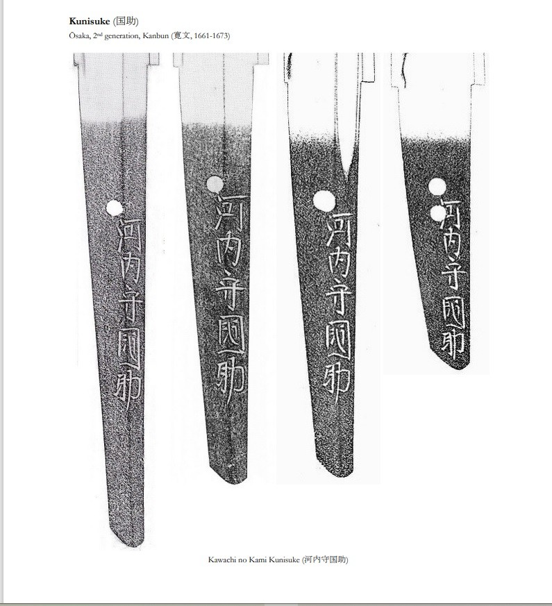

Jacques Posted July 28, 2022 Report Posted July 28, 2022 I'm somewhat disapointed but this sword seems gimei. Please, have a look at the kanji Kuni which is the same for all generations https://www.aoijapan.com/katanakawachi-kami-kunisuke-2nd-generation-naka-kawachi/ Quote

Brian Posted July 29, 2022 Report Posted July 29, 2022 8 hours ago, Bob Emery said: Is it a counterfiet; or made in the the period with a false signature? I would greatly appreciate any info. Regards Gimei (if it is gimei...not proven yet) is usually at the time of manufacture or a bit later in life. The sword remains real, old and genuine. It is only the signature that is spurious usually and there are many fine swords with gimei signatures. Quote
Jacques Posted July 29, 2022 Report Posted July 29, 2022 9 hours ago, Bob Emery said: Is it a counterfiet; or made in the the period with a false signature? I would greatly appreciate any info. Regards Impossible to say, it may have been made in all periods from the one of the living of the forged smith to ours. Many gimei were made just after the Haitorai and others called gendai gimei in 1934/35 because the sword became valuable as a collector's item and finally just after the war (1947/48). Brian, we just have to prove that this signature is good all the oshigata in my possession show that the Kuni kanji (and there is not only that) is not engraved as it is on the nakago in question Some samples from Markus's shinto meikan below 1 Quote
Bob Emery Posted July 29, 2022 Author Report Posted July 29, 2022 I apologize for making an error in reading Mr. Yumotos' notations in evaluating the sword. As to the signature he rates it bad, date: circa 1700 Shinto, made most likely by a smith of Osaka Shinto School. I hope I haven't caused any confusion. Quote
Jacques Posted July 29, 2022 Report Posted July 29, 2022 Here I am reassured, I could not imagine that John Yumoto could have made such a mistake. Quote
