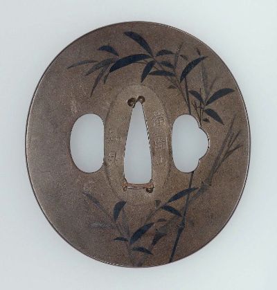

It seems to me that many of the late period 'Shinchu'/Brass' tsuba have this look. The masters, can make the patina look the way they want it to. And being kinda soft they likely ding up very easy, giving the plate a used look.
My favorite is this one. It's like your looking through the morning mist. This one is shibuichi, but you can see how the area outside the seppa area ages.

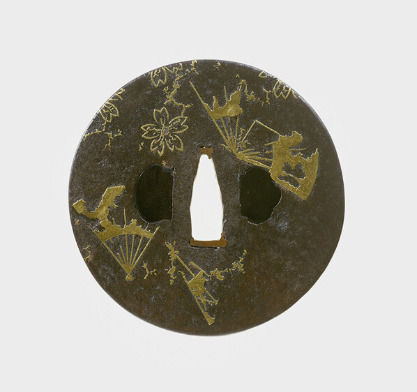

Matashichi's brocken fans tsuba relies on the design to evoke an aged look or do you mean he meant to suggest the fans actually had worn away on the tsuba?
I think MATASHICHI's famous tsuba is a "multi-layered"-approach to the concept of wabi/sabi. First it is expressed by the subject of broken fans, which is part of a "worn-brocade"-design; assembled on a surface, which is modelled after weathered stones and the whole thing is meant to look like after a long time of wear. It is a picture-puzzle.
