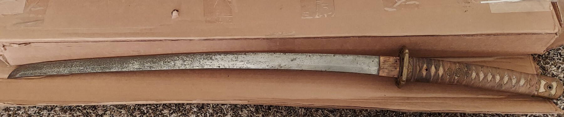

Browningguy Posted July 13, 2022 Report Posted July 13, 2022 Hello. I'm a military collector and finally got a wwii sword. The blade is in very poor shape and I would like an opinion on how to stabilize it or if I should just let it be. I know, Don't touch the tang, I'm not going to polish it. It's probably too far gone but still neat to me. I think those sword sat in its scabbard for a long time, a wet scabbard at that. When I turn the scabbard upside down little bits of what looks like wood falls out. Anyway, should I wipe the blade down with something to clean it then oil the blade? I came to this forum for expert advice not the Bubba Gump special. Thank you in advance. Quote
ChrisW Posted July 13, 2022 Report Posted July 13, 2022 To begin, if the scabbard (saya) is the source of the issue, I would not store it in its saya anymore (if you got one with the blade), but keep it together with it obviously. You can fashion a paper saya out of any non-acidic paper. To arrest the rust, you must first clean it: I'd start with a mild soap and water to remove the wood bits and any possible resins/old oil and then hand dry with a soft towel. Then you can use a high purity isopropyl alcohol (electronics grade is fine) and tissue paper to wipe it clean, which will remove any of the loose surface rust. Finally, use either a choji oil (available from several vendors of nihonto) or camellia oil, or any good quality mineral or non-abrasive oil. A light coating will do. Then store in a cool, dry place out of direct sunlight in its paper saya. Avoid anything abrasive. If you suspect the blade may be traditionally made, then it could possibly warrant a look at by a togishi for polishing if you so desire; if not, enjoy it as is! Welcome to the world of nihonto/related militaria! Edit: Also, I am sure everyone here would love to see the nakago (tang). If you feel comfortable gently knocking the mekugi-pin out, folks here could provide further insight on if it is traditional or machine made/age of the blade itself. Quote
Grey Doffin Posted July 13, 2022 Report Posted July 13, 2022 I don't think the scabbard is the problem and I see no reason why the blade can't be stored inside it (that's why you purchased the sword, right? So you can display it as a unit). I would make sure the inside of the scabbard is dry. Not likely it isn't but best to make sure. Leave the sword out of it for a few dry days; maybe place the scabbard in direct sunlight so it heats up to hasten drying. In the mean time, clean any loose rust particles from the blade with a cloth rag and apply a very light coat of machine oil (sewing machine or the other oils mentioned above) to the exposed blade (not the nakago). You can then put the sword back in its scabbard and no further damage should occur. You should remove the handle to make sure there is no active red rust on the nakago; let us know if there is and further advice will follow. If the scabbard is metal with a wood liner, it may be possible to remove and clean the liner. Let us know what type scabbard you have. Grey 1 Quote
Bruce Pennington Posted July 13, 2022 Report Posted July 13, 2022 I agree with both Dave and Chris. You are in Wyoming, so likely fairly dry climate which is good to prevent future rust. If you got the sword from somewhere else, recently, simply leave the blade out of the saya (scabbard) for a few days to let the saya air out and dry, if still wet. Sometimes you can remove the saya throat piece and the wooden liners will slide out, for better drying, but they don't always come out. Plus, if yours has pieces falling out, the liners may not be in one piece anymore. I would also appreciate seeing the nakago (tang). It's easy to remove the handle. Sometimes the rust can make it feel stuck, even with the bamboo peg removed, but you can always wiggle the tsuka (handguard), or tap it with a rubber mallet, if stuck, and everything will slide off. Quote

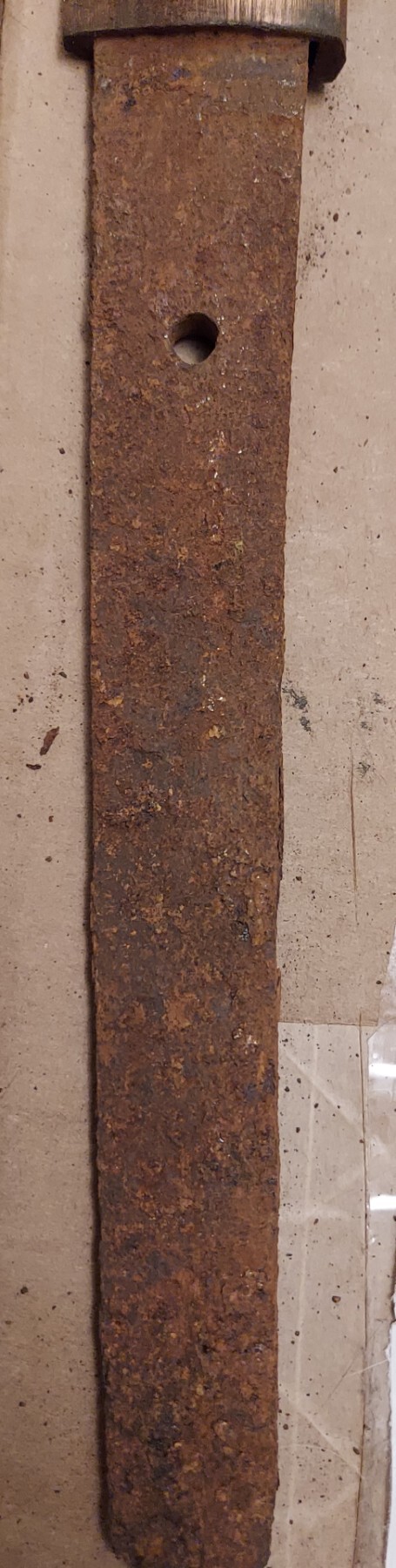

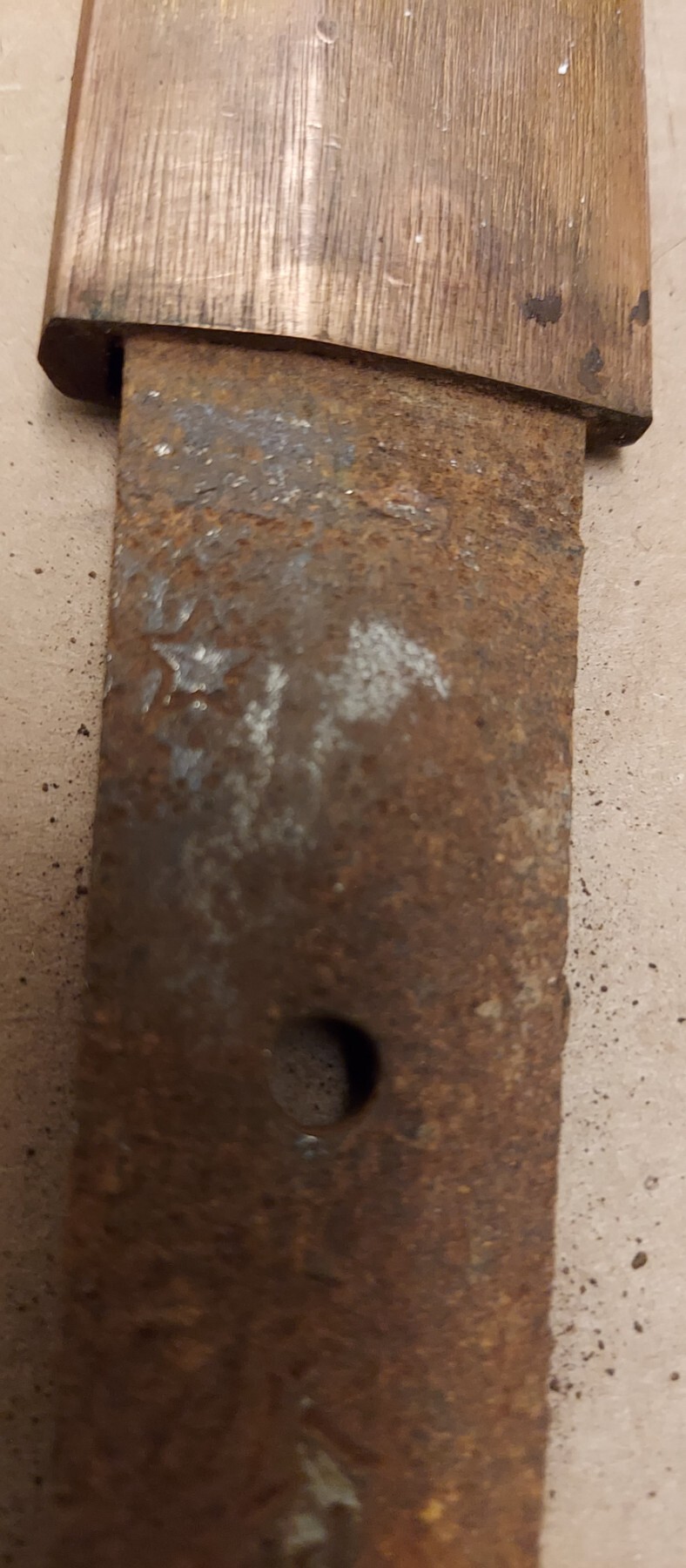

Browningguy Posted July 16, 2022 Author Report Posted July 16, 2022 Finally got it. Lots of rust. Quote

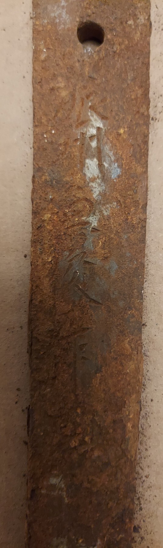

SteveM Posted July 16, 2022 Report Posted July 16, 2022 濃州兼俊作 Made by Kanetoshi of Nōshū province. 4 Quote
Browningguy Posted July 16, 2022 Author Report Posted July 16, 2022 Rikugun Jumei Tosho swordsmith? Quote
SteveM Posted July 16, 2022 Report Posted July 16, 2022 Yes - possibly Murayama Kanetoshi. See this thread (and others) for more examples of Murayama Kanetoshi http://www.japaneseswordindex.com/gendai2.htm Quote
ChrisW Posted July 16, 2022 Report Posted July 16, 2022 Congrats! That star stamp on the nakago means it is a traditionally made-blade and may very well be worth having restored by a trained togishi! I would see if maybe Bob Benson could give his opinion on it. Quote
Bruce Pennington Posted July 16, 2022 Report Posted July 16, 2022 I have 3 star-stamped Kanetoshi blades on file, one from 1943, and 2 from 1944; both in RS fittings. Don't know what year he got RJT qualified, so yours could be as early as 1942, though. Love to see this polished! If you're not going to polish, I had some success using a deer antler and a mineral oil - lindseed oil mix, removing active rust. You can get cut antlers at pet shops. Has a good edge for scraping at the rust. Quote

Nihontocollector752 Posted July 17, 2022 Report Posted July 17, 2022 RJT blades paper at NBTHK Hozon, well worth having this professionally restored as long as there is no deep pitting. Please don't use chemicals to clean it. Congratulations on this blade, save the nakago too. Quote
Bruce Pennington Posted July 17, 2022 Report Posted July 17, 2022 Yes, I should clarify - I was talking about using the antler on the nakago to remove the active rust. Don't use it on the blade! Quote

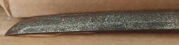

Browningguy Posted July 17, 2022 Author Report Posted July 17, 2022 Thanks Bruce! It does have some pitting and nicks in the blade so not sure it worthy of restoration. Also the blade is slightly bent. Quote
ChrisW Posted July 18, 2022 Report Posted July 18, 2022 A bend is easily correctable by a trained togishi. And you'd be surprised what level of pitting is able to come out after some careful work. You shouldn't be discouraged and call up a togishi! Quote
