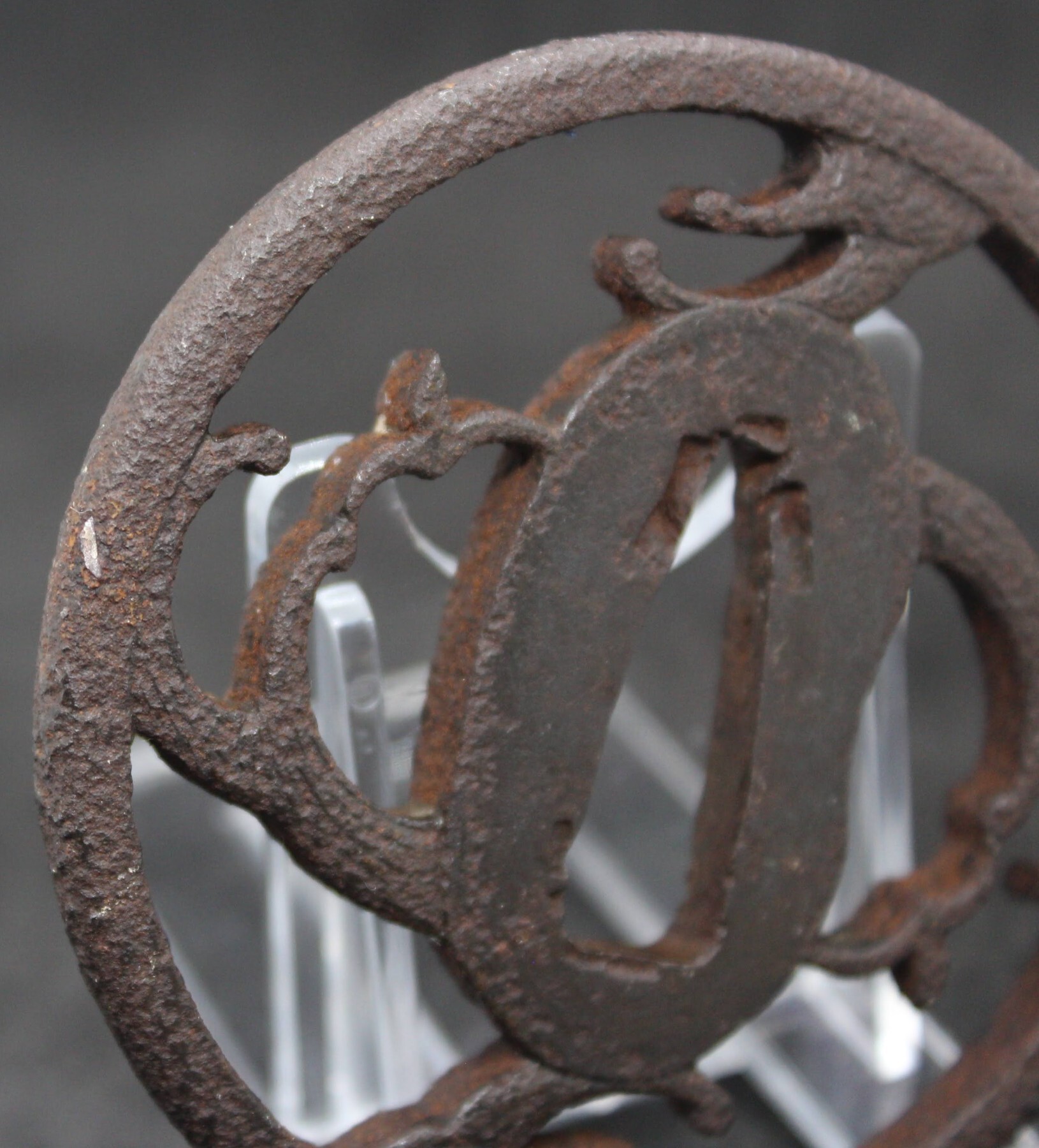

A bit rough but someone has loved it!
cdrcm12
Hi,
A recent purchase from a UK auction house, along with another tsuba which I may post later. Unfortunately it's a bit corroded except for the seppa dai but I liked the design of waves and Chidori and thought I would 'save' it (didn't pay a lot for both). As for school I'm not too sure, Kyo-Shoami possibly, any help here welcome, I'm sure I've seen this design before? You can still see some of the carving on the waves, in the right light.
What's also interesting, as a result of the pitting is what I think is a tekkotsu that has been exposed on the mimi, at 9 o'clock on the second image below and about the same position in the third, is this correct?
Dimensions:
Height: 72.5mm
Width: 72.5mm
Mimi thk: 5.5mm
Seppa dai thk: 5.95mm
Nakago ana: 29mm x 9mm
As the title of this thread says it's been loved by someone over the years given the number of tagane-ato on the front and back, indicating re-mounting several times.
Many thanks for any insight, I'll keep working on the TLC!
Colin,
indeed a pleasing design!
What you see as TEKKOTSU is probably something different. TEKKOTSU are small lumps of iron in an inhomogeneous TSUBA steel plate, so this could be something like a broken piece of a stainless blade that cut into the MIMI.
Just guessing, more microscopic photos might reveal another cause.
Hi Jean,
Thanks for the quick response, you are absolutely correct about the tekkotsu, my thought was the corrosion had exposed some form of crystaline structure within the lump but I like your theory of a piece of blade stuck in the mimi from a blow! I'll try get some closer shots of the item, but it does actually look like it would fit the shape of the dings you see in blades.
Colin,
this was a lovely SUKASHI TSUBA and I would really like to see improvements with your treatment! But I have to confess that in my opinion, corrosion has eaten away some of the iron, so I am not too optimistic that you will achieve a much better surface!
Colin,
I think it is a late (possibly 19th century) TSUBA, and in these times styles and schools are difficult to separate from each other. A rounded MIMI, but not looking like true AKASAKA, a WAVE design perhaps inspired by YAGYU,  a bit of a symmetry like OWARI - others may see some KYO SHOAMI traits.
Difficult fo me to pin it down.
For what it's worth this is what I see...
Despite apparent serious surface corrosion there is the evidence of laminar structure that would inevitably be present in hand wrought pre-industrial steel/iron. This sugests that the tsuba is made from an homogeneous plate of material, my intuition suggests mild steel.
The second point, already implied by my first observation, it that the very evident pock-marked corrosion surface is absent from the inner walls of the sukashi. We also see still crisp edges around the seppa-dai and, for me, unconvincing tapering out of the texture in to the seppa-dai itself.
The kozuka atari is a bit too curved too to be a reasonable fit alongside a kozuka back suggesting a lack of awareness of its realy practical function and meaning.
My feeling is that this is a modern-ish hobby piece worked up to look older than it really is.

I'd have to disagree with your suggestion that this is a rusted, not a corroded, piece of material. Corrosion in fact covers the damage caused by rust, and that's really what we're looking at here.
It is perfectly correct to speak technically about a corroded steel structure and to distinguish it from a merely rusted one. Structures made from Corten steel, for example, rely on the formation of a rust coating to protect it from further rust penetration that would lead to corrosion and mechanical failure.
Perhaps a simple and more familiar example might clarify; the patina we admire on ferrous tsuba are composed of rust, albeit in a fine and stable state. Once that stable rust patina is disrupted and 'goes live' it is actively rusting, and causing corrosion, ie; the degradation and breakdown of the metal's surface and eventually structure.
As for the time it might take for a surface of steel or iron to exhibit the sort of texture this example shows that would depend entirely on the conditions it was kept in or subjected to. It's perfectly simple to recreate this degree of 'apparent' corrosion in a few months. Quicker if you were to use a little bit of electrical current to speed things up a bit.
And for anyone who really wants to go down the rabbit hole of pre-industrial ferrous metal structure and the effects of time and corrosion etc. these four books are the most frequently thumbed on the subject in my library. There's about 1300 pages of solid material in there.
