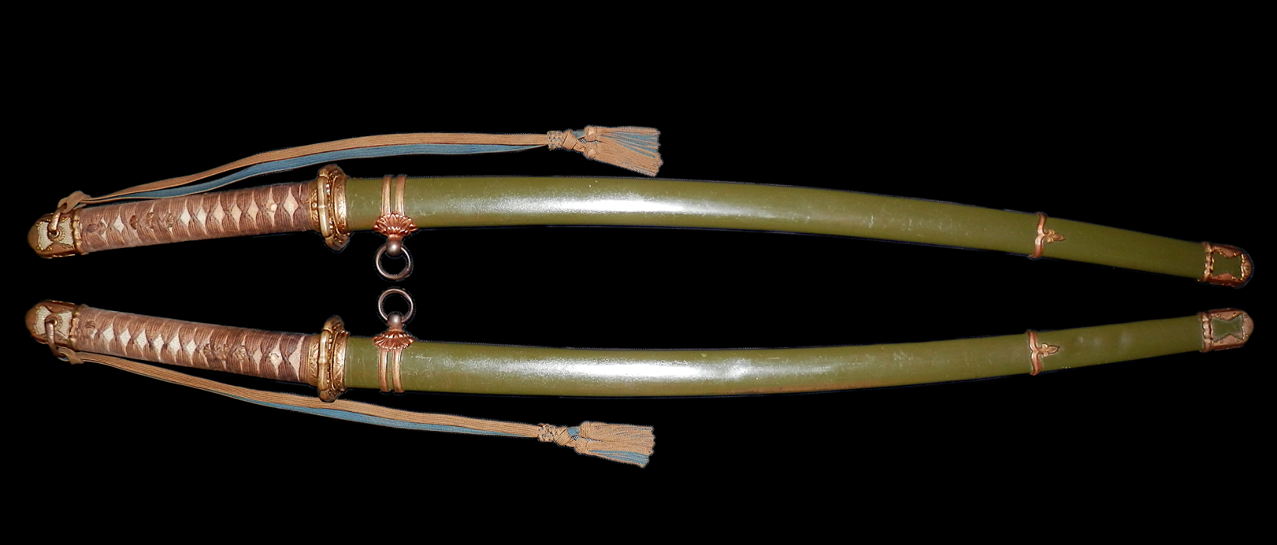

Ohmura's "Military Swords of Imperial Japan" has an example of a Bluish Green type 98 Gunto saya among several of the more common colors.
My questions is, out of all the years I've followed the NMB, I can't recall seeing even one of the Green Saya's.
Was this color saya more of an anomaly, or was it simply a color rarely chosen ???
Does anyone have one of these green colored saya's? I would think that if anyone had an example, it would be Neil (IJASWORDS) from Australia.
Thanks in advance.
Dave M.

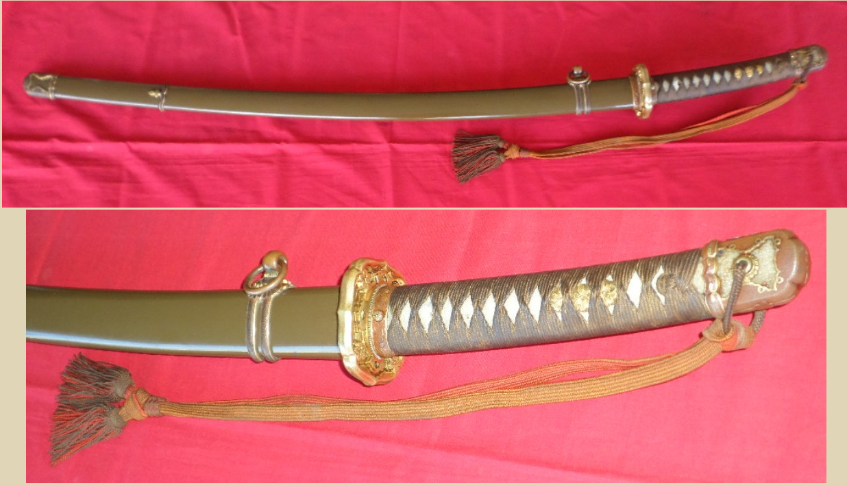

No problem Peter, all input appreciated, it's becoming apparent to me there are even a few slight variations in what could be considered traditional  "Gunto green" as John and Gareth have shown.
After looking closer at Victor's Mantetsu saya, which Bruce shared, it appears to be a greenish paint possibly applied post war.
Again, all input is greatly appreciated, however, yours appears to be the closest to the "Bluish Green" saya color variation displayed in Ohmura's Gunto Site, however, I'm not sure we've quite got a match yet.
I'm beginning to suspect that very specific Bluish Green saya color variation is extemely rare, if not produced in any number at all, an anomaly indeed.
Perhaps one will eventually show up!
Thank you all for the effort,
Dave M.

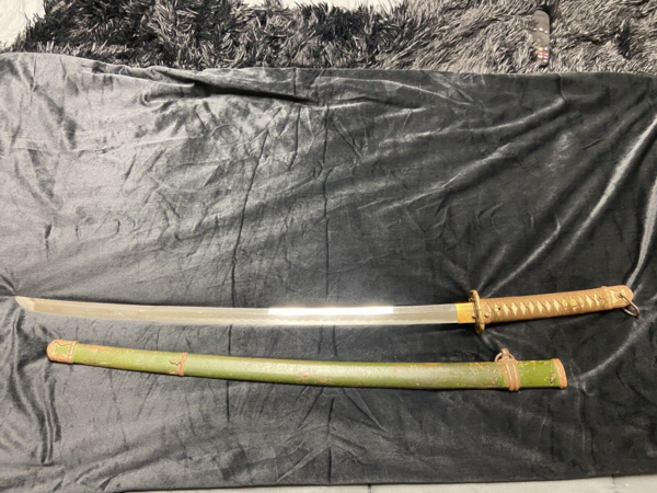

Very rare green saya color variation. Appears WWll era. Close to the color shown on Ohmura's Gunto site. Sword is for sale on Ebay presently.
Dave M.
