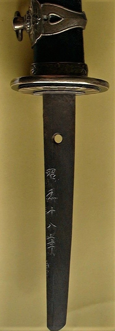

Hi guys this kaigunto has come up for sale on a local auction,i have no interest in buying it but would like
to know if i have translated the mei correctly i get Kanetatsu  and the date Showa 1943 thanks in advance
for your help.

2 hours ago, Shugyosha said:
Hi Chris,
Looks like Kanetatsu to me: 兼達
You have the year correct.

Hi Alban,
As regards swords, it’s (normally) not so important to be pinpoint accurate with transposing the date into the western calendar. In this case the Showa era is calculated from 1926, so add on 18 and subtract 1 as the era always begins in the first listed year and it’s 1943. I didn’t look any deeper than that.

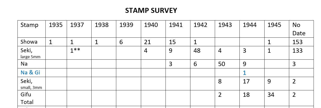

Just got back from a trip and had a chance to file this in the Stamp Survey.  It is only the 4th large Seki stamped blade I have in 1943, compared to 48 blades with it in 1942.  The use of the large Seki stamp was rapidly tapering off starting '43.  So, in my world, you've got a fairly rare blade there!  It is also my first Seki-stamped Kanetatsu.  I have one Showa (no date) stamped by him from Slough's book.  So in that regard, it is rare also.
