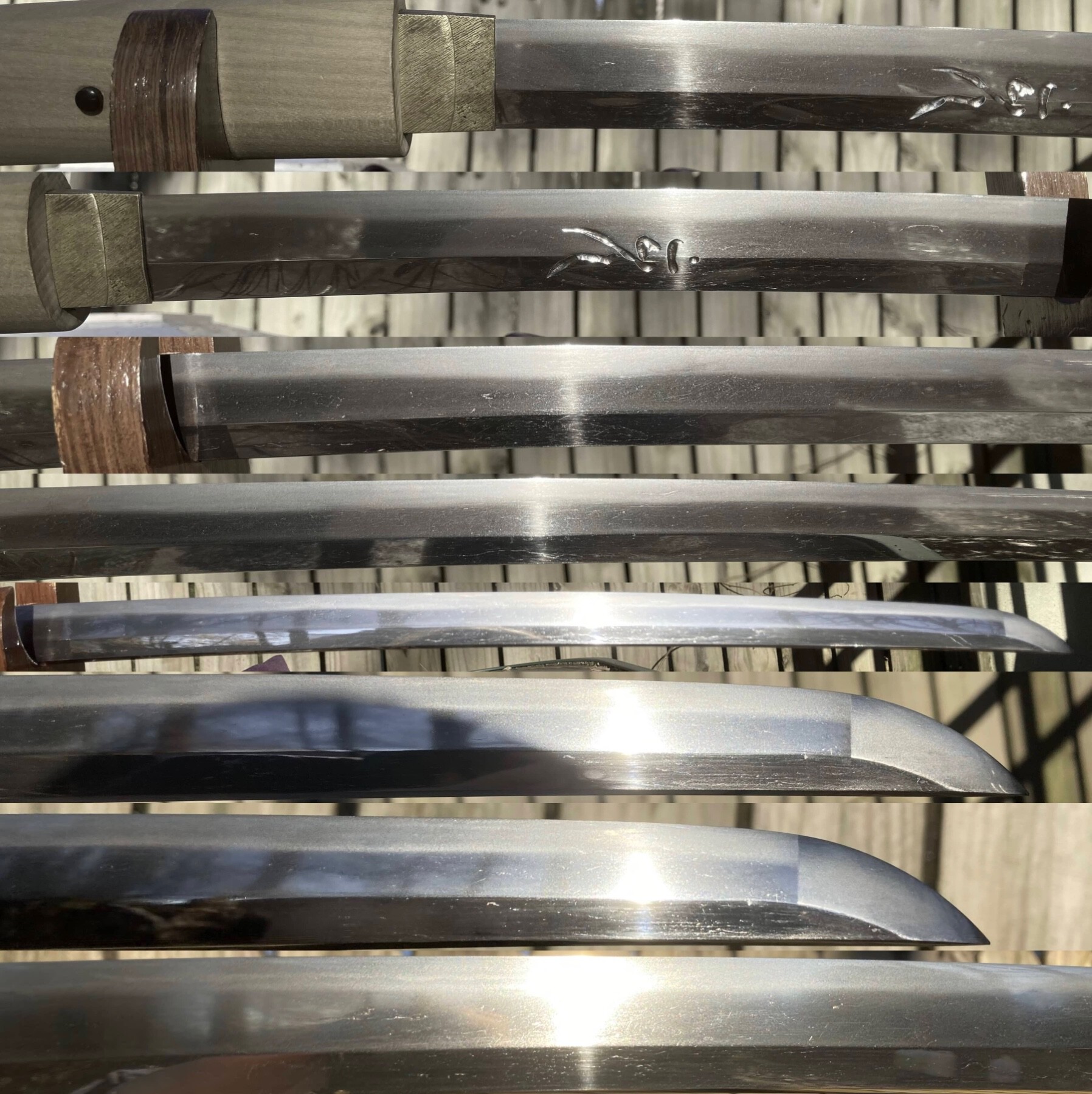

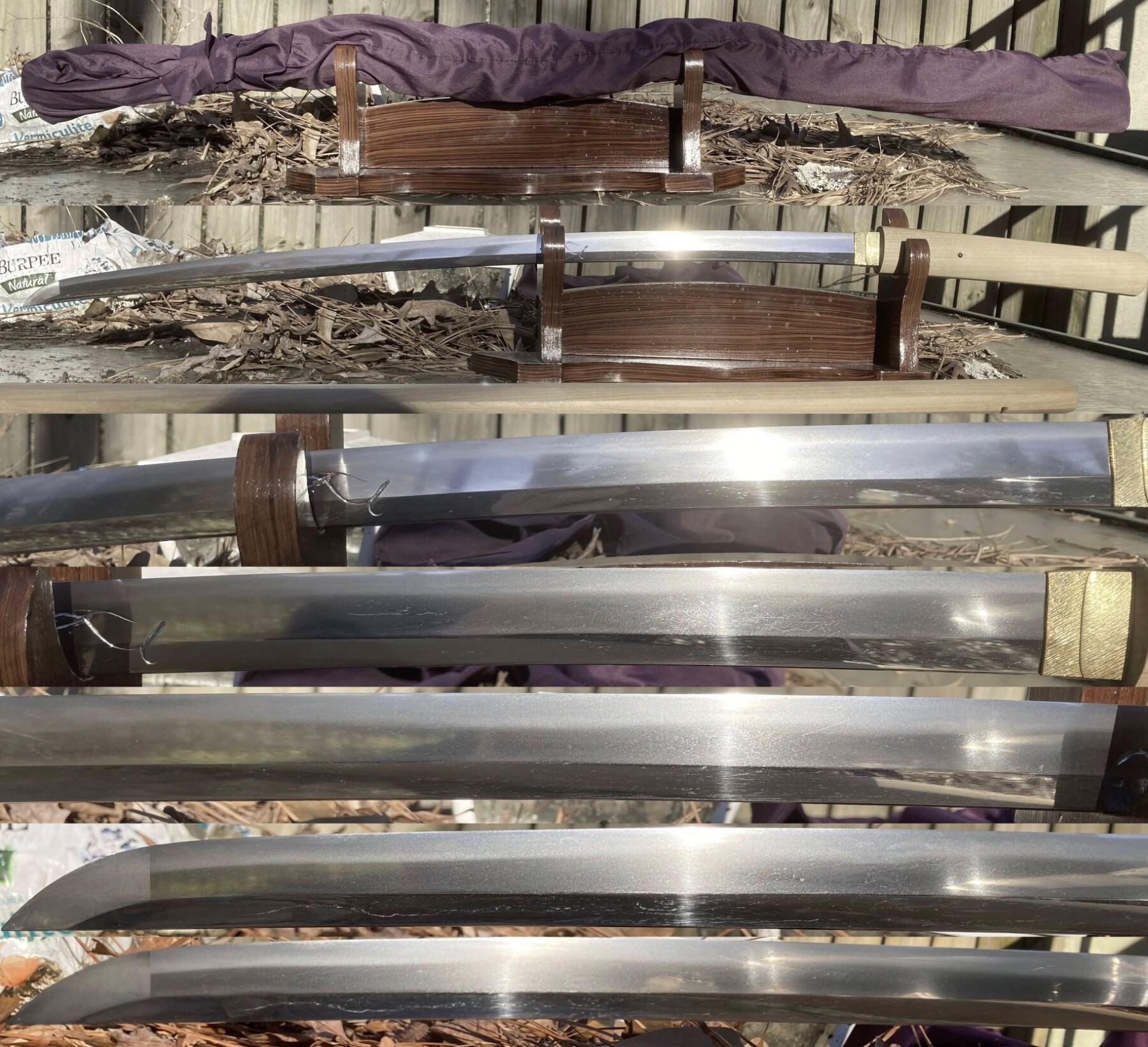

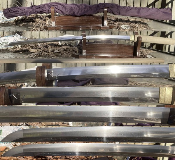

AntiquarianCat Posted July 10, 2022 Report Posted July 10, 2022 I hope you, and everyone else will excuse the question, but this is honestly the most relevant thread I’ve seen in years and didn’t want to gum up the forum with another “will this pass”. I’m planning to go to the shinsa and can only take a handful of swords I feel it’s important to decide on what’s worth the trouble of bringing. Would those with experience know if this sword stands any chance of getting Shinteisho? Its the sword some bubba carved but it’s otherwise in a decent old polish state, and fairly healthy. And I have a soft spot for it since it was my first longsword. Robert Benson said it was Bizen muromachi, probably pre sengoku. If it was once something nice would a shinsa tolerate the carvings, or am I better off submitting a different sword? I’ve seen ferric chloride damaged swords and other compromised swords get Shinteisho but I don’t know if a horrible bonji is a bridge too far. Quote
Shugyosha Posted July 10, 2022 Report Posted July 10, 2022 Hi Juan, I don't think that the carving will cause it to fail shinsa. Swords pass all the time with ato hori of varying degrees of quality, so I'd submit it unless you have a better candidate given what Mr Benson has said about its age. 2 Quote
Paz Posted July 10, 2022 Author Report Posted July 10, 2022 @AntiquarianCat Hi Juan I've got nanbokucho with tokubetsu hozon which has a carving , two. However I beleive these to be genuine of that time due one showing some ageing. Otherwise that you have their is fantastic looking blade which I would definitely take to shinsa 2 Quote
Toryu2020 Posted July 11, 2022 Report Posted July 11, 2022 Juan - The NTHK would not fail a sword based on a poor horimono (ato-bori, dremel work, bubba cut) - however this can be an indication of issues with the sword so the overall condition needs to be considered. If that is the only "flaw" then the sword has a good chance. If anyone is coming to the San Francisco Show and considering a shinsa submission, you can come see me personally and we are happy to check the condition of your blade ahead of time - if it is in the proper state for an examination we will tell you and if it obviously is not we will tell you and this will cost you nothing. -tch 3 1 Quote
