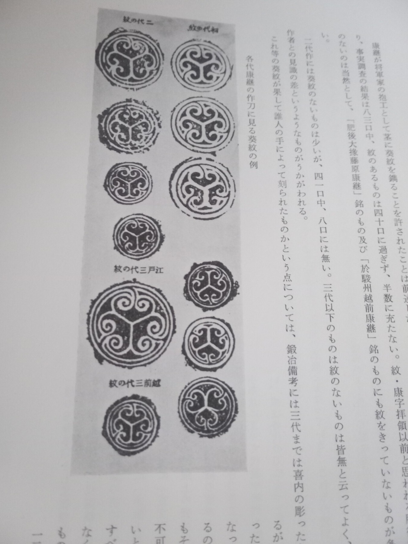

Hum guys, if you don't know which generation it is, you can't tell if it's a gimei, each generation of Yasutsugu has its own paricularities whether it's for the mei, the kamon and even the yasurime.
Kamon on the attached image (from Yasutsugu taikan)
