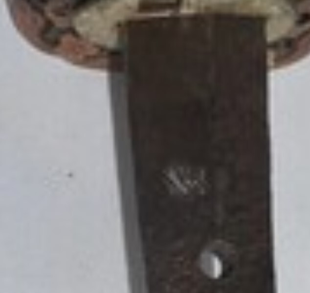

Bruce Pennington Posted July 6, 2022 Report Posted July 6, 2022 Yes, the fittings are Type 98. Can't see the tassel clearly enough to know for sure, but looks like a blue/brown of a company grade officer. If you pick it up, please post better pics. Looks like a large "W" stamped on the nakago? 1 Quote
robinalexander Posted July 7, 2022 Report Posted July 7, 2022 On 7/6/2022 at 12:30 PM, Bruce Pennington said: Looks like a large "W" stamped on the nakago? Expand Bruce have looked and looked and cant see it....can you point it out in some way? Pierced Tsuba = nice. I believe this has an earlier aluminium saya. From the first pic of the nakago (5 of 5) the mekugi ana seems to be quite clean however the rust has ravaged the edges of the nakago quite badly to the point of it being quite misshapen. I find that interesting. Is it mumei or has the rust just taken its toll on any mei? My guess is mumei. finally, does anyone know why the ashi is mounted so high? Certainly a piece of WW2 history. Rob Quote
Johnbull Posted July 7, 2022 Author Report Posted July 7, 2022 Hi Bruce, thanks for the input. Could you point out the "W" please. Also noticed this on the saya but could be nothing. Quote
Bruce Pennington Posted July 7, 2022 Report Posted July 7, 2022 Here it is John. Might be just scratches and due to out-of-focus, looks like a 'W' Quote
robinalexander Posted July 7, 2022 Report Posted July 7, 2022 Thanks Bruce, I'm putting my money on scratches though. Quote
